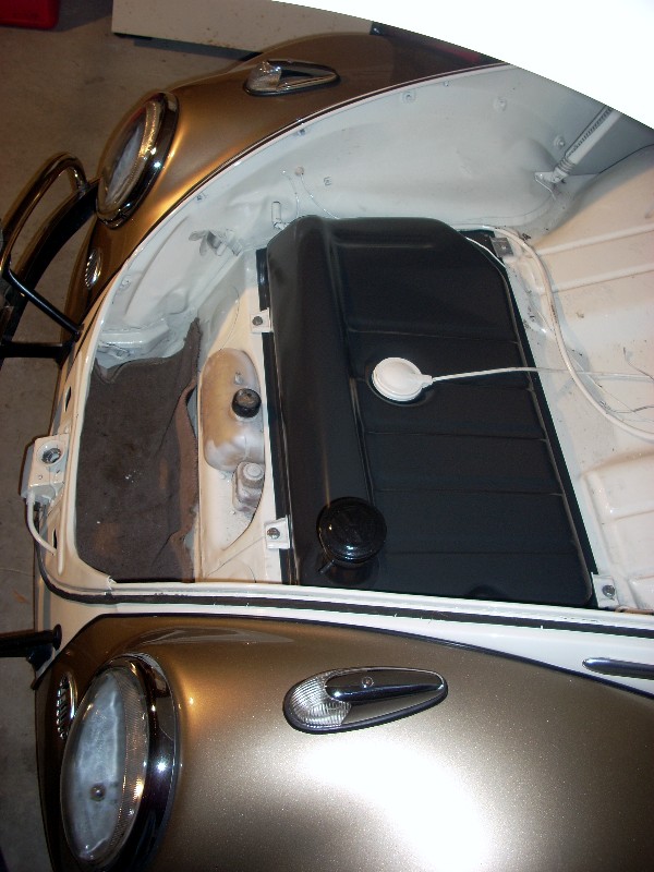

I put in the new gas tank from WW - no drama and excellent quality. I had to put in a new electric fuel pump because fuel filter stripped and won't come off - tested the old pump and it was barely pushing fuel. New unit works fine.

File comment: New tank looks purdy.

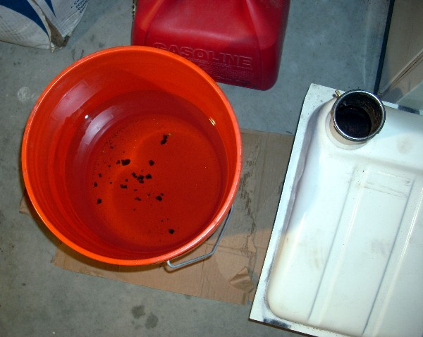

File comment: Gas from old tank - 89 octane rust chunks.

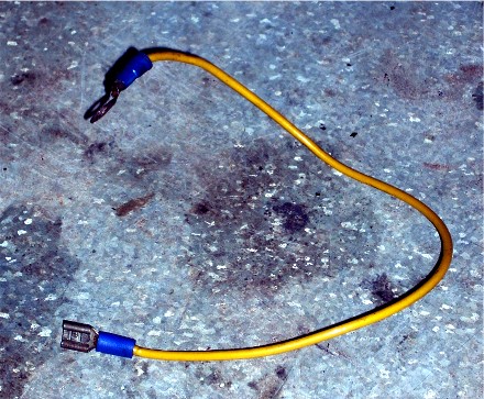

The BUG LIVES. It was a bad wire and my own dumb-ass stupidity. :roll:
Turns out I had run one too many ground wires. I put the yellow ground wire (pictured below) in the same configuration as when it was the ground for the old Bosch coil (one end on neg coil and the other ended grounded to the dizzy by way of the points arm/breaker plate).
A gearhead friend came over and figured it out in 5 minutes. Sure enough the wire was acting as a "kill" because there was already a ground wire running from the Pertronix electronic ignition module to the coil. I'm a dumb-shit.
When we pulled the "second" ground off the Bug we had spark. However, the Bug didn't want to stay lit - had to change the timing around 20 deg. Timing light said something was off since it wouldn't go past 10 deg advance no matter the revs.
So .. dumb shit move number two. I somehow jamed up the weight inside the dizzy when I was pushing the breaker plate back on after cleaning it. It magically advanced once the weight was unstuck from my ham-fisted work. It was set at 32 deg totally timing.
Drove the Bug in a drizzle. I still have an occasional spit (I won't call it a full "miss") at a steady 2,000 rpm. It occured twice in our drive, but the Bug ran well - good get up and go.
I don't think it's electronics or fuel delivery issue. Perhaps a valve occasionally not seating fully? Might pull plugs and do a compression check. However, I don't expect big difference between cylinders. Of course, it took me a week to figure the ground wires issue - so what do I know :oops:
