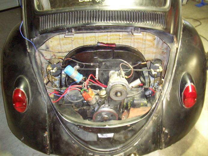

Well i got the car running today. I still have some wiring to sort out and need to bolt on the drivers side fenders. Its slowly coming together. I also got rid of the whitewalls so here come the 5 spokes.

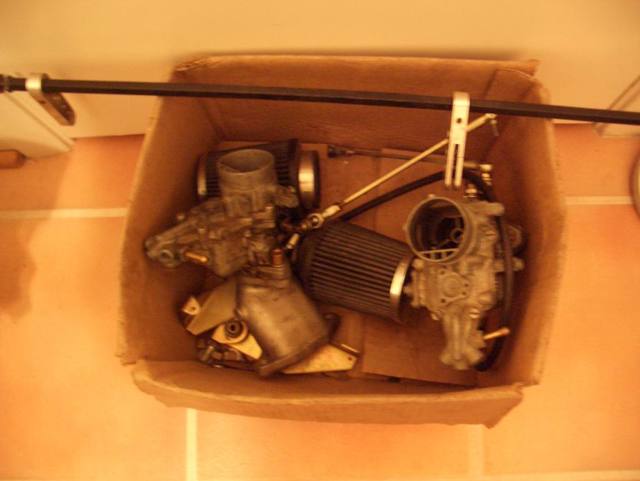

Well not much has changed with the bug. I haven't had much spare time. Christmas came early for me this year. A friend of mine gave me a set of Weber 34 ICT's. I will either have to put my other engine in the car or get a set of single port manifolds for them. Either way i'm pretty excited to have them.

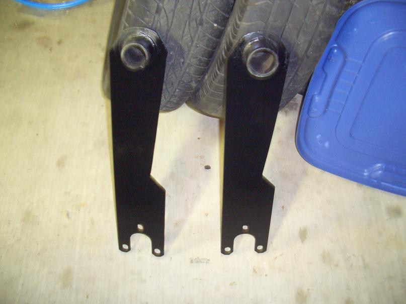

I got a little work done on the bug this weekend. Most of my time was spent drive between the house and Lowes collecting parts. I was able to get the spring plates notched, got the carbs finished up, mounted the coil, installed a degree, and redid the front end.
The hardest part was figuring out the front end. The through rods were too long so they were rigged so to speak. I had to cut them down and re-tap them in order to make them work correctly. I also replaced the front ball joints. I also replaced the spring plate bushings with urethane bushings, that made the rear a lot smoother going up and down.
After doing all of that i was able to make the rear about 3 inches lower than it was and the front about 1/2 inch lower. The pics of the car is with 185's all the way around. The beam is about 2 inches off the ground and the rear is about 3 to 4 inches off the ground.
