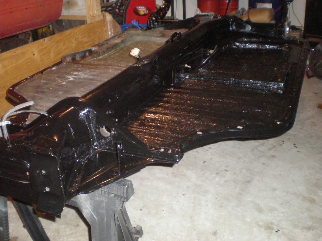

Posts: 392

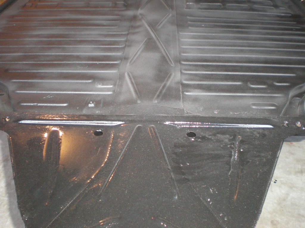

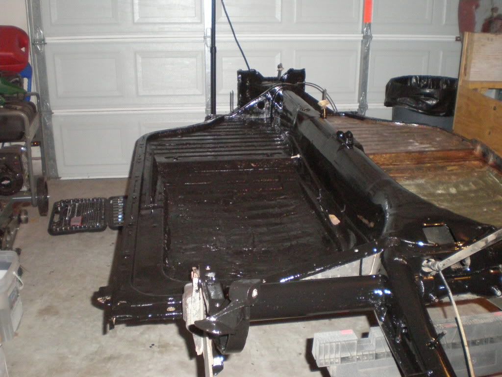

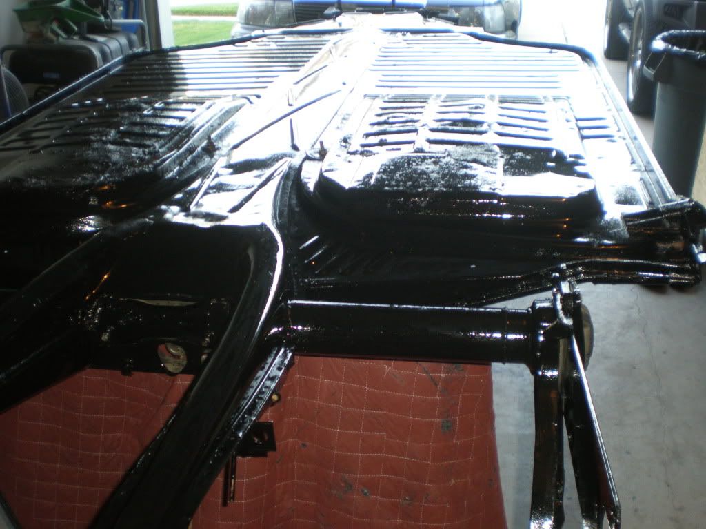

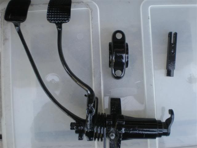

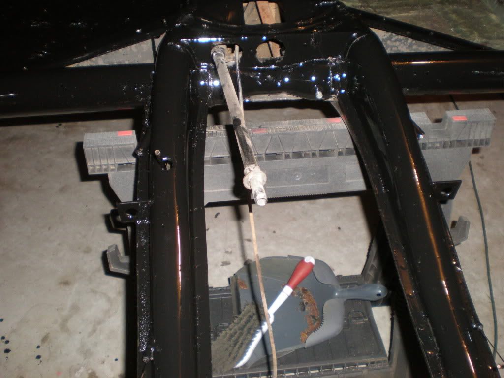

Laying down the Por 15 and undercoating.

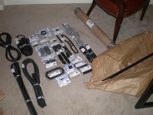

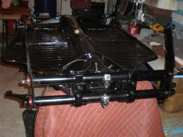

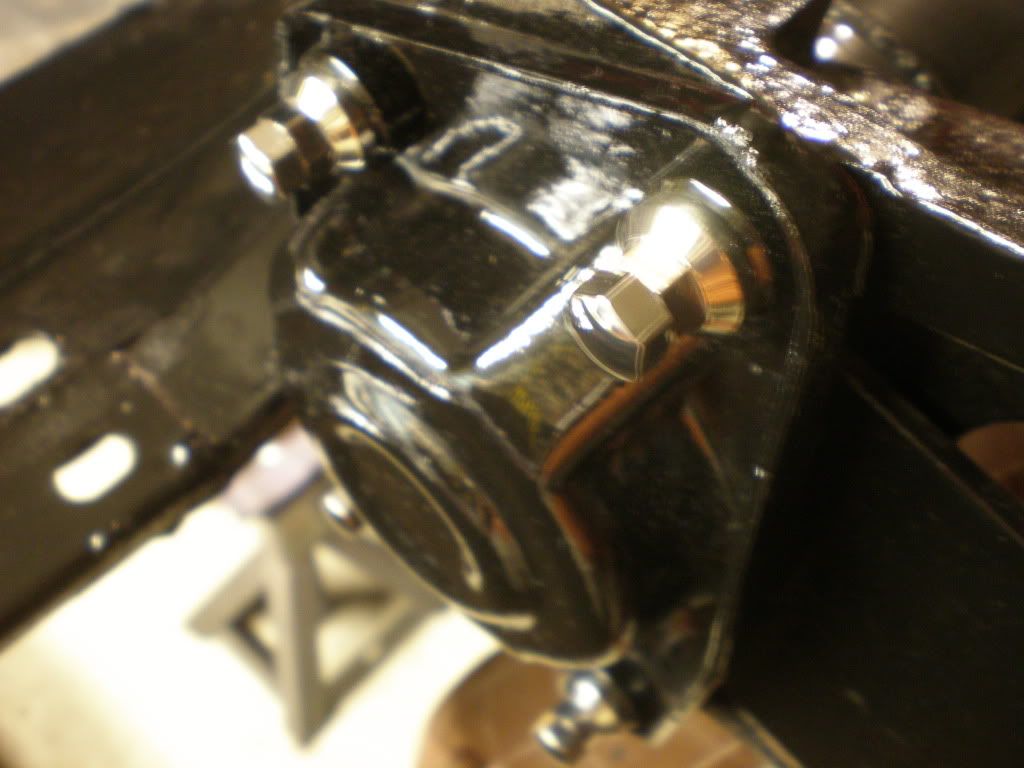

Here's the beam on the chassis, its a 4" narrowed, adjustable and will have drop spindles when its all said and done..Couple of seals and stuff from WCM..

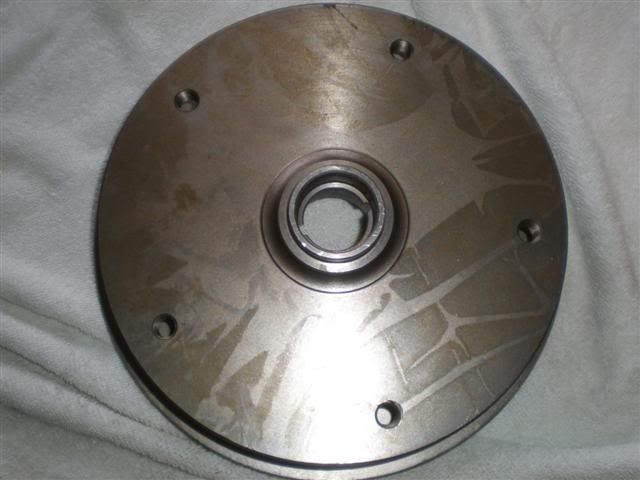

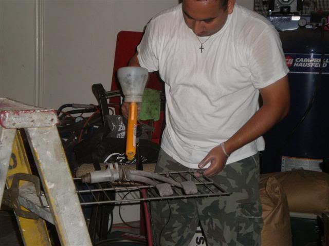

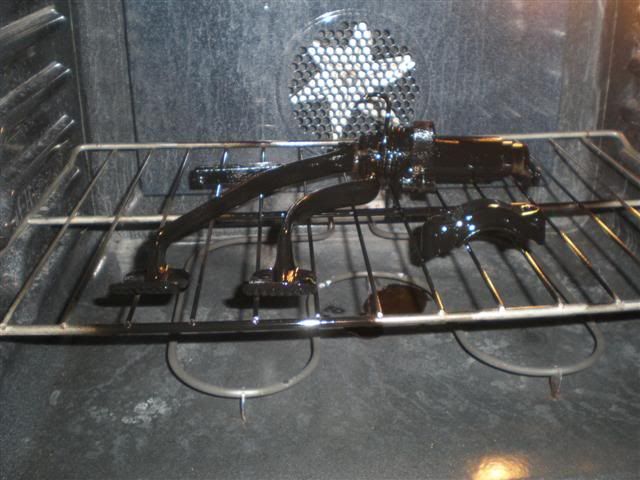

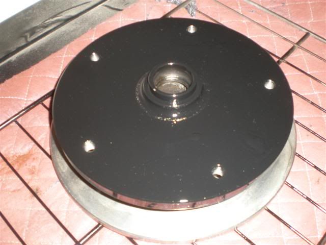

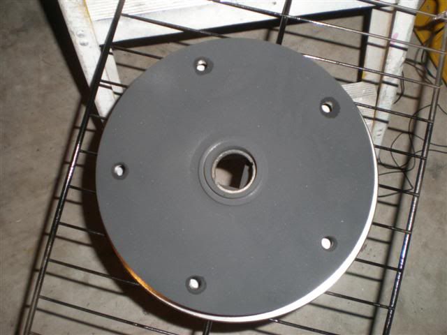

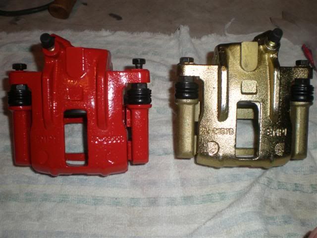

Well, here I am testing out this powdercoating gun..Thanks Brad!!

Posts: 392

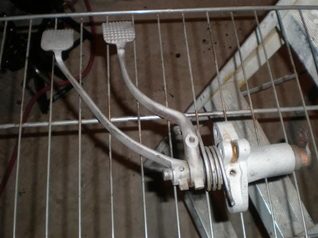

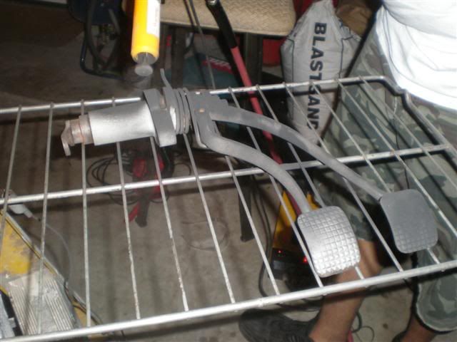

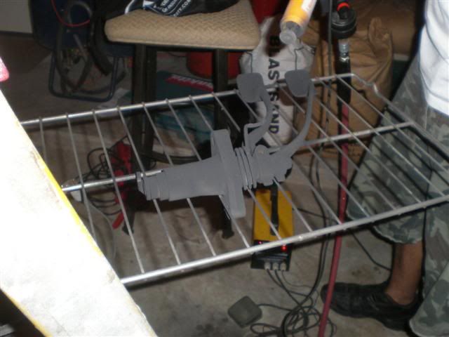

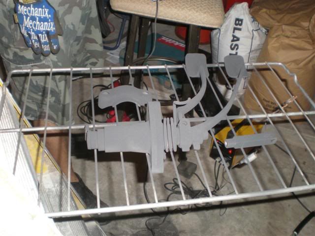

More powder coating...

that is bad ass...how does that compare to comercial powder coating

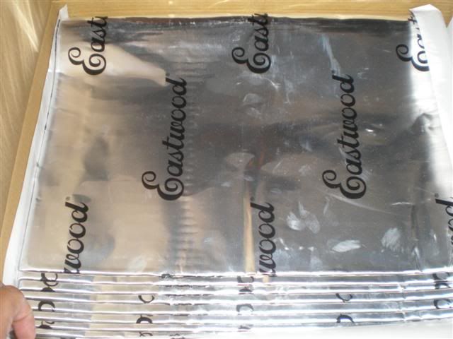

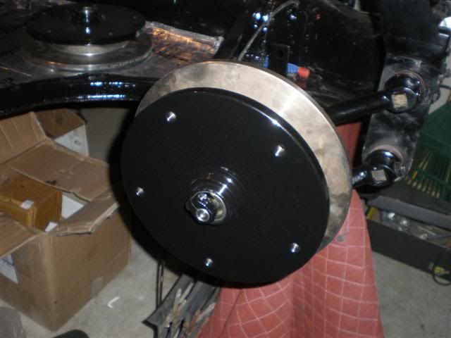

PostPosted: Thu Sep 30, 2010 8:12 am
Posts: 392

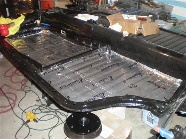

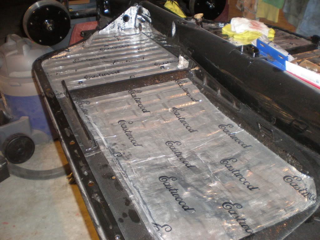

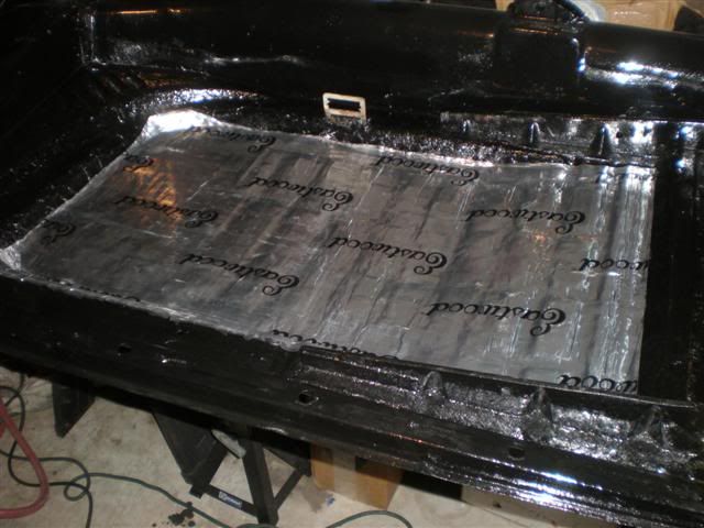

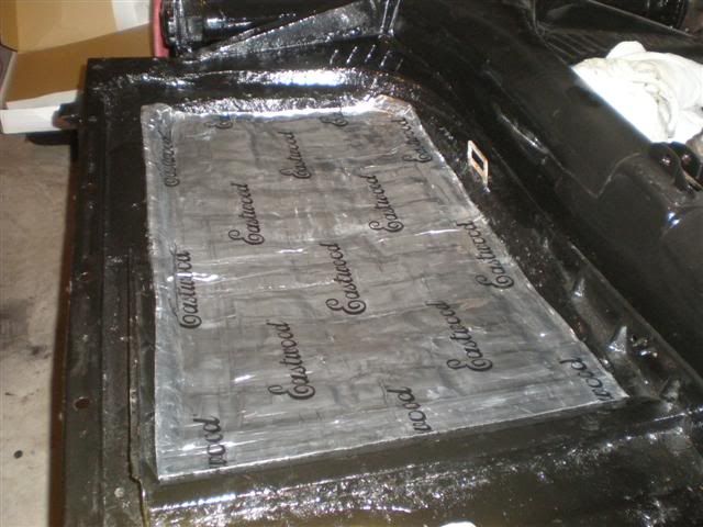

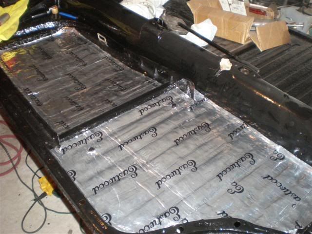

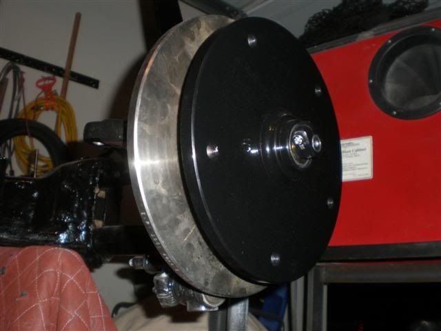

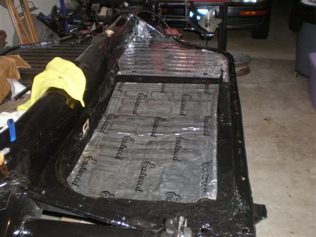

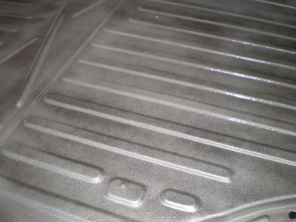

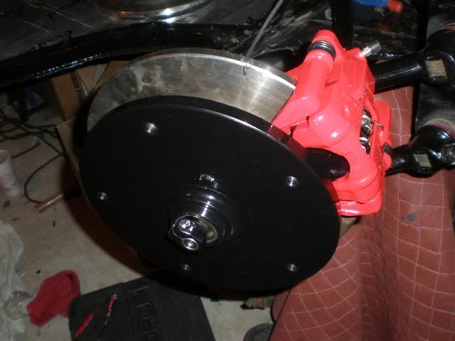

Laid down the EASTWOOD sound deadening material, finish coating the other rotor and pressing in the bearing races..I went ahead mocked up the calipers on the rotors,it's starting to come together :thumbs:
It's the same..but I can only coat small stuff, I dont have a Big enough oven..15" rim is the largest I can go in my oven

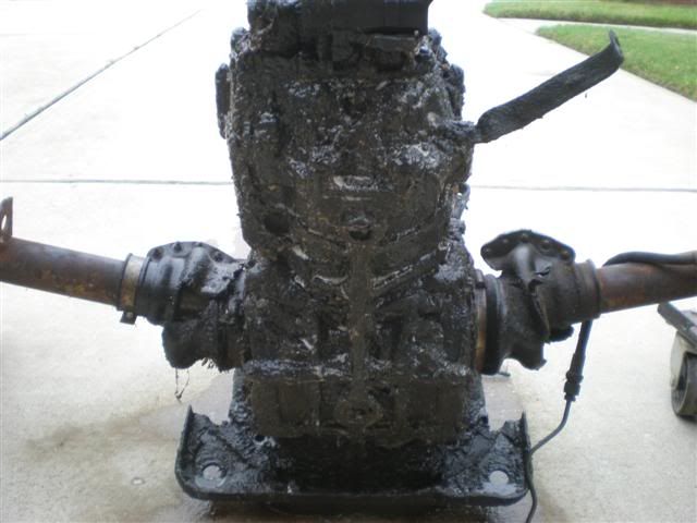

Posts: 392

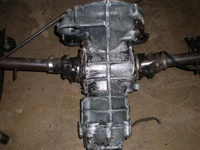

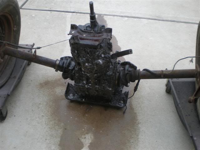

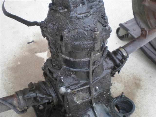

Started working on cleaning up the trans..Here's some before and after pics..Still have 2 more passes with the pressure washer, then I'll hit it with the blaster using walnut shells and get it real clean.
