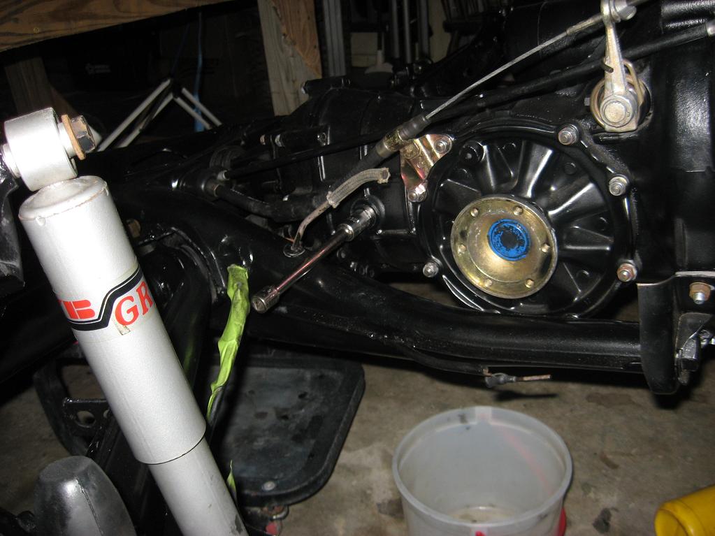

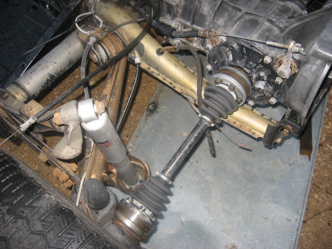

here is a pic of what I have

That's Wayne. Once I saw it I remembered it. It's only been about 30 years.
Any chance someone has one of these? Guess I could check with Gary.

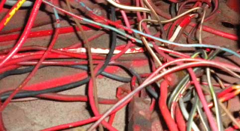

PO had the Ghia painted. The painter was nice enough to get paint on the wires under the hood. Most of the wires you can still tell the original color and the tracer color. Any way i can removed the paint without removing the tracer?

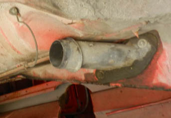

I'm not going to be using the heater. Is there a cover I can obtain for the body openings or do i need to fabricate a cover once I remove the plastic insert.

I take aluminum airnditioner tape and wrap over them to keep the air out. If the silver bothers you hit it with some black spray paint but heat won't bother that tape nor will the elements. It is some awsome stuff.

I need to seal mine up as well, in the past I have made covers out of sheet metal then RTV/bolted them on. I'm not that ambitious anymore plus I got some plexiglass left over from a previous project.
as for the custom red wire harness :hillbilly: , MEK might be able to safely remove that overspray. Mineral spirit will work too but involve more elbow grease.
The tape is cool but you have to keep it away from high heat. I took the plastic hoses off and there is what appears to be a flat surface with two bolt holes. Think I will cut a piece of ABS and bolt it on with some silicone.
Do you know if it will remove the tracer color from the wires? Will try it on some crap wire. Thanks nick.

Just test it on one of those wires, I have no idea. My cars have never had their harness repainted :hillbilly:
I just took my bakelite heater ducts off and reattacted before the body was put on .
