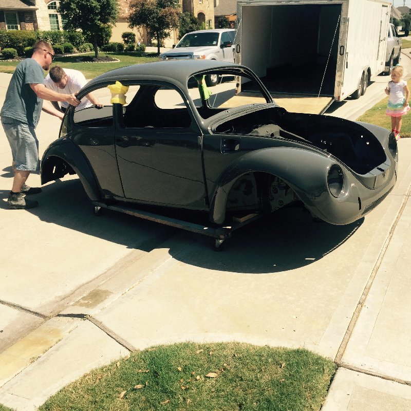

PostPosted: Sun Jun 28, 2015 8:06 pm
a few shots from today..enjoy :thumbs:

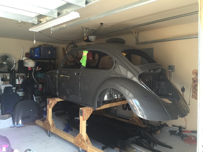

PostPosted: Wed Aug 12, 2015 8:16 am
Joined: Wed Feb 04, 2015 2:20 pm
Posts: 18
She is back in the garage, on the dolly and ready to start receiving parts. Jason and the guys did a great job. Once rolling again it will be back for a good buffin and cleanin!! :D :D
Hood is still with the guys. I'm starting on the rear suspension and moving forward.

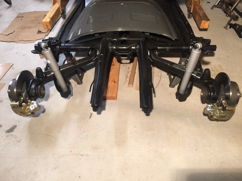

PostPosted: Sun Dec 27, 2015 8:45 pm
Posts: 18
Been away from the net a while, putting the rear end back together. Rebuilt the rear stub axles, new disk kit, new shocks, new bushings and new hardware installed. It's a bit anti-climactic as I think it will all come apart again to get the stance right. I lowered the rear spring plates 1 outer click. Have also been cleaning CV joints by hand in the garage, what a PITA. Need to find a hookup in Katy who has a good parts washer. Soon to order the front suspension parts, want to get the body mated before the summer. Have the tranny and steering box out for a cleaning, would like to do a refresh on the trans seals, bushings and gaskets, intimidated by the job, curious if anyone has a transmission shop they would trust for this. Some pics below.
Also, have been posting and following a lot of interesting folks on Instagram. My handle is @NickoNiko if anyone is as addicted to IG as I am. Hope everyone had a good Christmas full of parts and tools!
