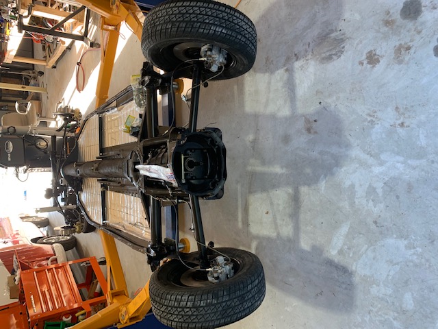

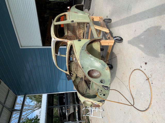

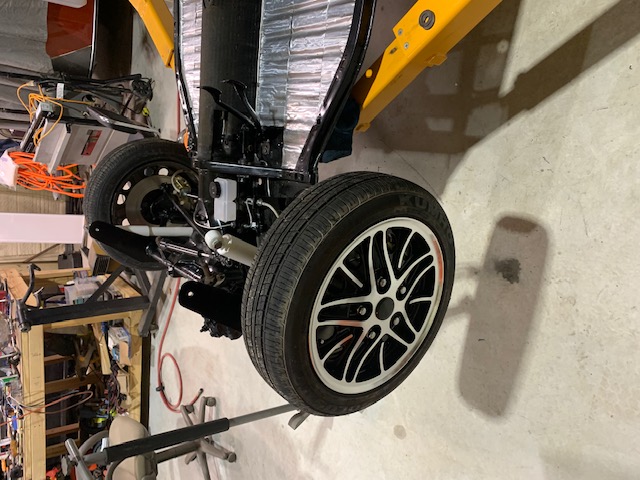

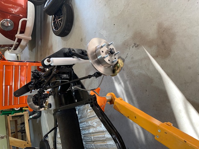

Been getting things done the pan is almost done, need to mount the shocks and put some fluid in the brakes. Today made the decision to make the car nice not a patina car, so it got taken apart all glass out, started sanding the surface rust off, so far it is cleaning up. The amazing part all the screws and bolt came right out, only have broken one bolt so far and it was a pan bolt.
