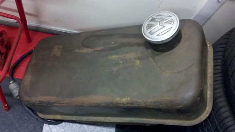

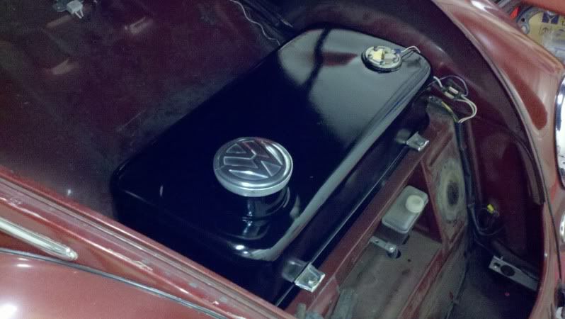

In the mean time, I coated the inside of my new tank with Por-15 tank sealer. I think it came out pretty good, I guess I'll find out, lol. It leaves a nice silver finish so you can see where it's coated.

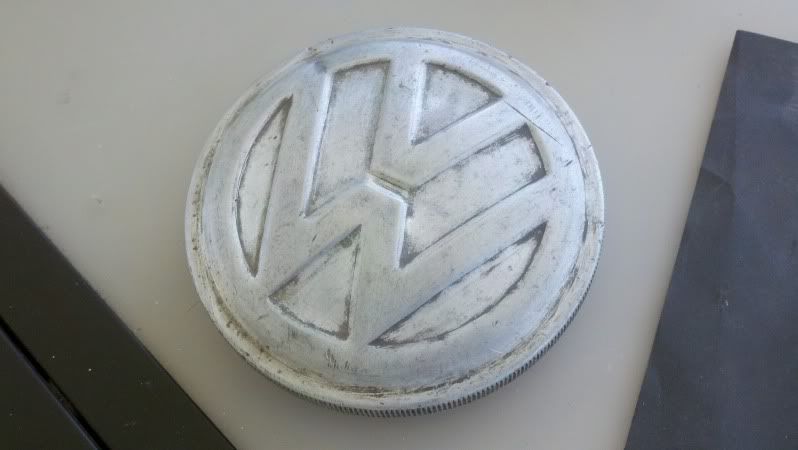

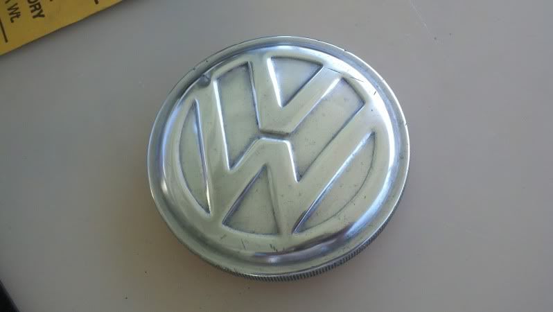

I primed and painted the outside of the tank too. Between coats I polished a spare gas cap I had. Not exactly a mirror finish, but a big improvement...
I got the tank mounted in the car, plumed up the the new AN lines, the sender installed, and the Dehne gauge all wired up.
For reference, here's my old tank, spotless on the inside, but solid rust on the outside. It's a perfect tank though, so I'll hold onto it.

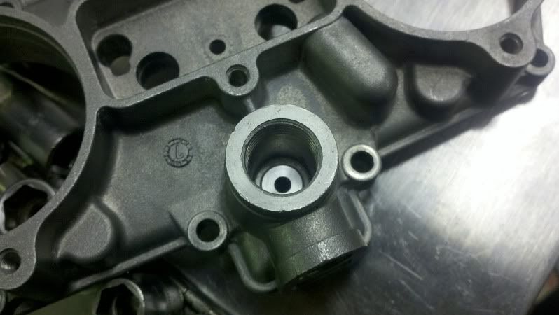

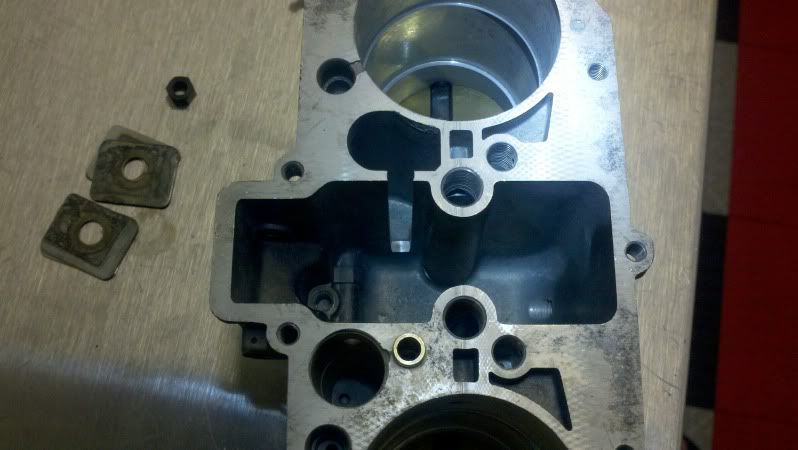

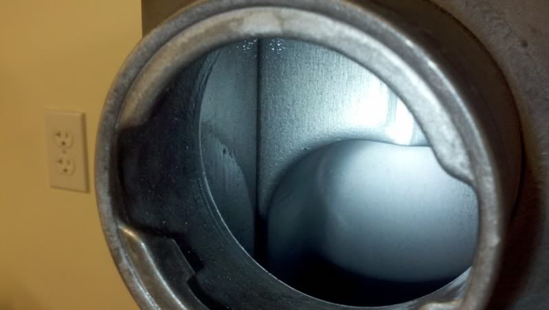

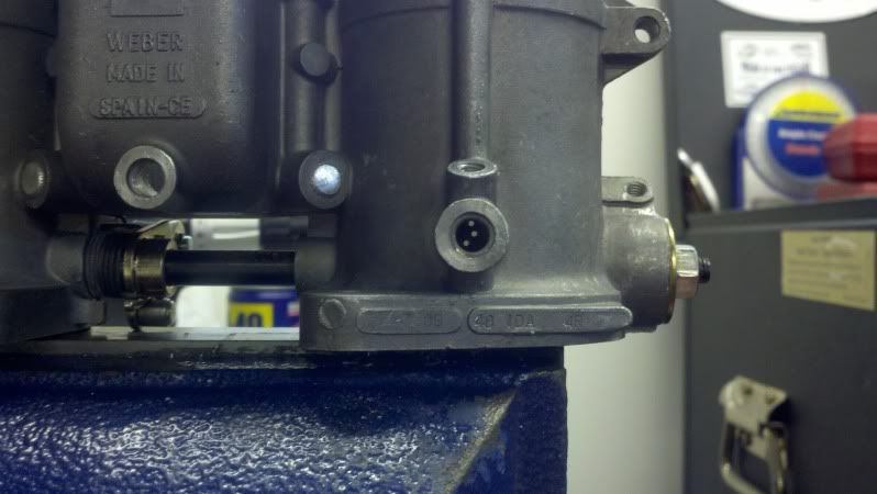

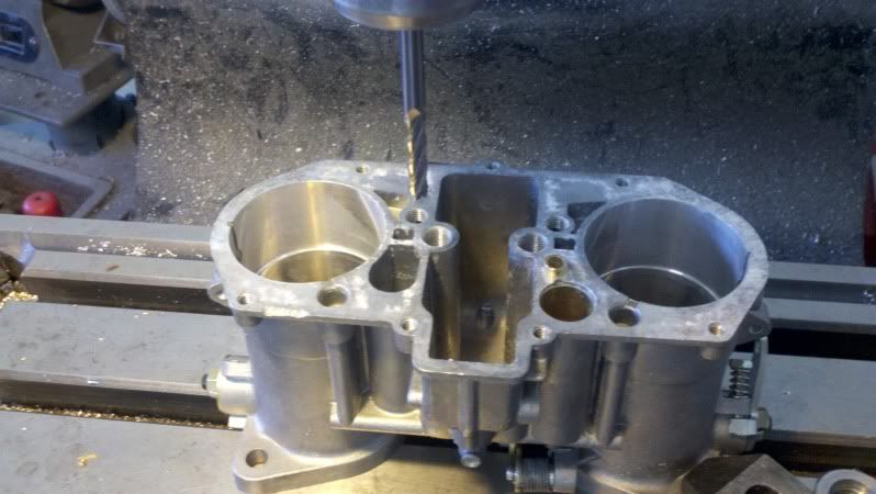

I spent about half the day at Darren's shop on Saturday modifying my IDAs and porting my Berg intake manifolds. The manifolds are basically done, they just need a little welding. On the carbs, we drilled the 3rd progression holes for better drivability and opened up the idle air jets...
Opened up the dead space in the bodies for more float bowl volume.....
and modified the inlets for less restriction...

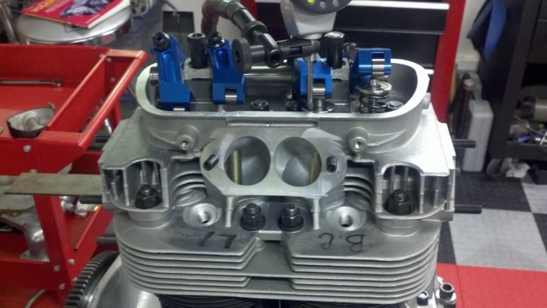

Funny story about my heads... Darren was supposed to have them done Saturday, but when he was assembling them his valve compressor slipped and one of the special keepers I supplied shot across his shop, never to be found :lol: I ordered some replacements today and had them overnighted to his shop so he can assemble them tomorrow. In the mean time, I brought one of the heads home for test fitting.

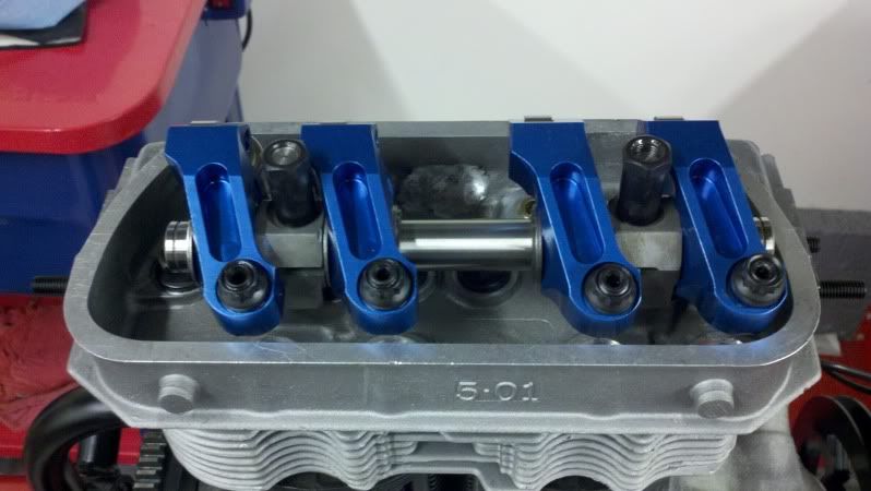

New L7 CNC heads...
Pauter 1.5 rockers....

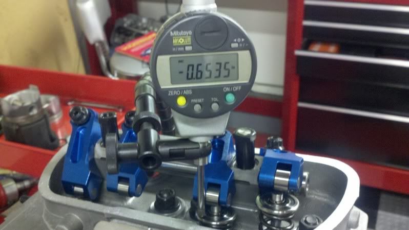

Measuring lift at the valve and figuring out pushrod length. Lift at the valves is over .650" :shock: That's a 10th of an inch more than I had before with the old cam and rockers, lol.

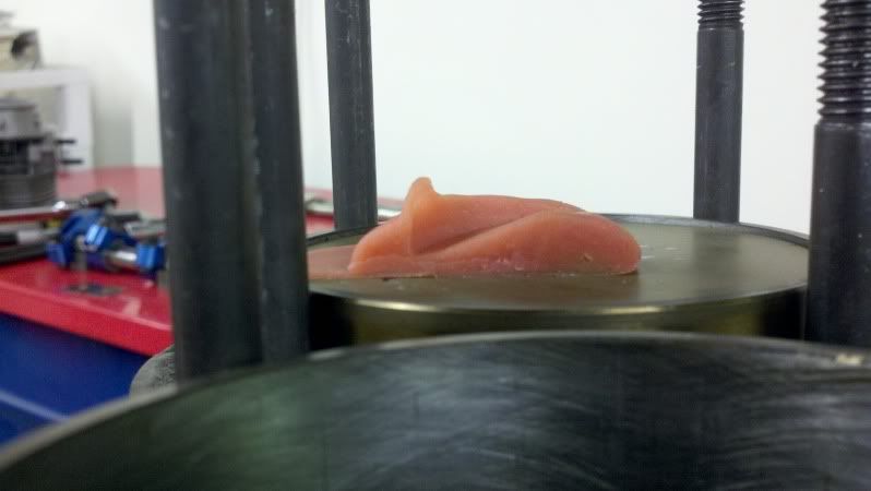

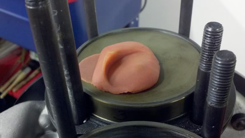

Checking valve-to-piston clearance, with Playdoh, lol. Plenty of room, about 1/8 inch, so no need to notch the pistons
