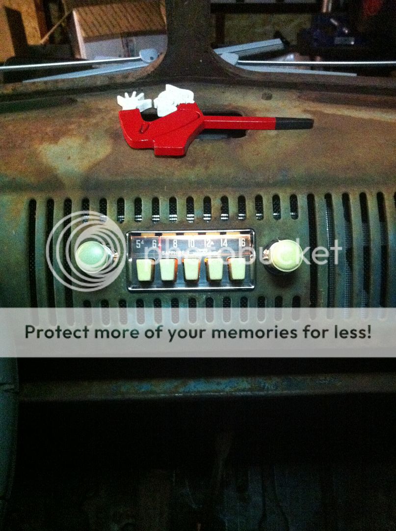

Radio is wired up and working. The sweet crackle of AM radio!

LMAO for a minute I thought you said AM :lol:

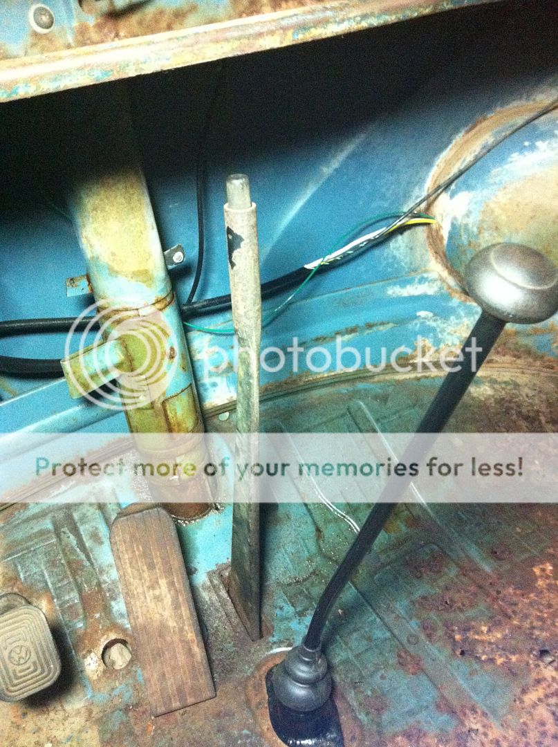

Shifter has been rebuilt and greased. No nylon bushings to replace on the shift rod, but I greased below the "M" spring and the hole where it passes through. Rear bushing feels really good, so I didn't mess with it. Just need to install the dust bellows and new shift coupler to the trans.
I also PB Blasted the heat tube and cleared out a bunch of crap. It now moves freely. Maybe I should consider installing heat exchangers and fixing the heat once it's a driver.

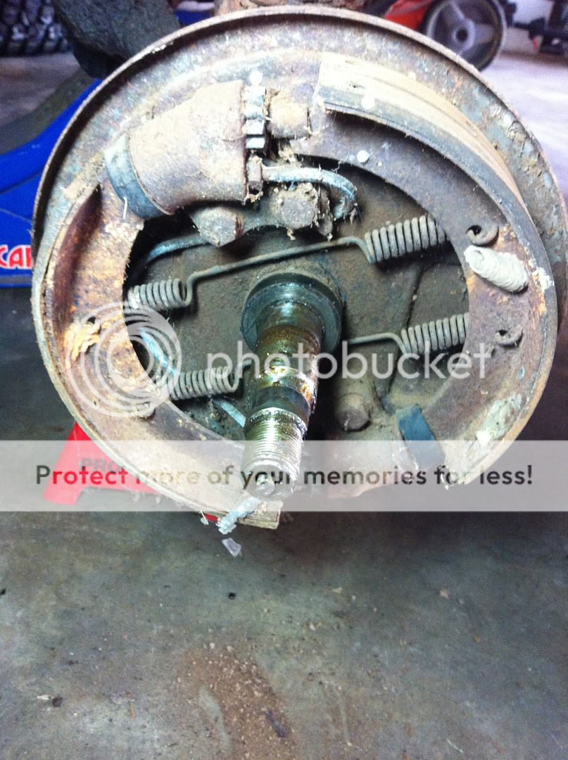

Got the drums off. Driver's side was crusty, but came of fairly easily. Passenger side was a bitch. The star adjusters were frozen and the shoes were a cunt hair to far out. I had to bolt up an old rim and beat on it with a 20# sledge hammer. I was finally able to wedge in a couple of pry bars and get it the rest if the way off. It's to damn hot in the garage to work more than a couple of hours at a time. At least I can do 'night time' work and finish the rebuilding.

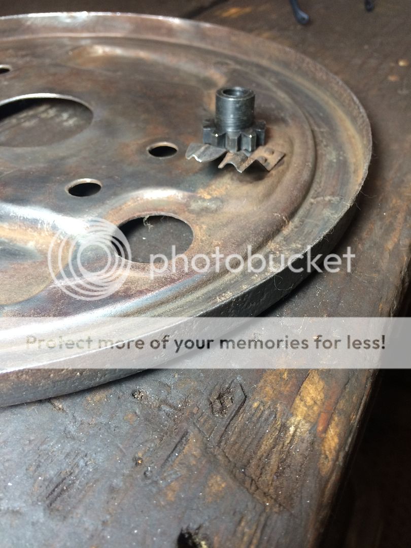

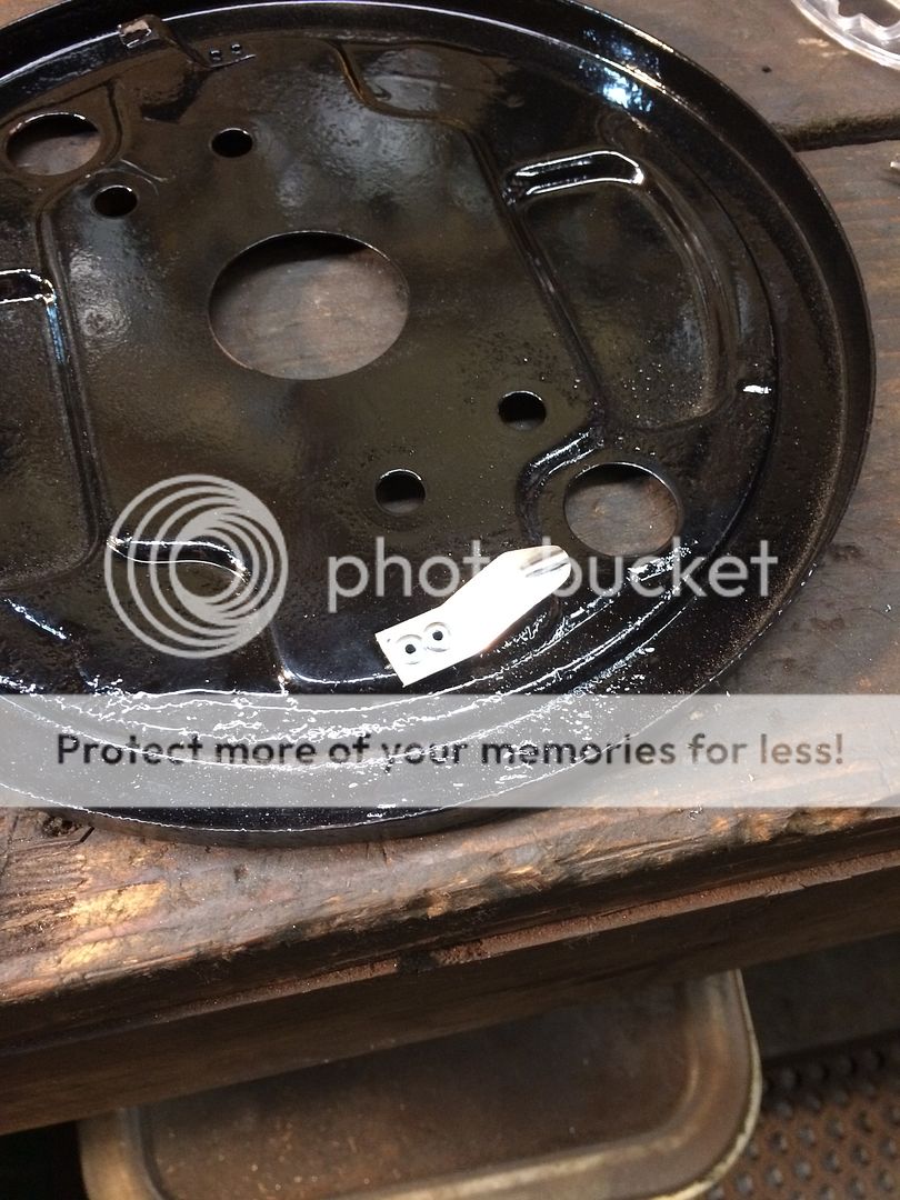

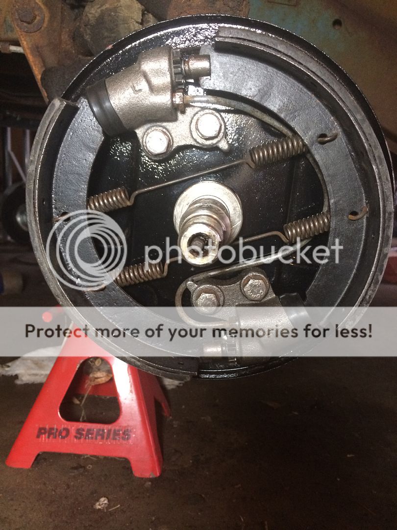

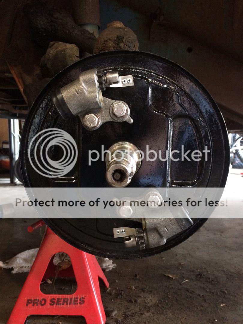

I did some more work on the front brakes. I had to fab new star adjuster tabs. I used hose clamps for the material.

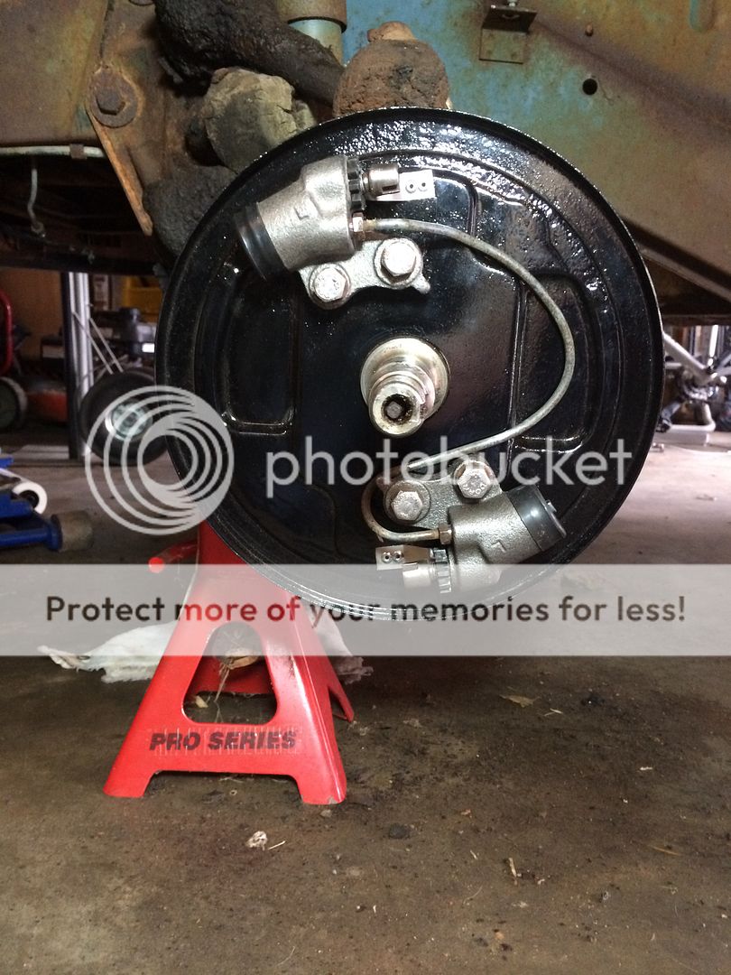

Drivers side is plumbed in. I will do the passenger side tomorrow.
I fabbed a new brake push rod. I also managed to break the brake return spring. I have to wait for Wolfsburg West to show up. I will rebuild the pedal assembly while I wait for parts.

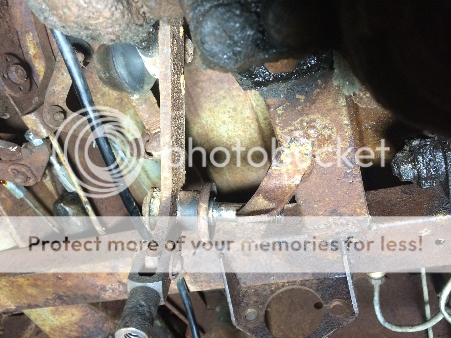

This is the brake pedal assembly....
Broken spring removed.
