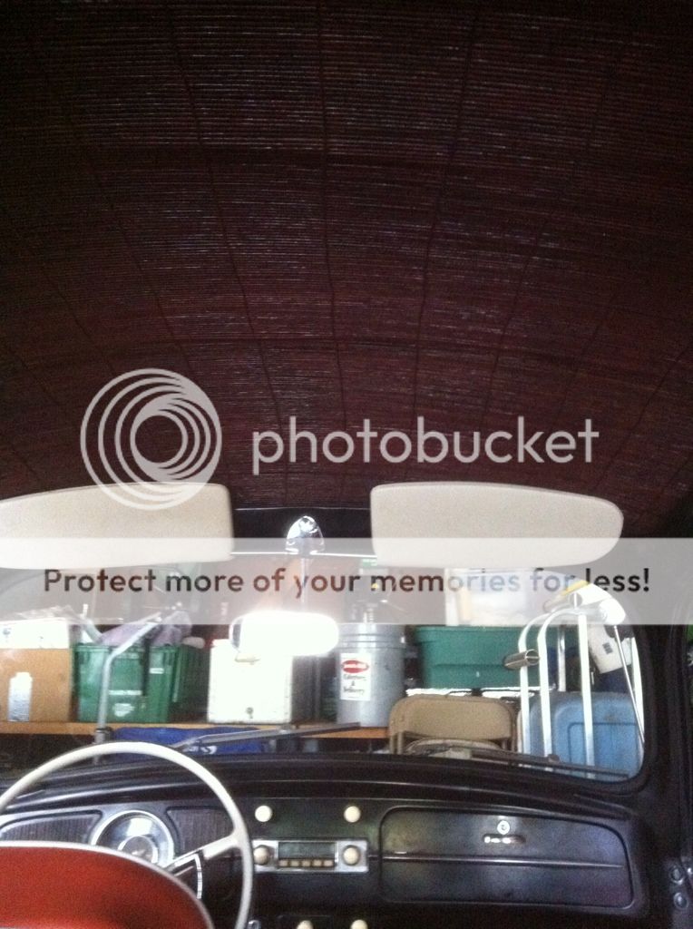

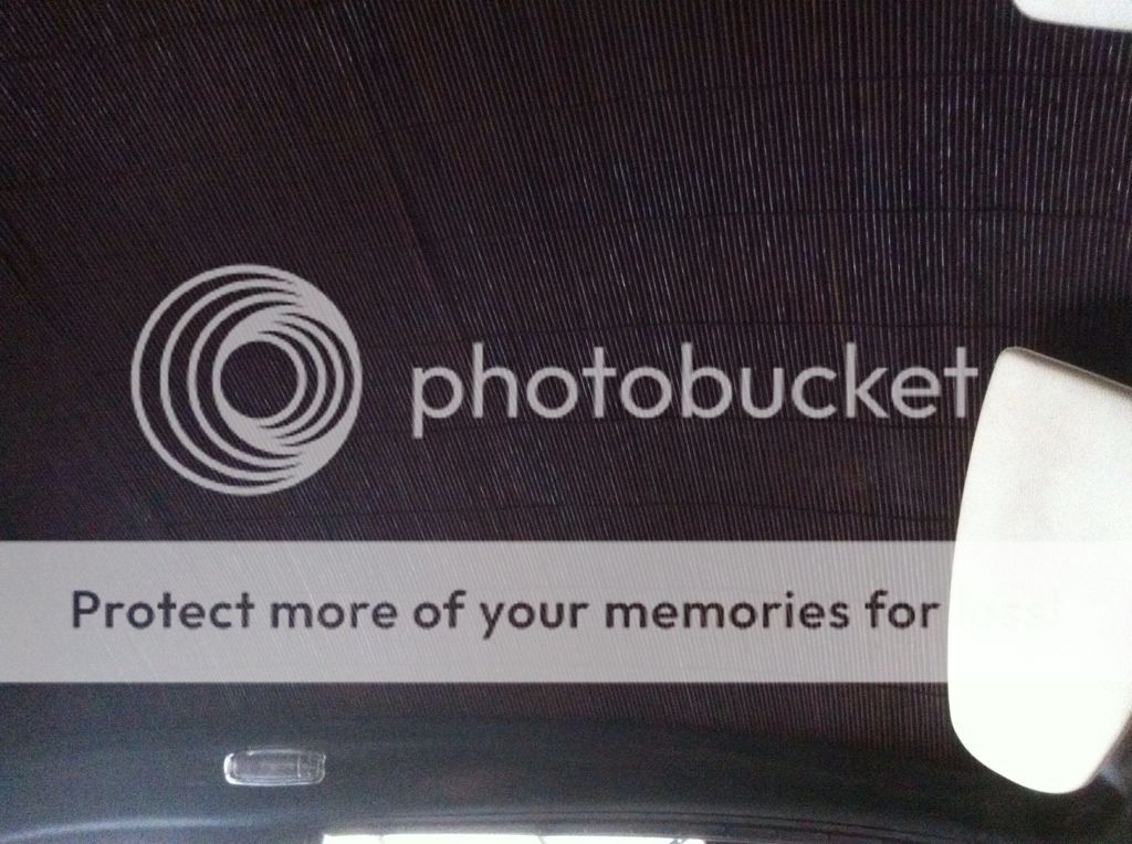

Pretty cool! what did you use to make it stay, glue?
 Post subject: Re: Dylan's Bagged 60
PostPosted: Tue May 29, 2012 9:24 am
Slipped into place like a headliner bow.....
PostPosted: Tue May 29, 2012 9:25 am
Good idea... looks great!
PostPosted: Tue May 29, 2012 9:57 am
Looks good
PostPosted: Tue May 29, 2012 4:14 pm
Headliner is in! It looks alot better than tar board patches. Total cost was less than $20!
Looks sweet!!
PostPosted: Tue May 29, 2012 11:34 pm
what were the dimensions you used on the headliner?
PostPosted: Wed May 30, 2012 7:42 am
40" wide X Long...
I never measured the length. I trimmed off what didn't fit. I bought the blind on the clearance rack, so there were no markings. Measure it with a tape measure then add a foot. I used a dremel with a large cut off wheel to trim it to length. I used super glue on the ends of the string where it weaves around the sticks to keep that from unraveling. Once the string was glued I cut the mechanical part on top and the bottom bar off.

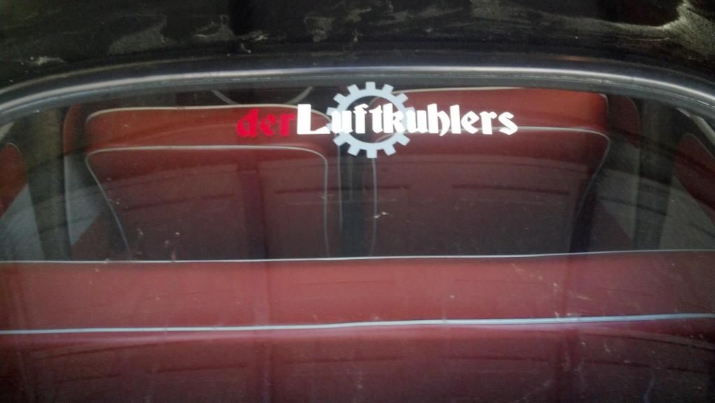

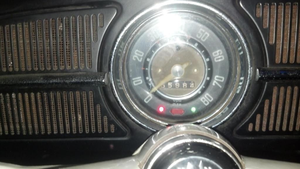

Did a couple of minor things this past week.. Changed out to the new style decal so I can see a little better, and replaced the gels in the speedometer so I could see those better. Maybe I just outta go get my eyes checked out :D
