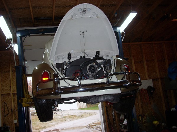

No ... but that would be cool. It's a pole barn style garage with a regular lift. Here's the Bug on the lift during a previous valve adjustment.
