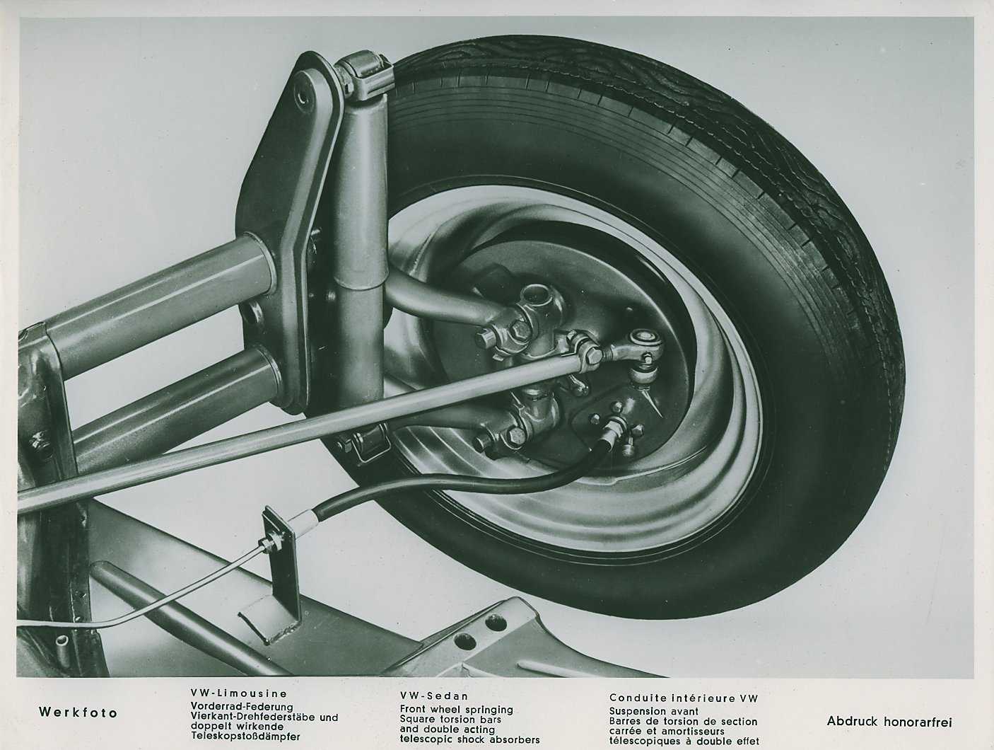

John W2 wrote:
Thanks Ethan. I guess my question is does the upper torque arm normally rest against the bump stop or should there be a gap?
Yep it normally rest against the bumpstop

On a stock setup it is what it is with no ajustment. So if it sits nose high or ass saging is there away to ajust the rear suspension to bring the ride to level without ajustable beam or drop spindles?
Thanks again Ethan!
 Post subject: Re: Kbug's 61 - Eugene
PostPosted: Mon Apr 02, 2012 7:10 pm
Respline the trailing arms. There are a million threads on theSamba on lowering the rear. You would just go up, instead of down.

Personally I would not raise the rear end. I would just add dropped spindles to the front to bring it down.
PostPosted: Tue Apr 03, 2012 3:24 am
i agree
