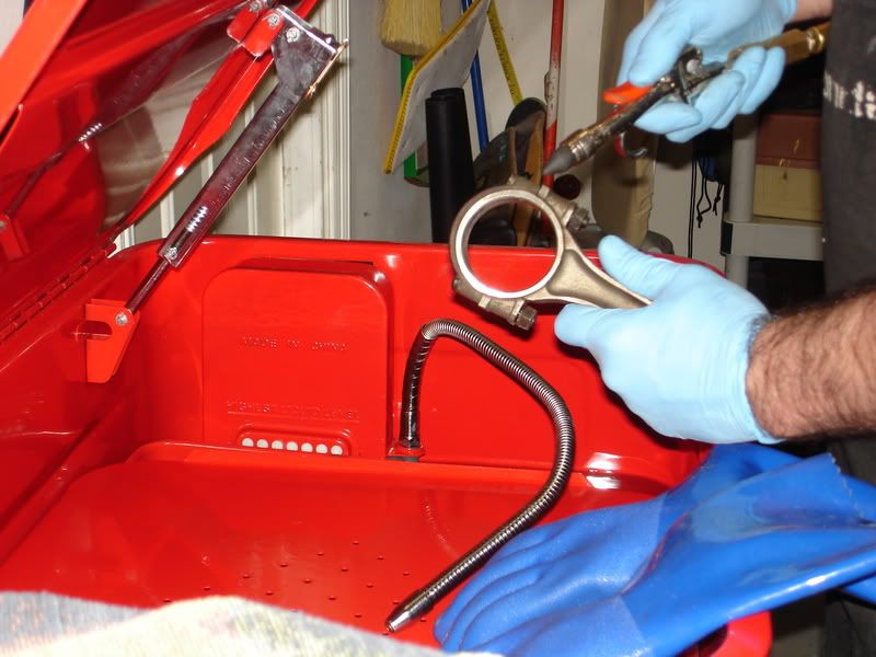

Scrubbed and drying off after letting them soak in Varsol, overnight.

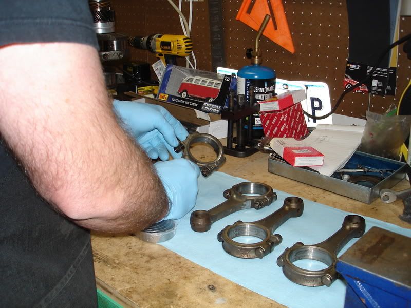

Dissemble

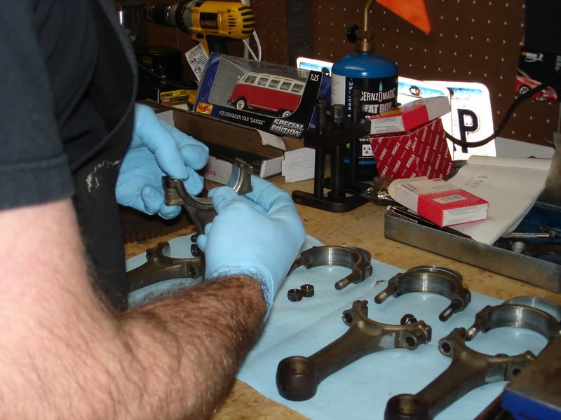

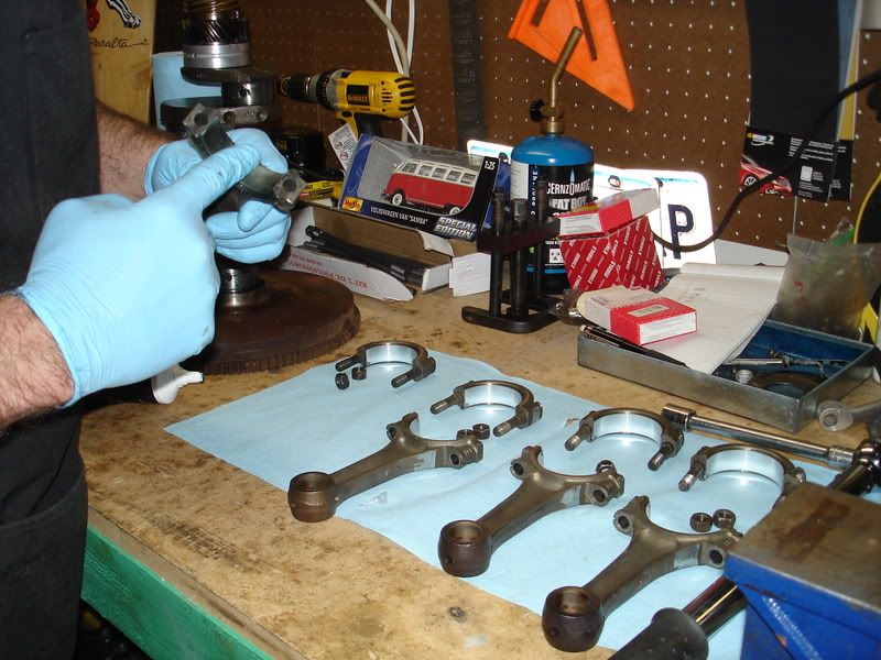

Placing rod bearings in place
Lubing both journals and bearing face

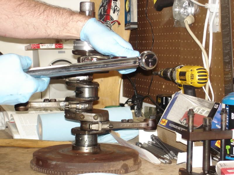

Torquing the rod caps

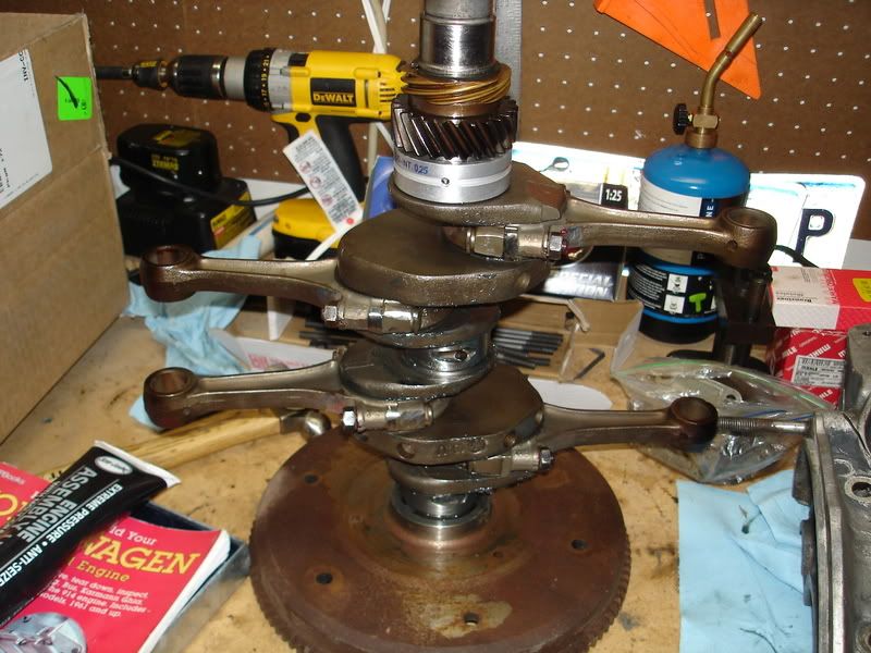

Finished rotating assembly
