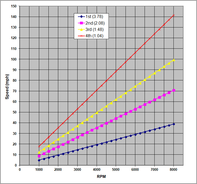

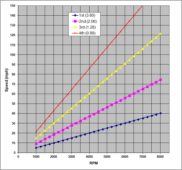

If you're going to run stock 3rd maybe a 0.82 4th wouldn't be that bad. The down side though is your car won't be very quick with that tall 3rd and 4th :P
Here's your RPM vs road speed with stock gears and a 3.88 R&P (for your car I assumed a 25" tall rear tire):
Here is is same as above but with a 0.82 4th:

I think Murray is running a tall tire, 205/70, making it just over 26" tall.
