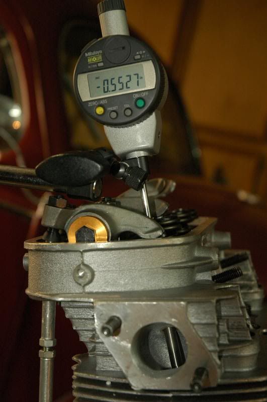

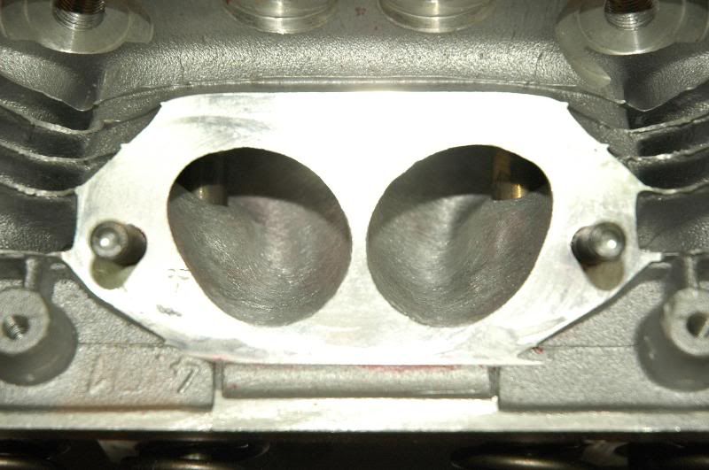

There's some of it. I need to finish that thread with the rest of the build...
Intake ports :wow:

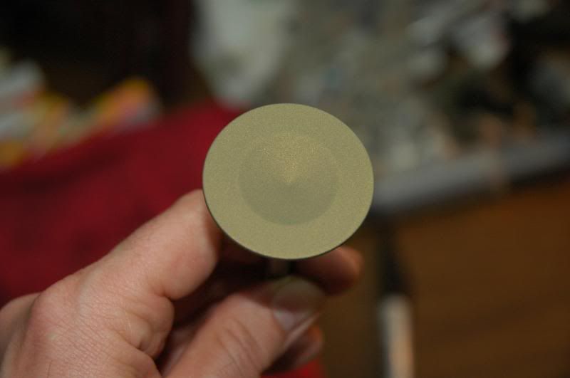

Valve lift .553" & 305 deg duration :wow:

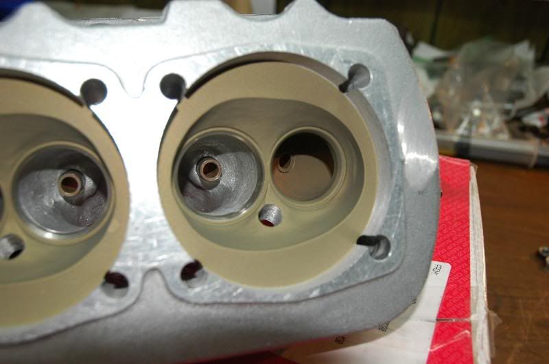

Ceramic coated combustion chambers, exhaust ports, and valves 8-)

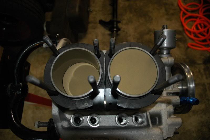

Ceramic coated pistons 8-)
It gets the job done :lol:

Hey Brian, are you useing the ceramic to keep the heat off of the pistons a little better? Did you coat them entirely or only the tops?
Looks freaking cool as heck though :dance:
 Post subject: Re: 55 oval
PostPosted: Tue Apr 07, 2009 12:49 pm
The ceramic coating is to keep heat in the combustion chamber where it belongs and where it makes power. should keep engine temps down too.
Only the piston tops are ceramic coated. The sides are graphite coated.
I'm a dummy. How is having the sides of the piston graphite coated beneficial? :help: :oops:

dry film lubrication, reduces friction on the cylinder wall

looks good,looks like we have the same machinist LOL ,are those rods cb performance,i also have h beams in mine thats a nice set up on the motor,i like the oval porting mine look more like a D shape
