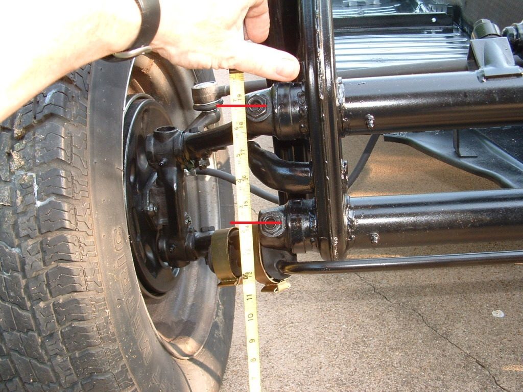

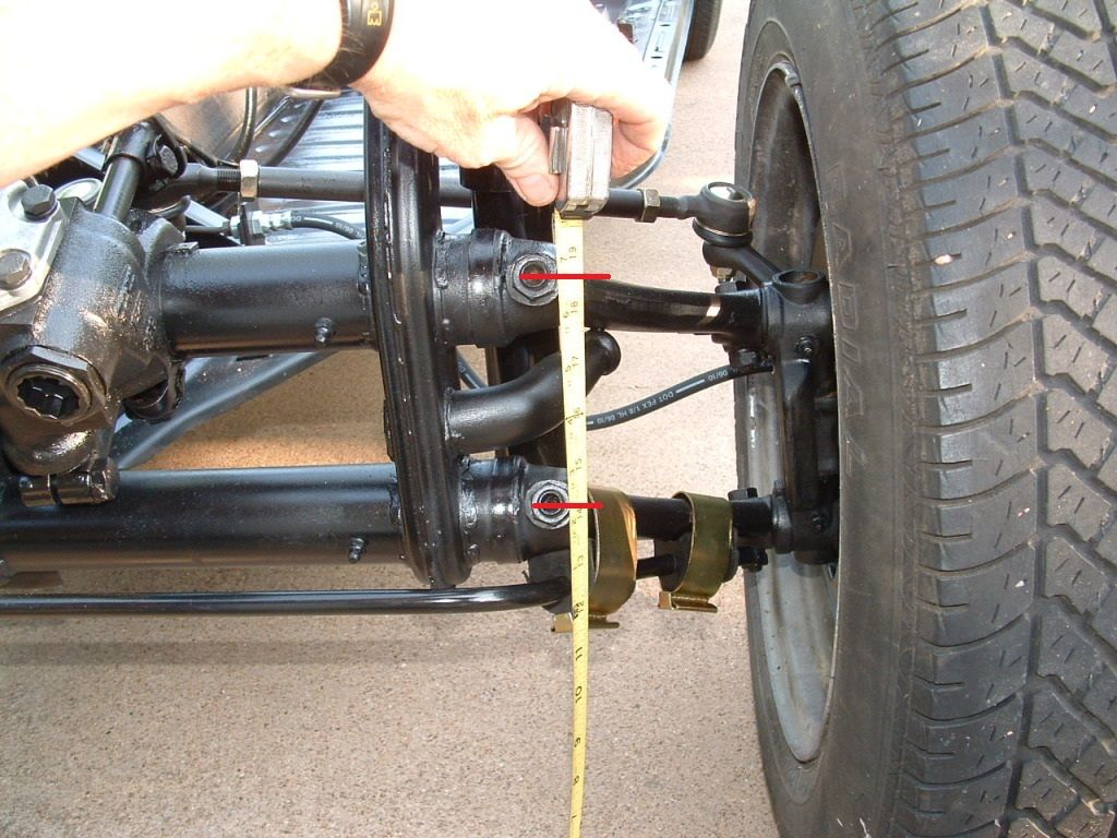

John chassis looks great! I wouldnt worry to much about how it sits until you have everything on like the snubbers and the body.
Also if you are basing your measurement off the sway bar that will be inaccurate. If you look at the grub screws (center of leaf springs) to ground your front end is pretty close to the same side to side.

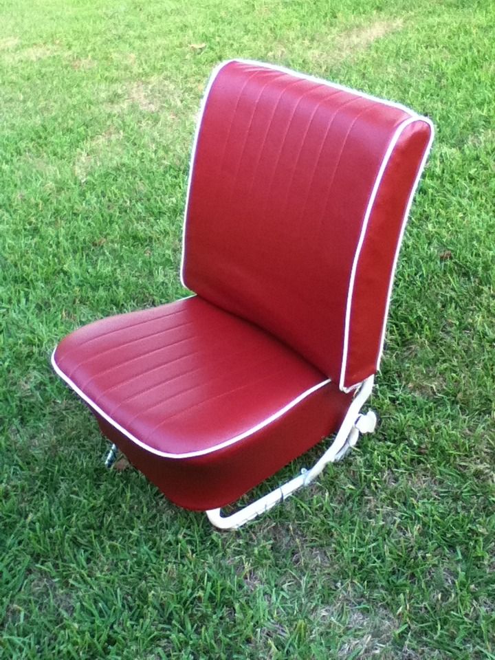

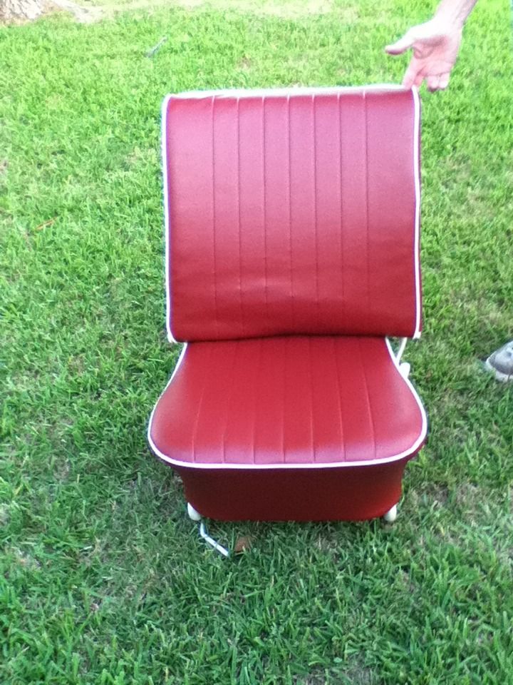

I have done a first, my daughter and I recovered the driver's seat and it came out pretty nice. We'll get back to the rest of the seats later.

Seat looks great!
 Post subject: Re: Kbug's 61 - Eugene
PostPosted: Tue Jun 26, 2012 6:31 pm
Posts: 177
Location: Kingwood, TX
I love the red seats! Great work!
-Ron
1966 VW Bug
PostPosted: Tue Jun 26, 2012 6:39 pm
me too .. nice work ...
PostPosted: Tue Jun 26, 2012 7:01 pm
Posts: 374
Location: DFW
Thanks. I hope the rest turn out as good.
