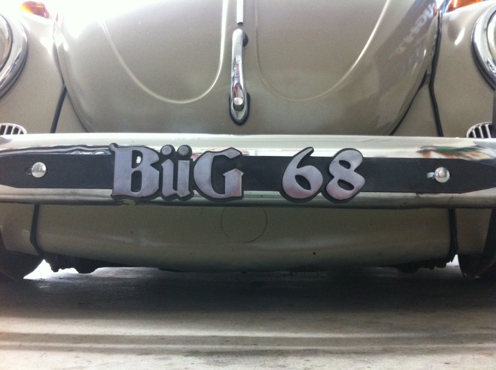

Thanks to LZ Industries for making it for me. :thumbs:
 Post subject: Re: BUG 68
PostPosted: Wed Jul 11, 2012 5:58 pm
Nice :thumbs:
