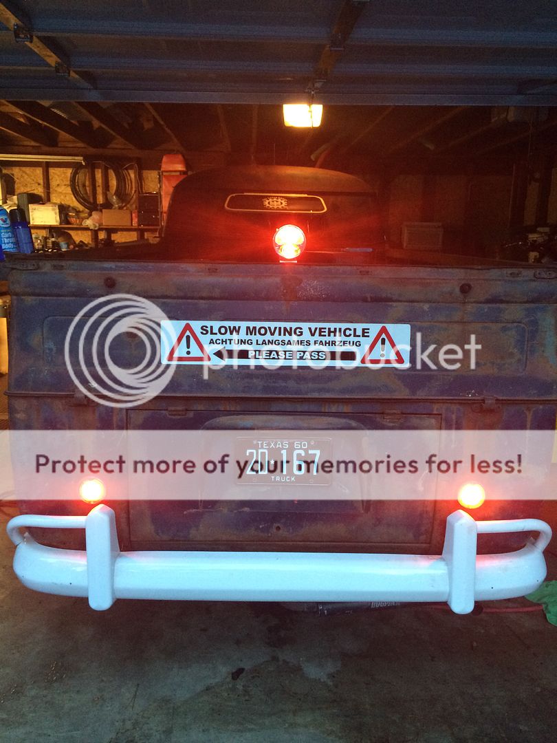

Brake lights work!

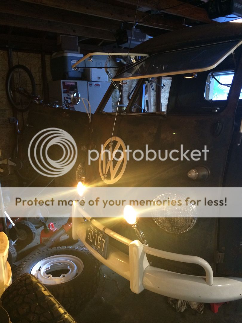

Fog lights...

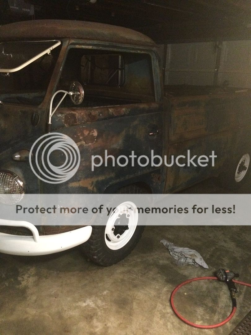

Officially not a jack stand queen!!
