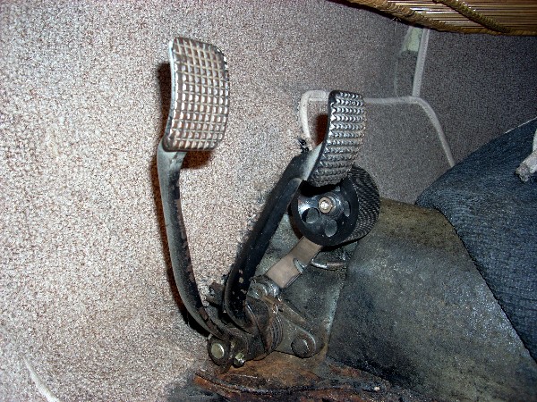

I'm still struggling with clutch issues. I went back and tightened up the clutch cable adjustment; still didn't want to go into first gear - kept going into third, other same issues.
I thought the problem might be clutch drag - clutch disc not completedly releasing. I know this generally causes difficult shifting, clashing of gears, especially when shifting in the lower gears. One of the troubleshooting problems is insufficient pedal free play.
However, I'm wondering if I just screwed up when I hooked the clutch cable and put the pedal assembly back in. Should the clutch and brake pedals start out in the same position from each other? The clutch is set back a couple inches from the brake pedal right now.
Could this be my problem? Could the pedal's starting position prevent full clutch travel and thus problems with engaging or disengaging the clutch? :help:

The Pedals should be close to same the position. I guess you have adjusted the clutch etc. Is the cable old? Is the clutch spring bad? see pic
I've adjusted the clutch cable (this all started when the clutch cable fell off the hook when I was putting in shims to take slop out of the roller gas pedal.) I solved that problem but created a new one.
FYI: I didn't have clutch shifting issues before I took out the pedal assembly. I put the cable adjustment back to the same measurement before the clutch assembly was pulled out.
The cable is not old - although it did take a good amount of pulling pressure to move it; spring seems OK.

Sounds like something is binding...
