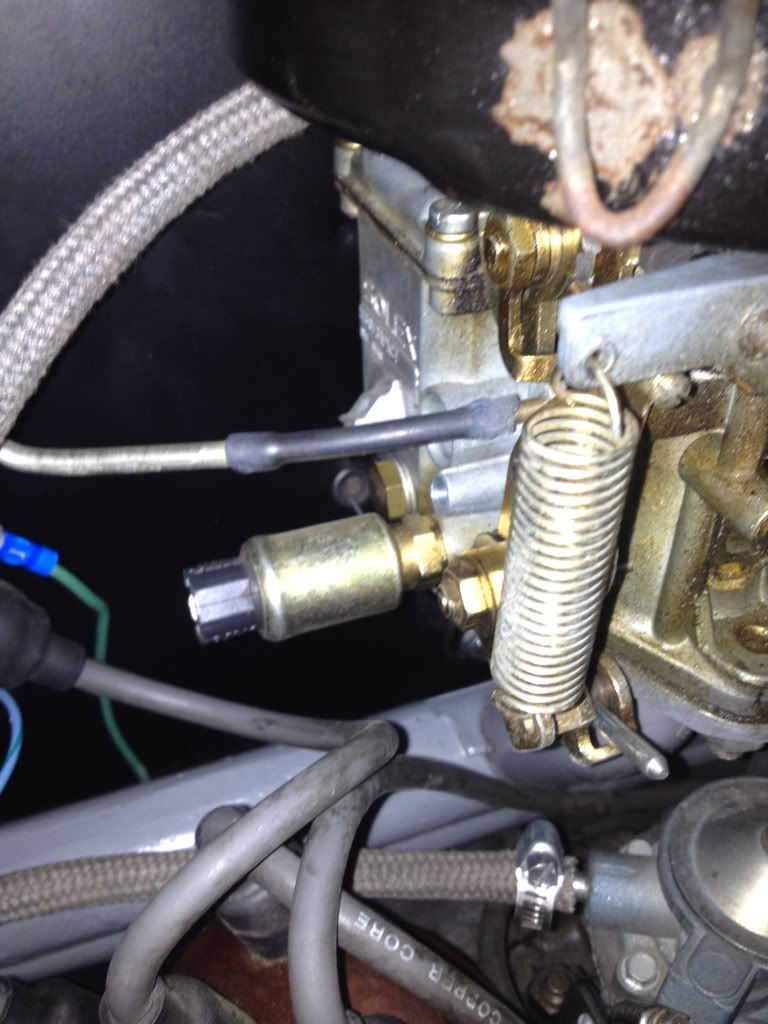

It's alive! I went back and made sure to retighten all the manifold to clear any a
Vacuum leaks. Then reset the valves, carb, points and timing. Hooked up the fuel line and varoooom it started! Let it run awhile, sounding pretty good, and then shut it down. Went to restart and dang it was doing the same thing as the first time, start but ran like crap and would idle only if you kept jacking with the throttle. Made sure the carb bowel was getting fuel, spark was there but could not keep it running. However the one thing I did hear all this was the idle cutoff valve clink when the ignition was turned on. A couple of taps and it started working and varoooom!
Are these new Valves prone to stcking?

I'm not sure about sticking. I'm sure you could clean it with carb cleaner. VW installed those valves to stop the motor from dieseling when shut off. If your motor is in good tune then you don't need it. If your motor diesels its a good indicator you need to look at it to see why its running hot and check your valves, ignition, etc.
If you want to disable permanently: Pull out the plunger and cut it off with some big wire cutters or tin snips. You can then tape up the wire or remove it from where its hooked up.

Try to clean it first.
 Post subject: Re: Kbug's 61 - Eugene
PostPosted: Sun Jul 01, 2012 7:02 pm
It has to be on the carb for it to run. If you hear it click then it's working like it should be. You can clip the end off and bam problem fixed.
If this is what you are talking about. Mine is not even hooked up to power but the end is cut off.

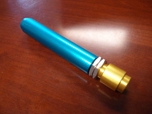

PostPosted: Sun Jul 01, 2012 8:03 pm
Posts: 2109
Location: Tomball, Texas
You can use the adjustable push rod tubes, they have a threaded adjustment with a back nut to tighten'em up. Better then the spring type. Just my 0.02
