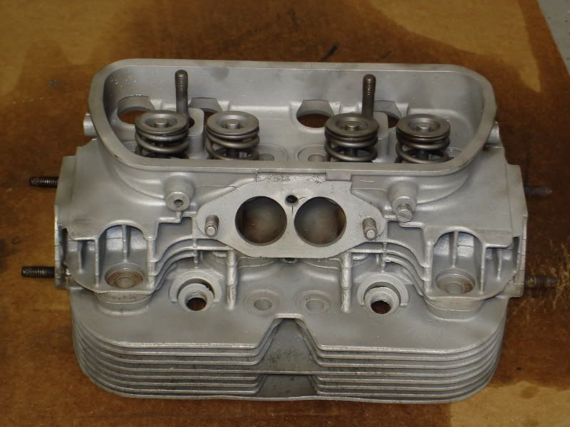

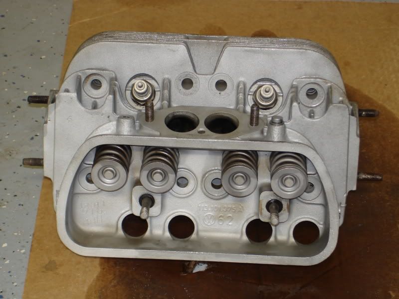

I was able to finish the heads, FINALLY!!!!
So now the heads can be installed and the engine will be closer to being complete.
I will be hitting the pans, suspension, and brakes, next!

Heads look good! Did you pull the valve/valve springs to blast the heads?
No. I didn't want to affect the seating of the valves with abrasive. Should I have?
No, you did the right thing. I would take the heads apart now though and make *sure* that all the blasting media is removed. Then lube up the valve stems with some lithium grease and reassemble (lap the valves too if you haven't already). :thumbs:
