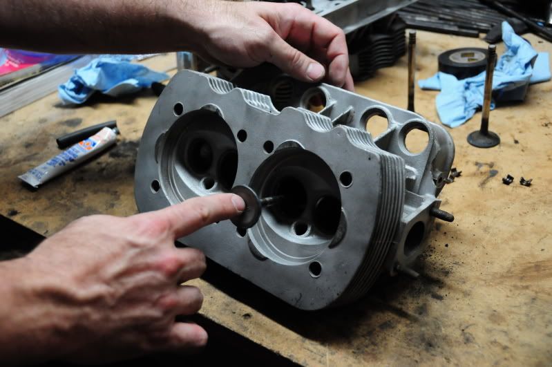

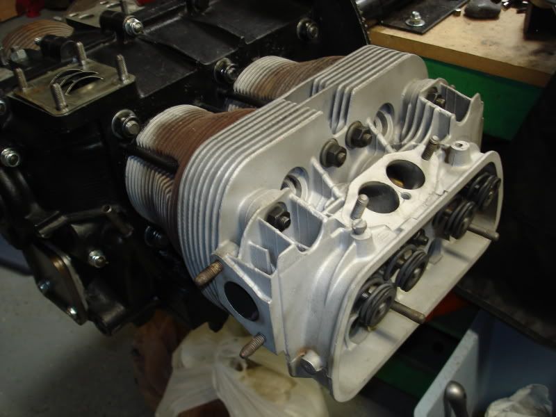

Picked up this
(Thanks Andy :thumbs: )
and took a look at the seats and the cracks are minimal, to say the least. Plus now I can really clean the valves and seats, proper like.

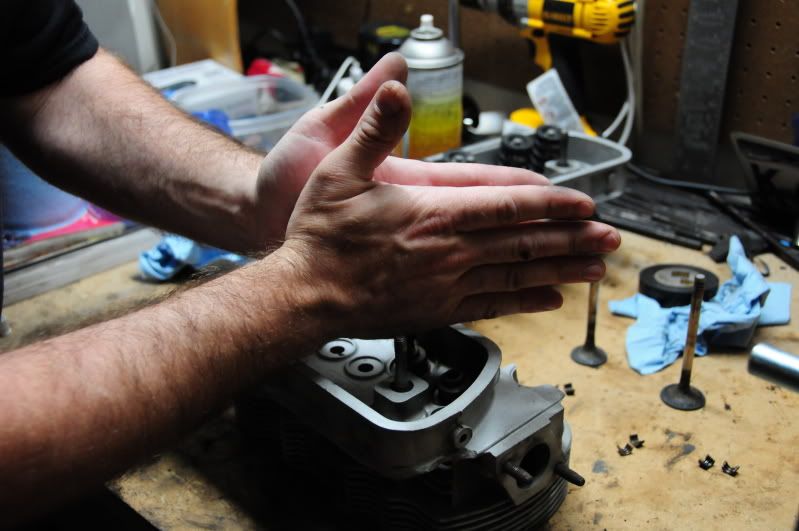

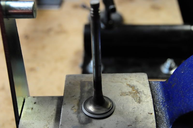

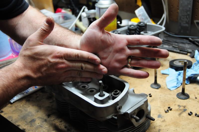

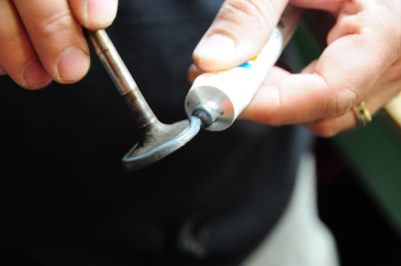

Lapped the valves tonight:
Lapping compound
Inserting the valve
Inserting valve stem into a piece of vacuum line
Lapping valve
Finished valve

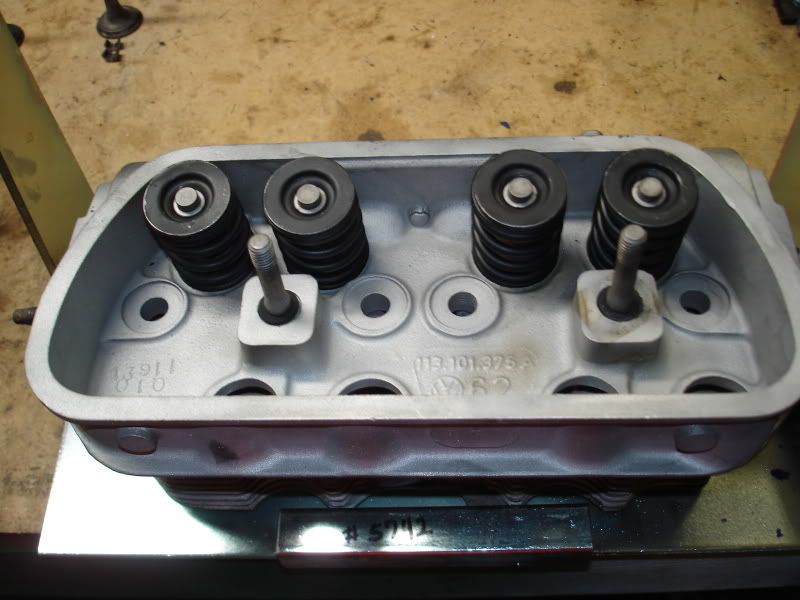

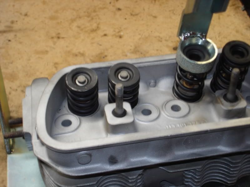

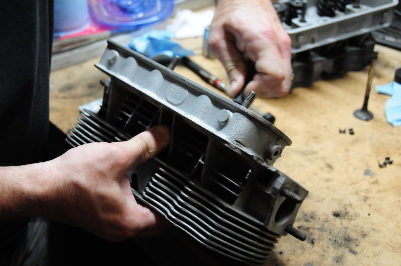

Head assembly

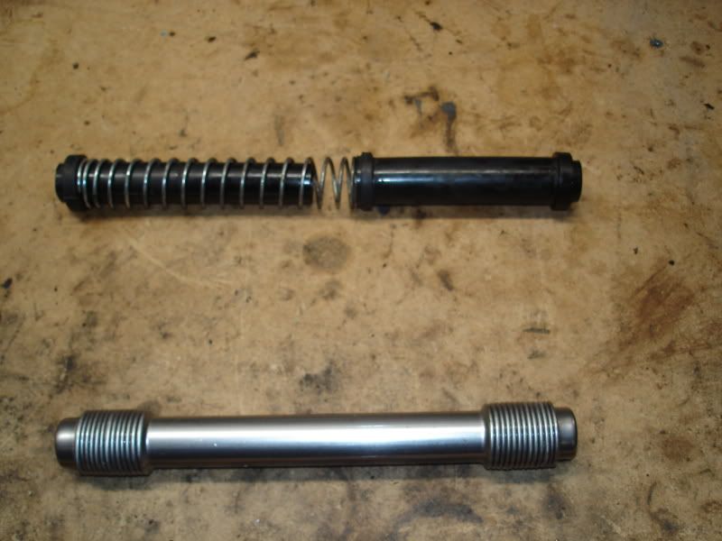

I bought some new OE pushrod tubes, then I found a set of the plastic tube and spring type in a box of parts. Would the spring type be better?
