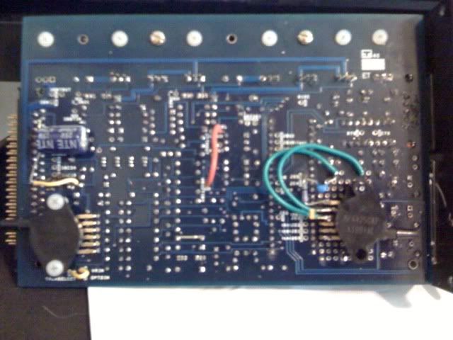

so I finally got the rest of the components to finish my barometric pressure compensation circuit(when i go up of down in elevation the fuel table will automatically compensate for the thinner/denser air, don't need it around here but I'll be taking the car to colorado for the 2012 type 3 invasion, then i will need it for sure). total cost for all the componests was $13.
on the left you'll see I added a cap to the power in for the megasquirt, hopefully that will fix the last bit of reset issues. On the right is the baro circuit.

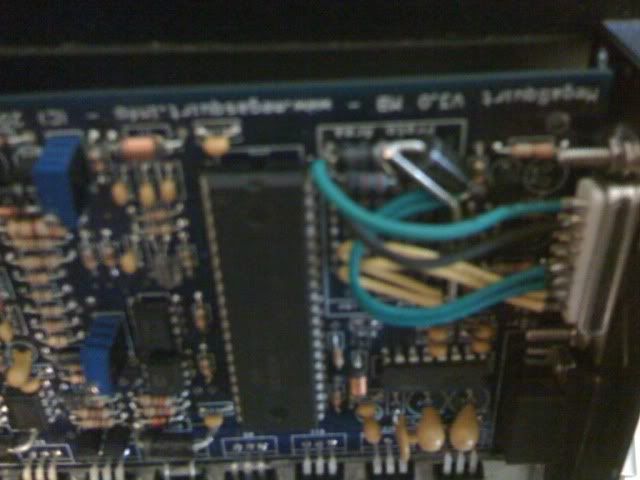

This lovely mess, hehe, is my tach output circuit, since i'm direct firing my four coils(wasted spark for now, muahaha, I have nowhere to pick the coil- from). I also added a 1K resistor on the tach's ground to clean the signal up a bit. Total cost for parts $4.
