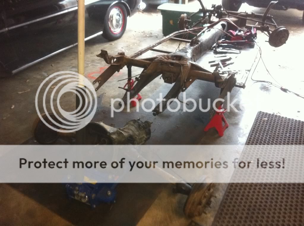

Progress!
Rear end is out. Front end is next.....
Kinda hard to find free time with a newborn

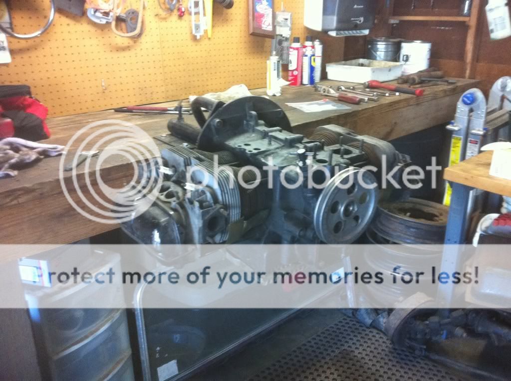

Starting on the motor!

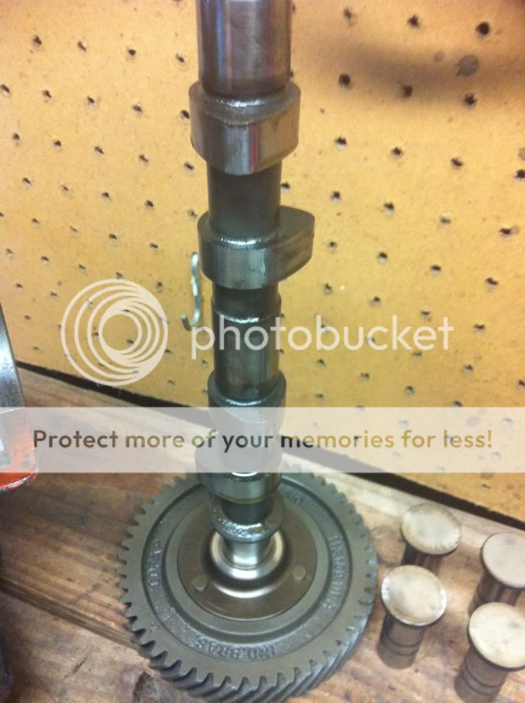

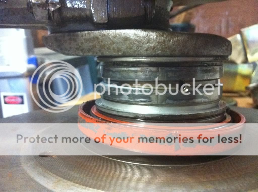

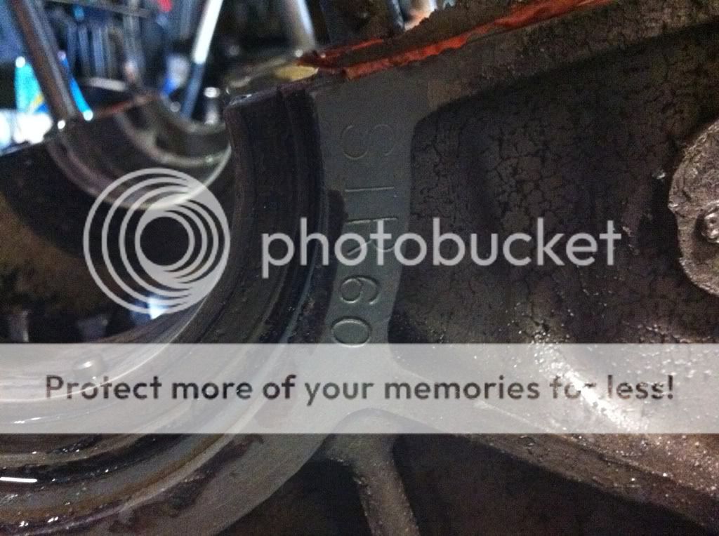

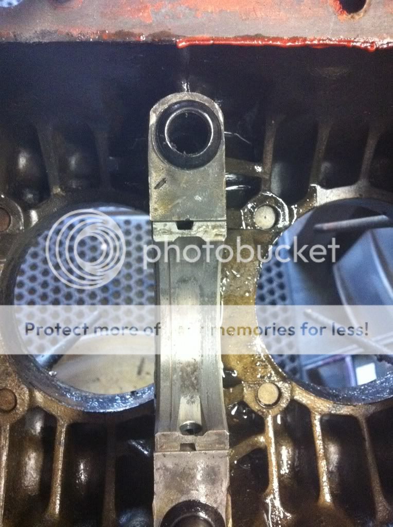

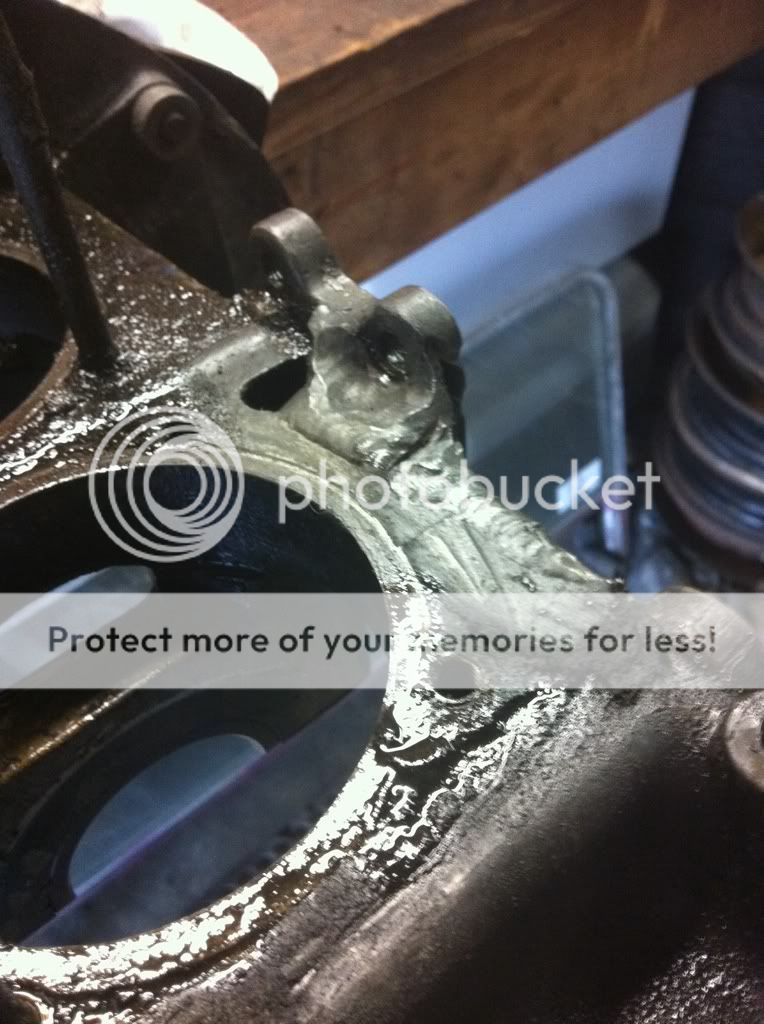

PostPosted: Sat Mar 12, 2011 12:14 pm

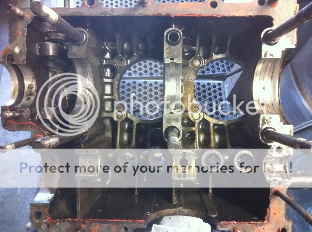

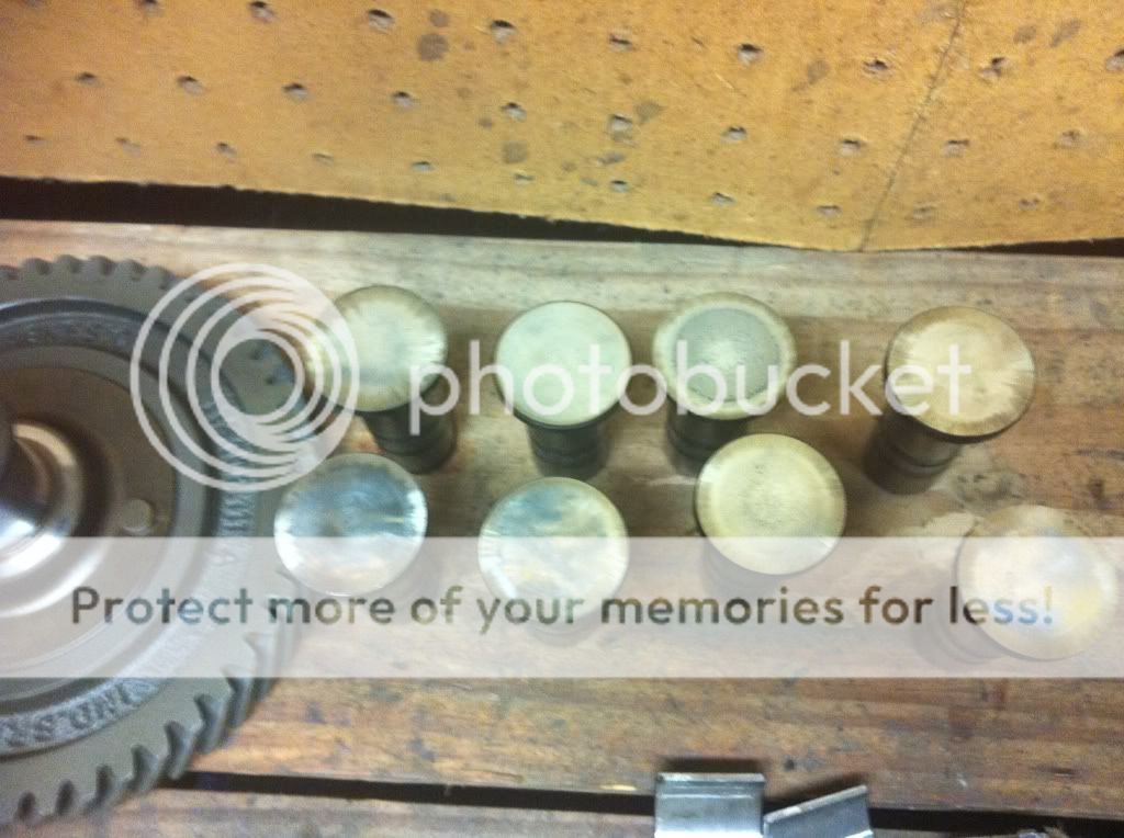

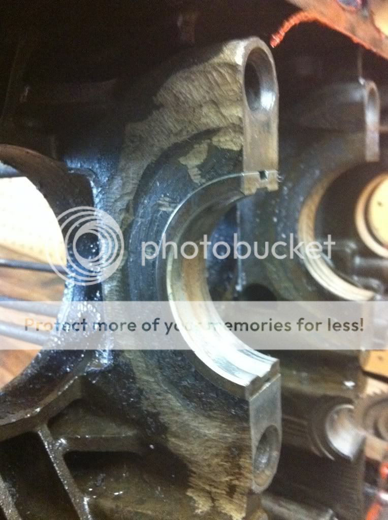

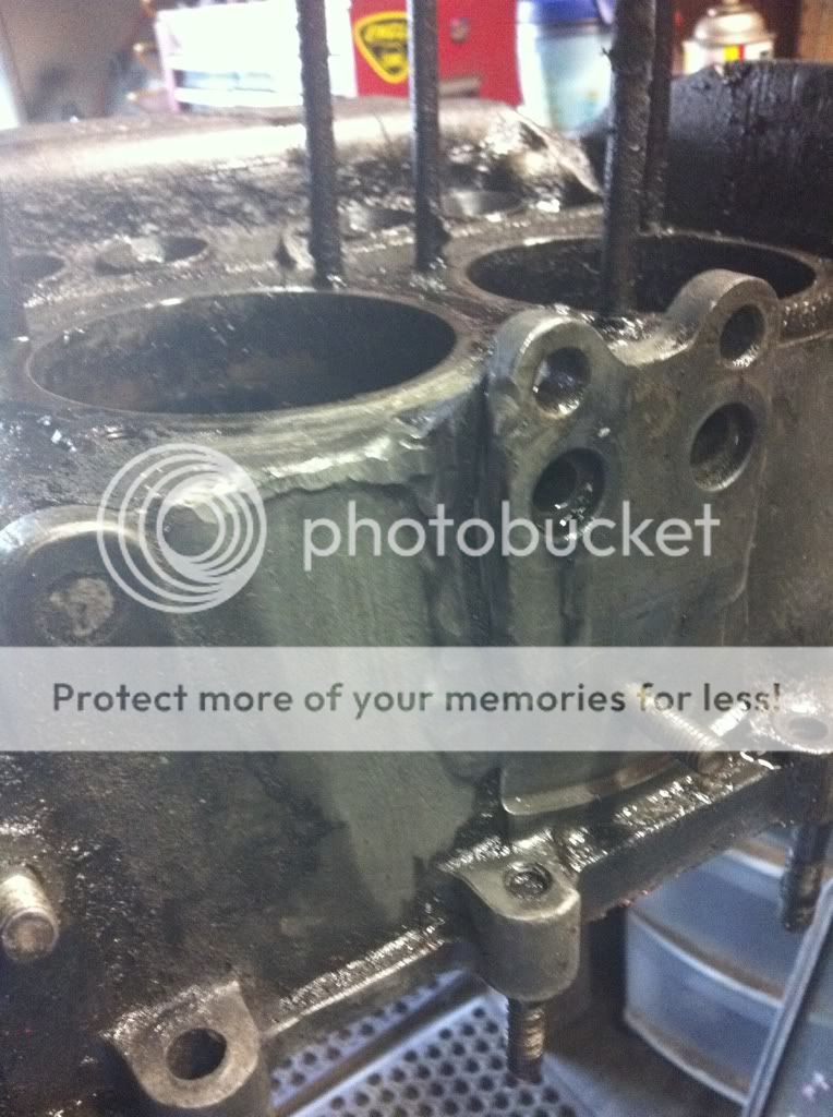

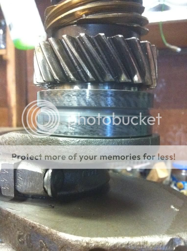

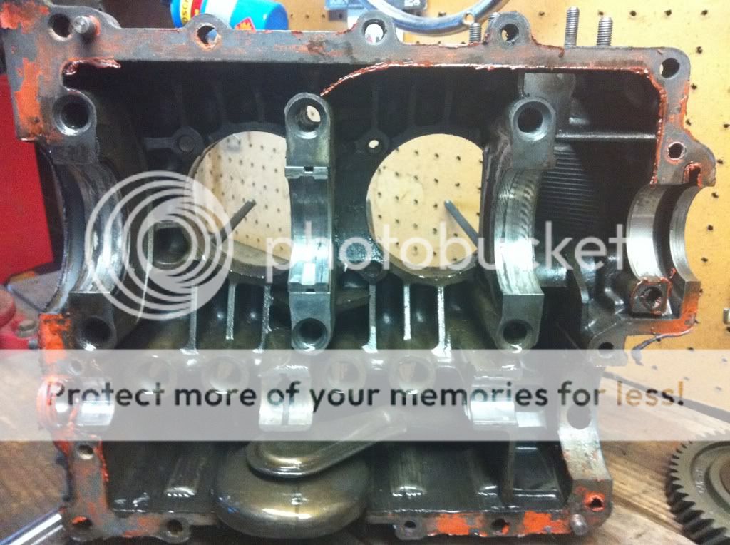

The motor is a AH case. 1600 with stock cam. Doesn't seem to have alot of miles on it. It doesn't look to be put together with alot of attention to detail. It has blue and red RTV everywhere. I'm surprised some didn't break free and clog an oil galley. Its stamped 60 on the back side of the case by the flywheel. I'm not sure if that means it's been bored 60 over or not. That doesnt seem to be a common place to put those numbers. The bearings look a bit thick to me. The internals look like they are in good shape. The cam is a newer cofap. crank is clean, rods are clean. Not alot of carbon staining. The heads are stamped GEX, but there are no cracks and they look good too. I just hope this case is usable.
I have a set of 90.5 P&Cs. Dual Weber 34ICT with a new CB Performance linkage/intake/filter kit. Engle 110 cam. If yall see something in those pics that doesn't look right let me know......
