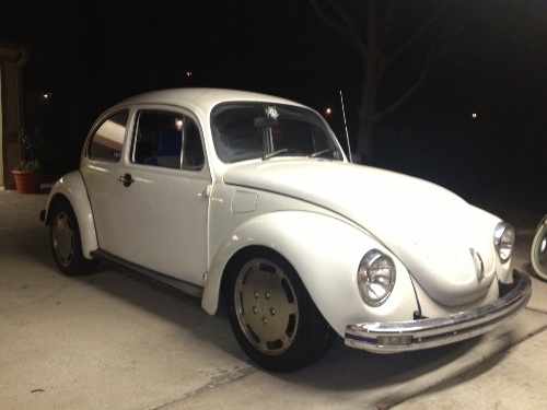

Thanks guys! It runs really strong and I end up running out of gears on the highway!
I put my new wheels and tires on last night and actually got the ignition switch to work. I drove it to work this morning. :thumbs:
The wheels are from a Porsche 928S and are lightweight forged alloy. They weigh about 16lbs each! :thumbs: Much better than the 21lbs of my previous 17" gravity cast ones.
File comment: New wheels (porsche 928S) and tires
