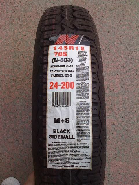

PostPosted: Wed Jan 21, 2009 9:35 am
why 145's and not 135's
PostPosted: Wed Jan 21, 2009 9:36 am
I dunno, 135's seem to smallish.
