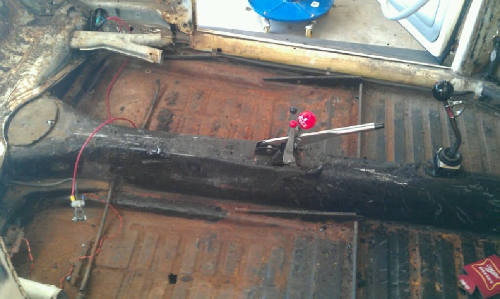

Started to gut the 67..... for the new look. Will post more pics as she progresses

 Post subject: Re: Deez 67
PostPosted: Tue Oct 04, 2011 1:34 pm
Wow! Its amazing what interior finishes can hide...

Is that a hole in the floor of tar board?
:shock:
How bad do the pans look? you just POR15 ing them or going to replace?
