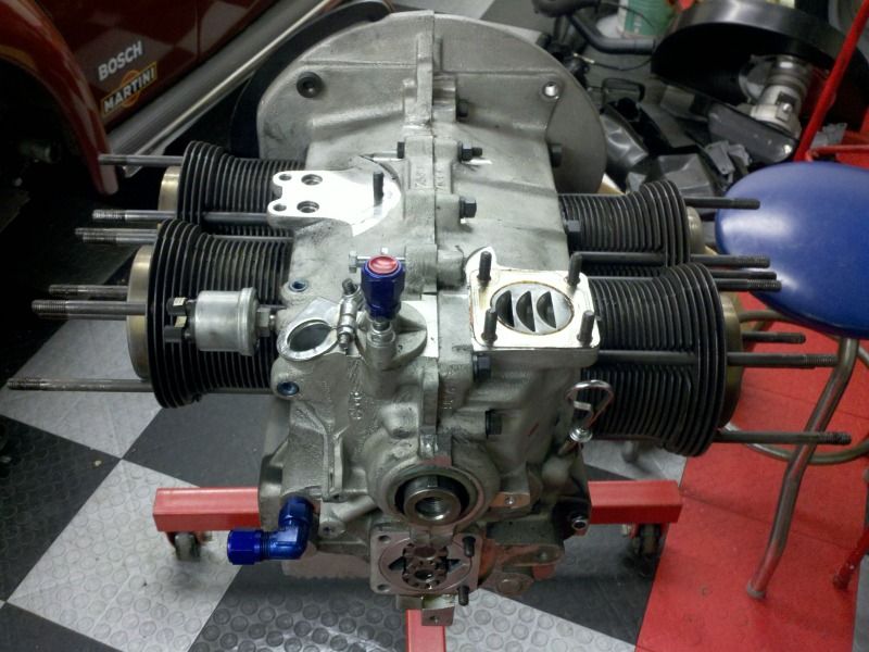

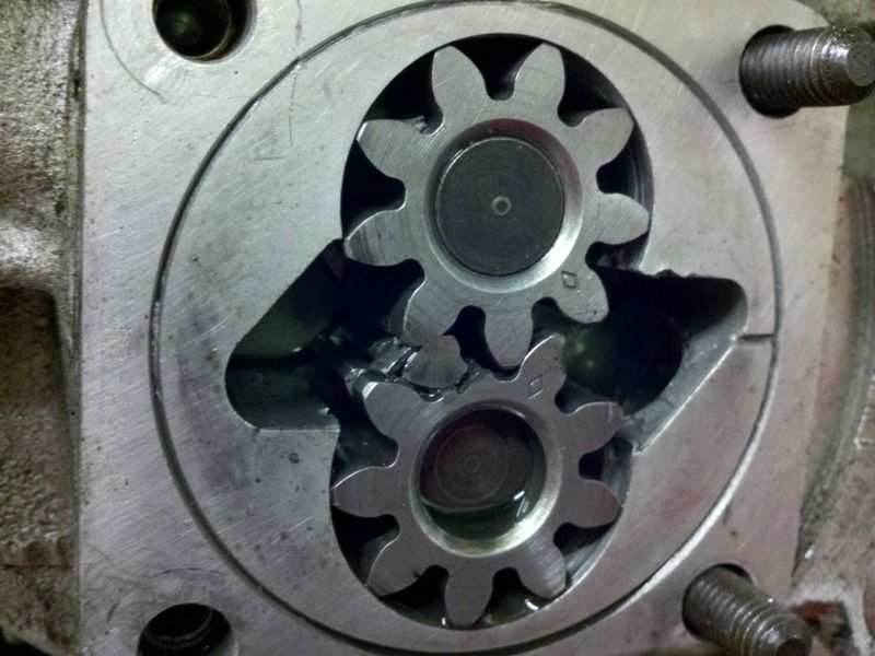

I had a couple lash caps fail and some pieces tried to go through the oil pump, lol.
I also found two broken inner valve springs. I'm going to tare the engine apart and inspect everything. My guess is it destroyed the oil pump slot on the cam too when the the pump seized. Oh well, these things happen sometime when you push the envelope...

When did this happen ... did it sieze? :help:
PostPosted: Sat Nov 10, 2012 7:20 am
That sucks, so what's next, are you going to build one of those reliable type 4 motors? w:pw
Ninja edit: How did something that big get sucked through the strainer and into the oil pump?

Probably no strainer, just a filter after the pump...
PostPosted: Sat Nov 10, 2012 9:19 am
Wayne, the oil light came on, I shut it down right away.
Nick, the oil screen is restrictive for high revving motors, I never run one.
No type 4 for me, I like making power too much. Besides, this failure had nothing to do with what type motor it is.
