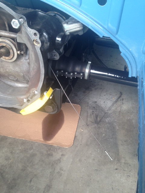

Move car little bit and the next day saw the transmission fluid leak between boots and transmission axles.. Is there any seal in there?

Transmission fluid leak between boots and transmission axles. Is there any seal or ?
 Post subject: Re: Ragtop 59
PostPosted: Mon Jun 16, 2014 10:59 am
no, the boot is the seal. Your seam should not be at that angle, but it shouldnt be straight up and down either. Loosen the boot, turn it so it's at a 45 degree angle, and re-tighten. That should do it

this is close, but the small end drooping a little too low

Thanks. Guess I need to buy different kind of clamps.

Most of the dubs I've seen drip when the car is jacked up and the axles are hanging... But on the ground they seem to be ok. Liberty bug was dripping pretty good on the lift but when we got it on the ground, it stopped.

I had one that dripped. Undid the clamp and smeared some gasket maker on the small end then resealed it. Let it dry. No more leaks.
I have done that several times. I would clean it with brake clean or alcohol first than use a little black RTV. You also got to remember not to stretch the boots out to far. I always push them in about 1/2 inch towards the tranny. If you stretch them all the way out they tend to move when the axles move up and down.
