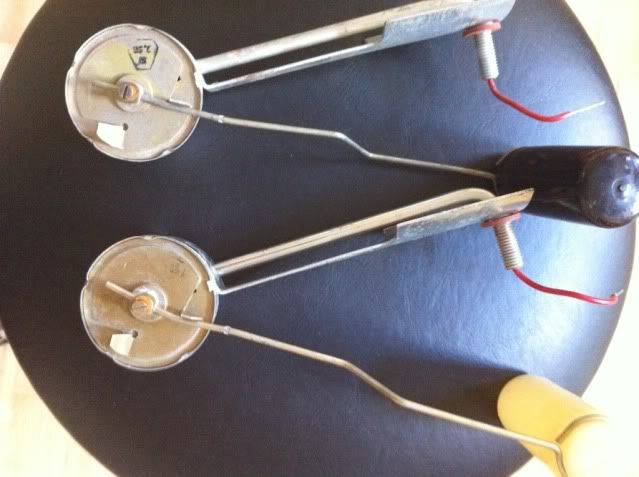

as for that float sender, I've also never seen one used on that late of a tank. Is that neck taller on the tank? I don't remember them looking like that...
I've had a couple of those senders, NOS with date stamps still showing. Yes, that wire should be much longer, there should also be a little plastic or bakelite block. Thats not the right nut for the end, I think thats actually for gauge mounting
Now, I don't have any more of those senders, or the gauge, but I do think I still have the dash piece for the small round electric VDO gauge, and the fibre screen stuff behind it. Originally, I thought it was just a hack, but the circle is perfect. Yours if you want it. I also have seen the dash grills that were stamped to have a round gauge. Been a while since I've seen one
 Post subject: Re: Ethan's 1961 Build Thread
PostPosted: Mon Sep 15, 2014 3:19 pm
and, I take that back. As you can see, mine are straight, yours is bent. I just saw another bent one, and it does have that nut on the end. Pretty rare, it must really be 61 only to fit that tank specifically
PostPosted: Mon Sep 15, 2014 4:33 pm
That block off is bad ass I haven't seen that either. I have seen the sending unit before, and have found a couple of threads on them when I was looking up some information for a friend. I did start a thread on thesamba to see how to test it, but I left it out at Jason's so I cant even mess with it. The end where the wire comes through does have some kind of shield, I doubt I use it even if it works because I don't see anyway to extend the wire there is not enough left to tag onto.
