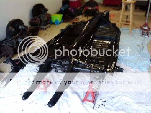

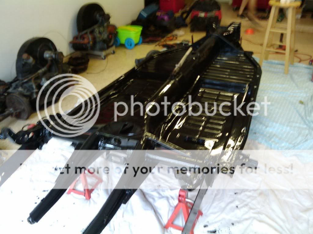

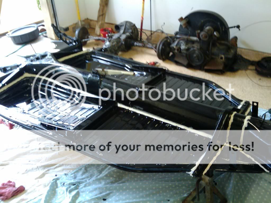

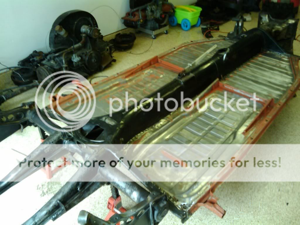

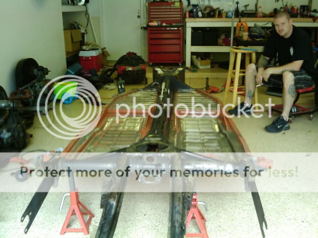

working on the pan
stripping 48 yrs worth of grime and oil from the frame horns is a PITA getting the orange coating off the new pans ranked right up there as well
First coat of POR-15
I let that dry and then added 3M seam sealer
Once the seam sealer dries ill put a final coat of POR-15 on the topside

Big thanks goes out to Jeremy for coming by and hanging out and lending a hand. I am going to let the topside dry for a couple of days then I will flip it and work on the underside. my plan for it is to put one coat of POR-15 then seam seal down the tunnel and apply one more coat of POR-15 and while it is still tacky I plan on spraying 3M undercoating .

well if you read the directions it states that you can paint over the seam sealer 30 min after you apply it. well being lazy i waited at least an hour and a half and as it dries it is shrinking to where you can see it so maybe ill let it sit over night than coat the seam sealer once more.
