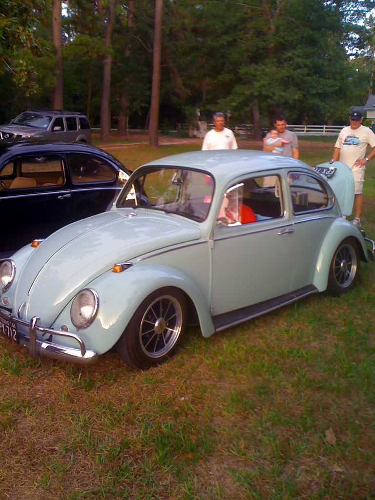

Sweet . Ben and Kostya real nice ... What is the amount that you narrowed the beam? I like the stance..
Thanks Wayne......3" narrowed with drop spindles. I think the offset on the BRM's pushes the wheels out a tad more than smoothies or maybe some other rim.
PostPosted: Thu Jul 02, 2009 12:04 pm
Ben its a big improvement... Its come along way in a years time. BRM's have a pushed out offset. Plus many dropped spindles push out the wheels an inch per side. Thats the og reason for narrowed beams. To suck wheels back in under the fenders. I think my beam will be 4inchs with a negative offset wheel. Tuckage my friend... :hillbilly:

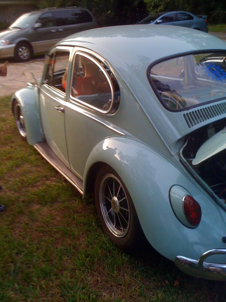

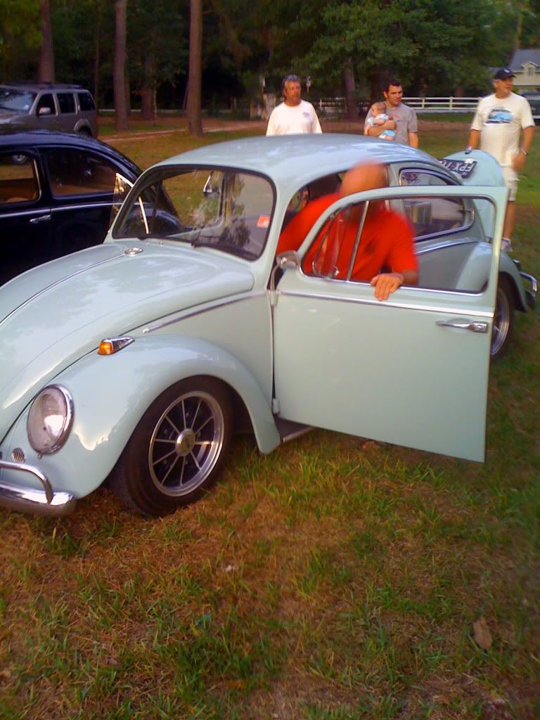

First test ride,for "Mr. BIG Motor"
PostPosted: Sun Jul 26, 2009 7:39 am
Thanks for posting the pictures Chuck. Low & fast in an air-cooled VW is definitely culture shock for me :wow: . Rubbed the street a few times leaving Joe's house. I will have to keep an eye open for rough roads. I have a few issues that I am going to have to work through but overall am very pleased with the transition.
Thank you very much to Kostya and family, along with everyone else who helped lower the 66 and add the 1835 engine. Oh, and also kudos to Eric on the fantastic job of fixing & matching the paint on the fender. It is great to have a man with your skills in dLk.
