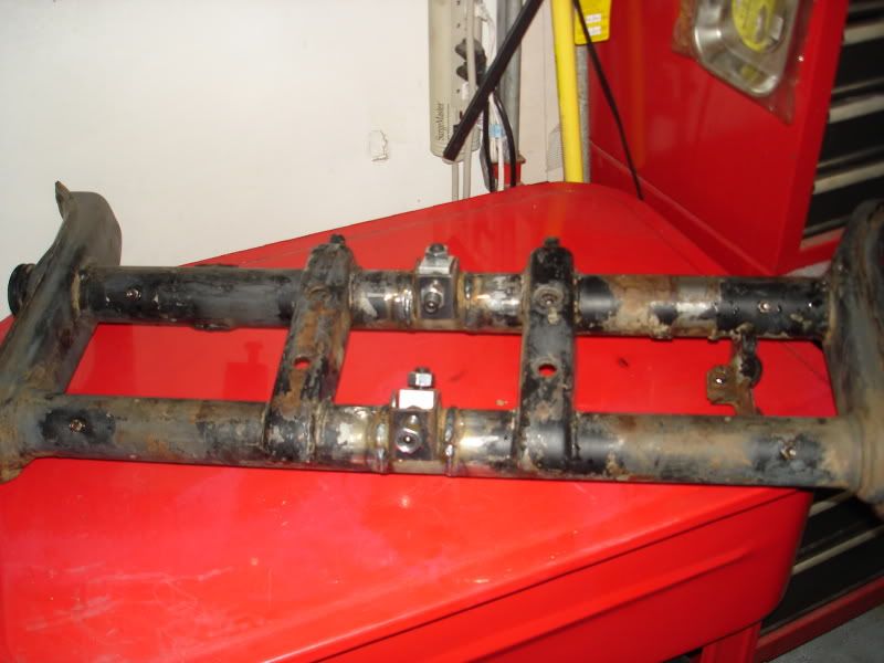

With a few issues the beam was welded with the adjusters in. Thanks goes out to James, Jeremy, Doug, and Ryan for their help! :thumbs:
Next I need to relocate the main mounts and the stabilizer and pitman arm stop.
PostPosted: Fri Nov 20, 2009 9:31 am
Chris...
do you have a side shot?
flat off the bottom is allready low???.. I had a 50/50 beam it was supposed to be 1 1/2inch from stock up or down a total of 3"s of movement.. I sold it because I was concerned of it's functionality..
I want a 2-3 inch narrowed with adjusteres but not slammed just lowered...
are there adjuster location instructions somewhere??
PostPosted: Fri Nov 20, 2009 9:38 am
tommiebsmith wrote:
Chris...
Tommie,
I can get a side shot. The adjusters are actually rotated up a tad. If you wan't to make it neutral you would need to weld in the adjusters flat or perpendicular to the beam.
You running link or B/J
PostPosted: Fri Nov 20, 2009 9:46 am
68 bug with ball joint..
I have a great spare beam and adjusters.. I just want to take the gap out of the front fender and wheel
and a little narrow would be cool also..
PostPosted: Fri Nov 20, 2009 10:03 am
I would definitely go 3" in your case. Take a look at James' (CousinIt) ride. He is running 3" on his '67 bug.

PostPosted: Fri Nov 20, 2009 10:08 am
Nice.... 3 it is!!
Thanks Chris!!
