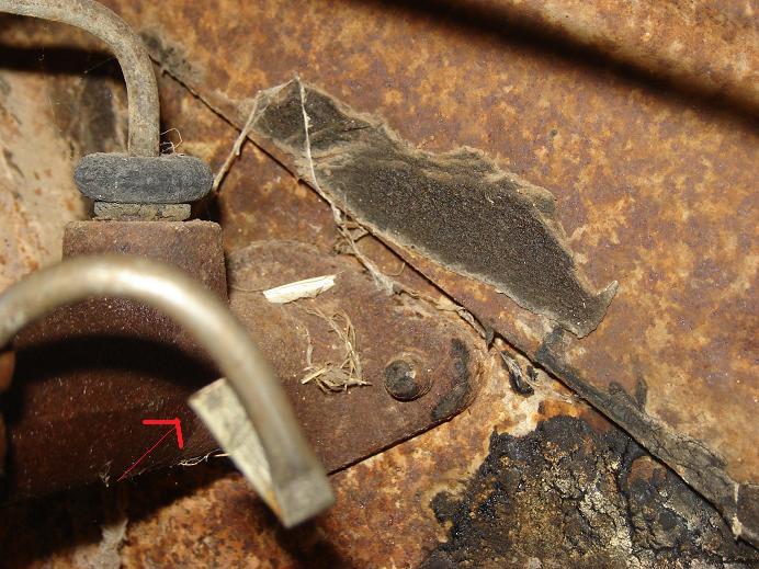

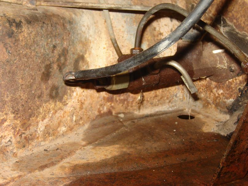

Pics where the brake line was crimped

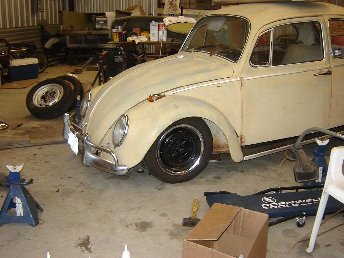

Beam is in, just need to go to Ryans and finish the tie rods... I got the rear taken apart to lower the rear. Hopefully I will be running soon... Drive it like I stole it. The front doesnt look that low, it bottoms out when I step on the front bumper.

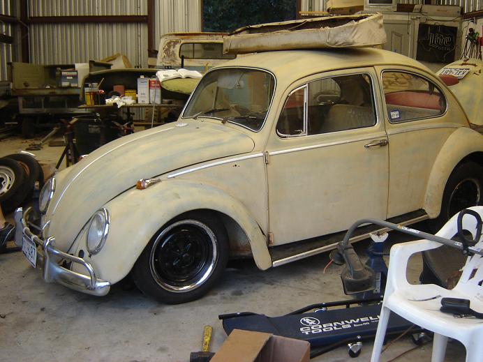

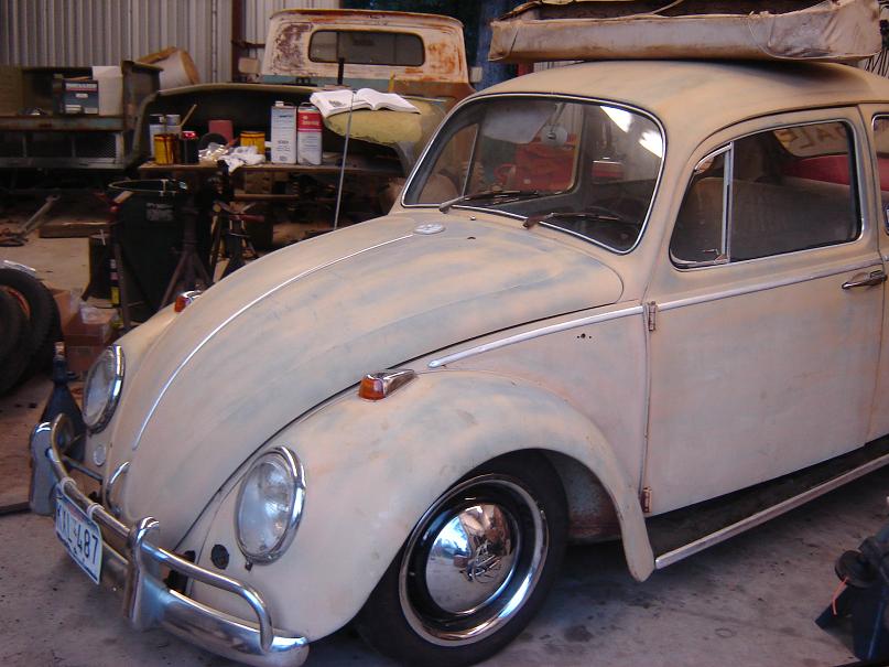

more pics
