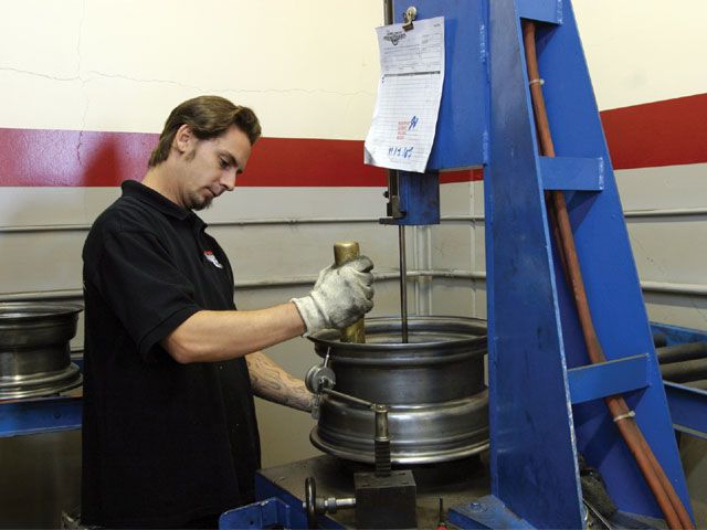

Here is the machine that Wheelsmith Steel Wheels uses to re hoop their HOTROD wheels. not something you see in most home garages. but to me seems like their wouldnt be a machine needed or made for that application if it was just a matter of cutting and welding a center in.
my 2 cents

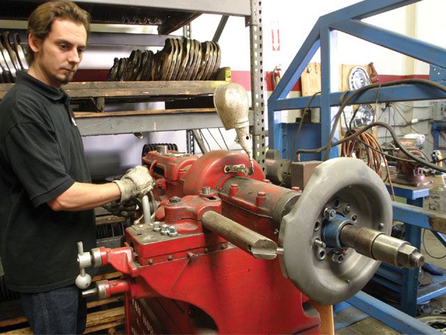

This is for Billy. yep just like a motorcycle wheel they have a big trueing machine before its welded in.
