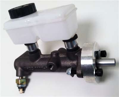

Thanks Mik I have doing some research I am going to change the master cylinder and upgrade to a duel circuit I found a kit that has the spacer longer bolts. Does any one have a power bleeder

I have a power bleeder and an extra one of these kits that I'm not using. Just needs new reservoir to cylinder seals (seals the little black seals, have the reservoir). Mine doesn't have/require those silver spacers between the reservoir and cylinder either.

I ordered the kit this morning hope to get by Friday
