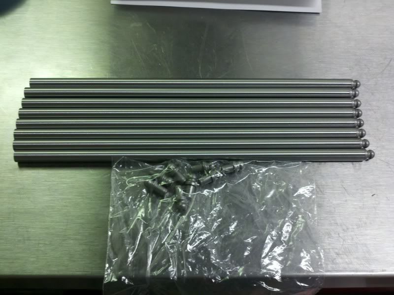

My old "plain wrapper" push rods weren't up to the task before, the tip on one came loose, so I upgraded to some Manton PRs. These should do the trick

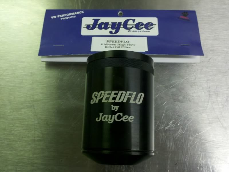

Also, apparently some crap was making through my old oil filter, which was a rebuild-able billet filter with a 30-micron mesh. Just to be safe, I upgraded to Jack's new Speed Flow filter, that has an 8-micron replaceable element. See my review here --> viewtopic.php?f=15&t=5608

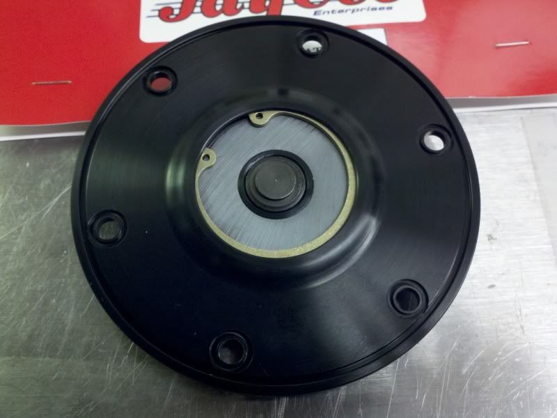

And lastly, to keep any rogue ferrous metal particles out of the system, I got Jack's new Mag Plate sump cover that has a huge magnet in it. See my review here --> viewtopic.php?f=15&t=5609

Nice new goodies! I like the O-ringed sump plate...

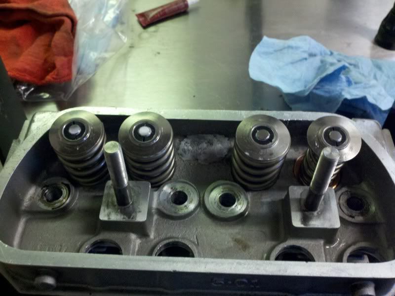

Got the heads together last weekend, didn't have time to work on it this weekend, too busy w/ mini-Brian...
In Case you're wondering, I left the outer spring off on that one ex valve on purpose for setting up the rocker geometry. No point in pushing against 400+ pounds of spring when figuring out PR length ;)

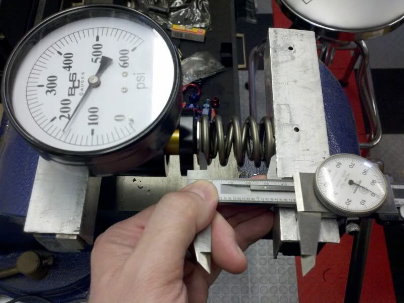

I set the springs up at about 167# seat and 413# nose, should control the valves pretty well to 8k or more, especially considering the 7mm stems and Ti retainers. We'll see...
I'll post a how-to in the engine section on setting spring pressures... ;)
