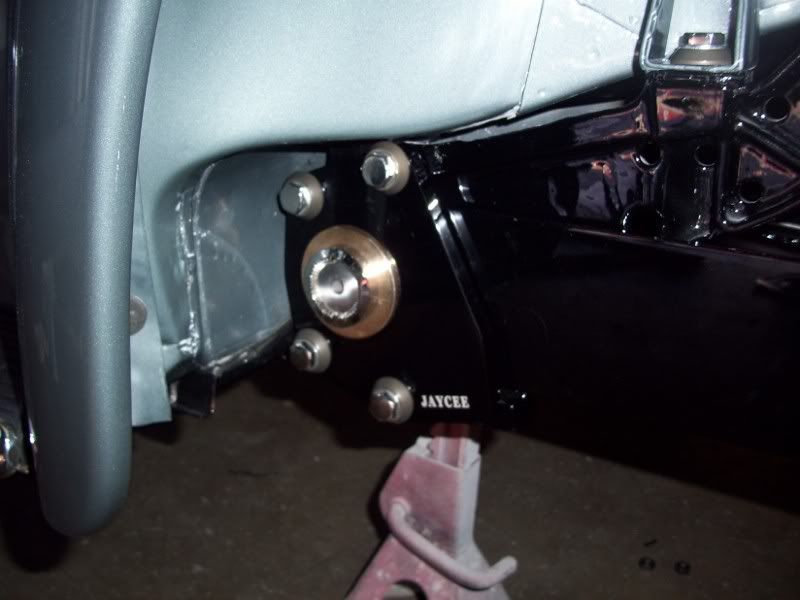

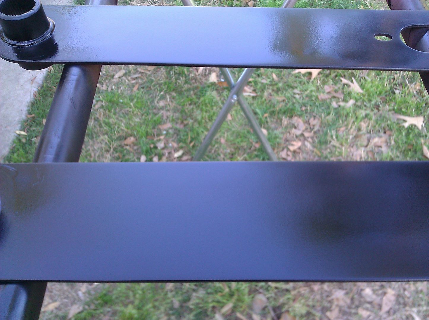

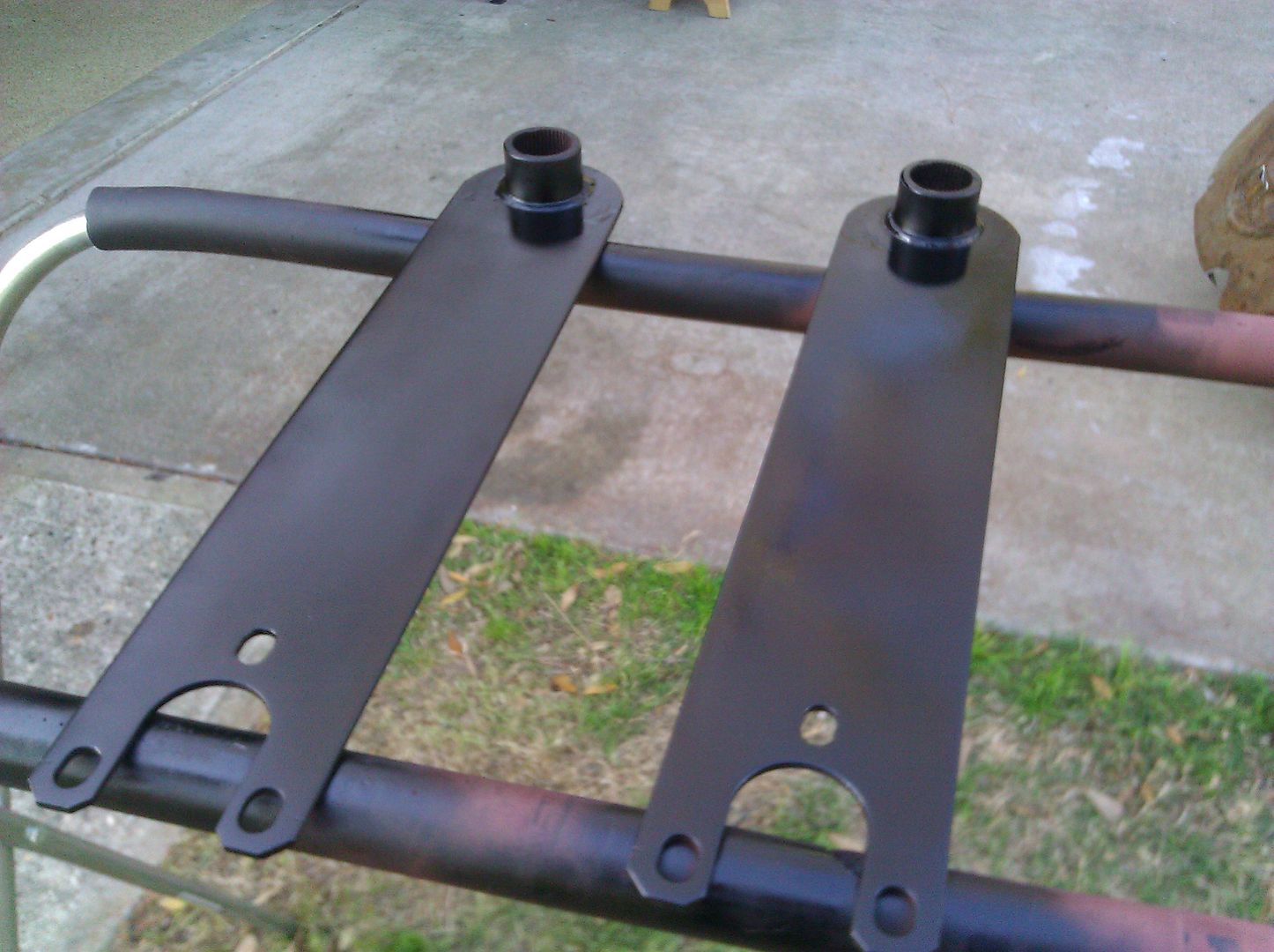

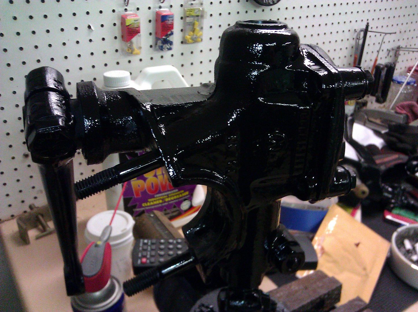

and a few more
Satin finish

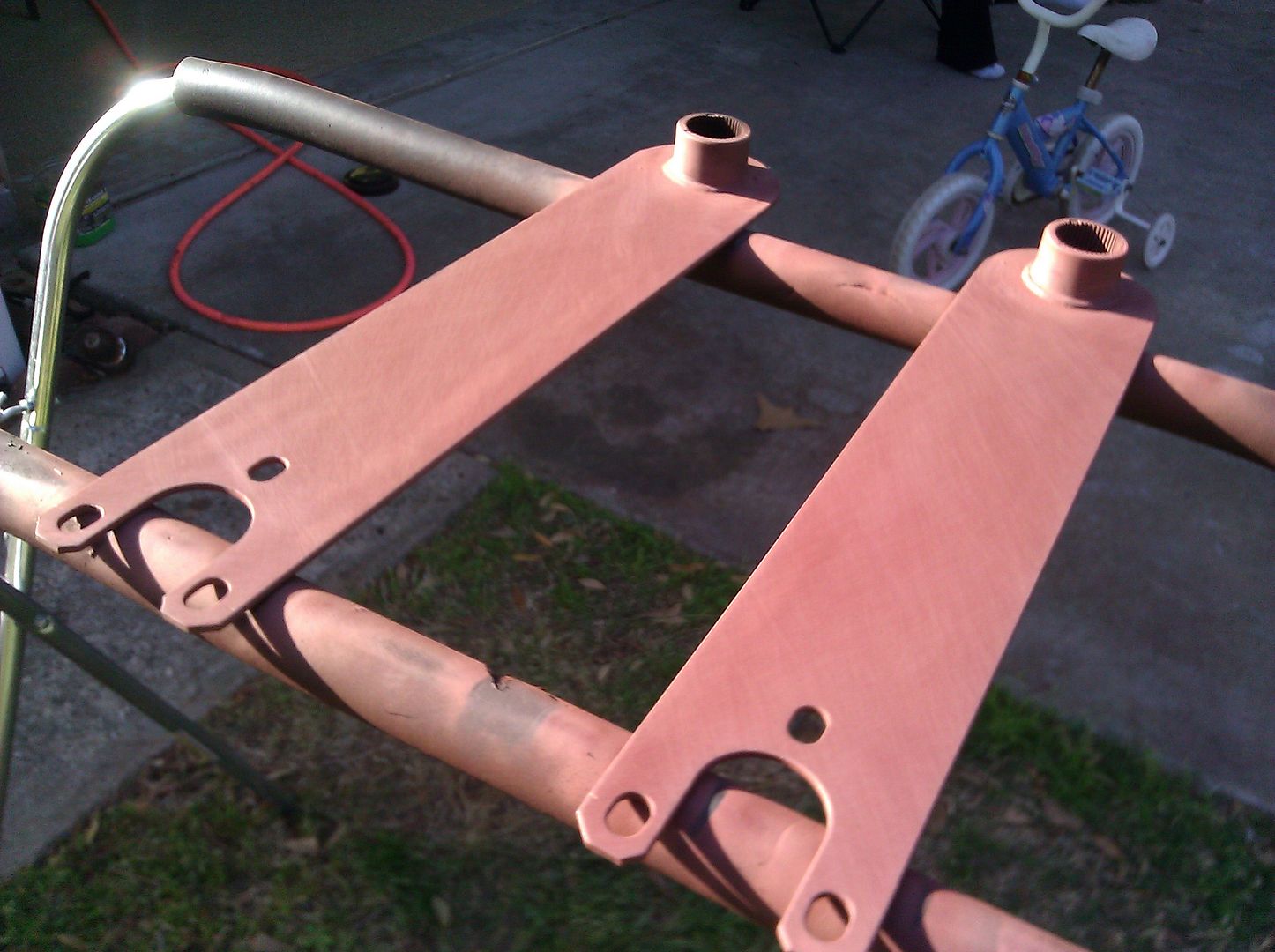

Eliot, did you spray POR on those parts?
 Post subject: Re: Eliot's 62 Green Twinkie Vert
PostPosted: Sat Mar 12, 2011 9:28 pm
All the POR-15 was put on with a brush.

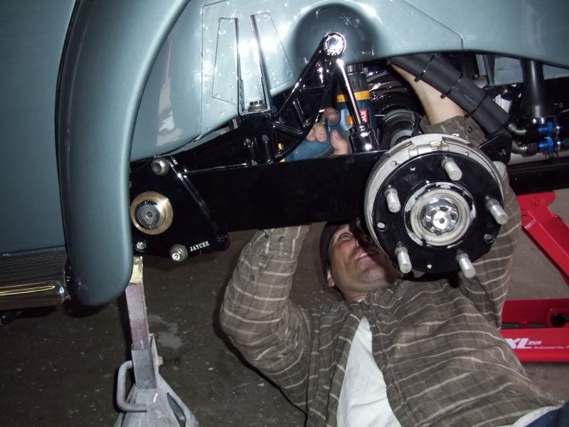

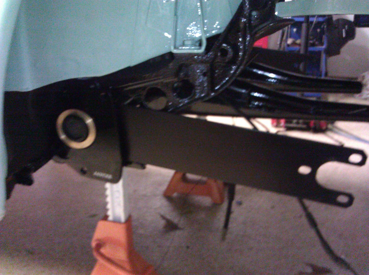

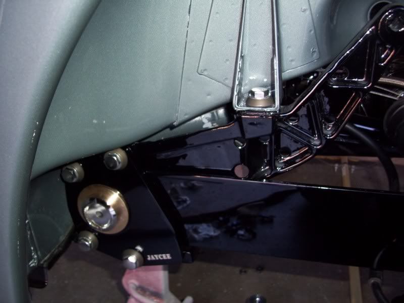

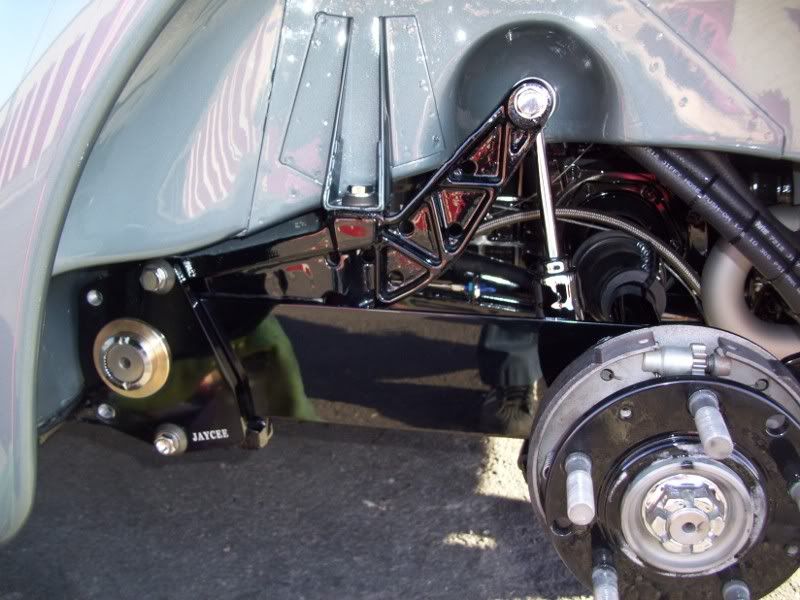

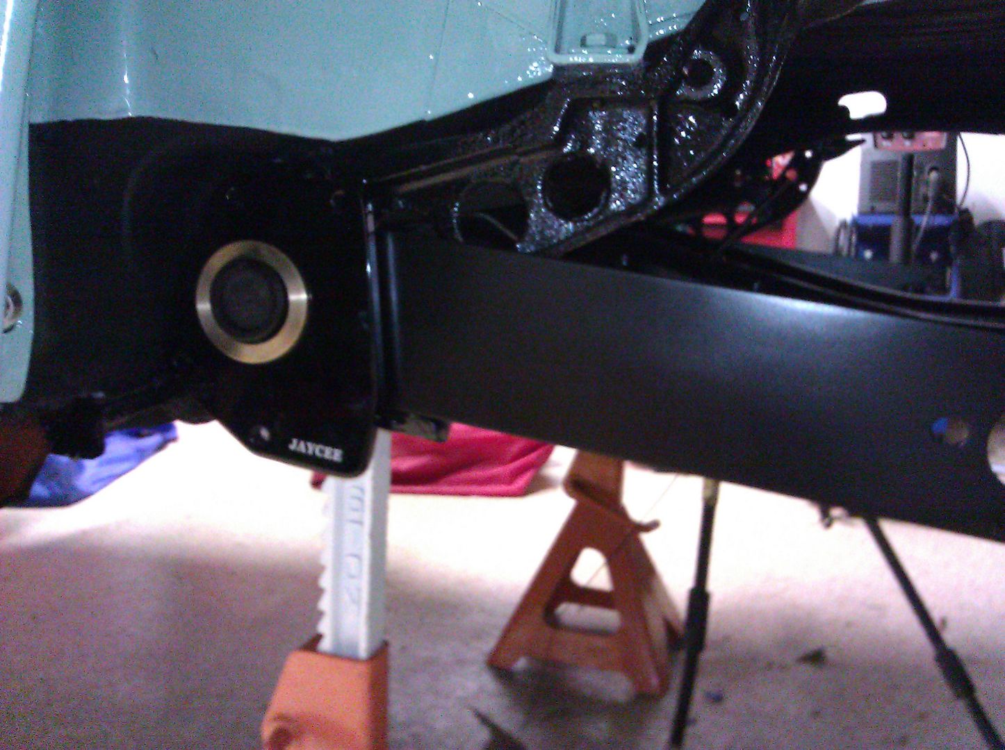

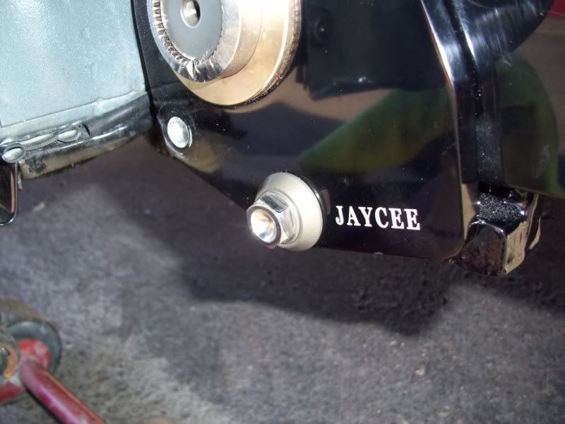

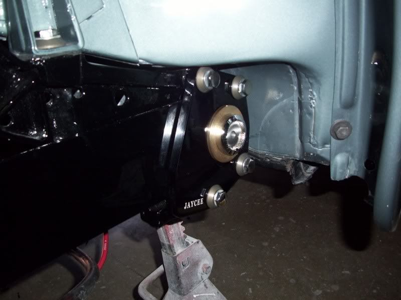

I am curious to how Buddy did these Jaycee spring plate retainers it looks like the end of the spring plate that goes around the torsion bar is chromed as well as the tip of the torsion bar itself.
here is Eliot's 55
here they are on the vert

Another note on the Jaycee spring plate retainers. They don't allow for the outside rubber bushing. I have looked at these many times and never even thought about it before. Its just metal on metal
 Post subject: Re: The Green Twinkie
PostPosted: Sun Mar 13, 2011 2:15 am
Also notice the big difference in size of the spring plate on the 55 and the spring plate on the vert. It doesn't even come close to filling the gap in the brass bushing.
