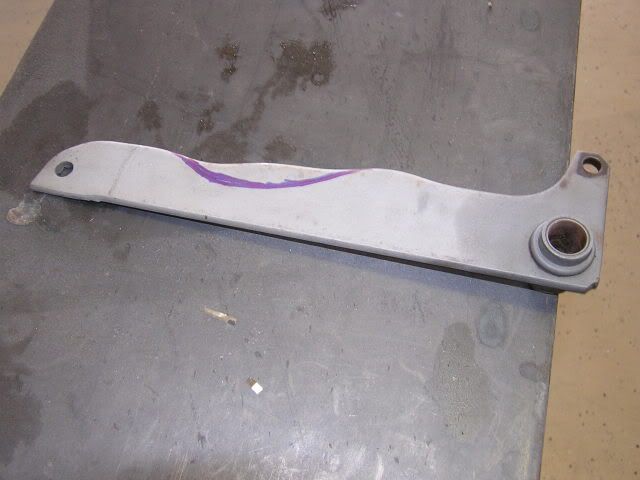

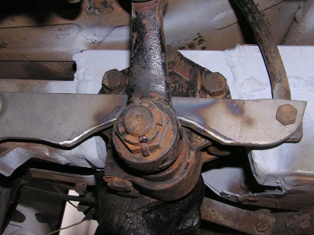

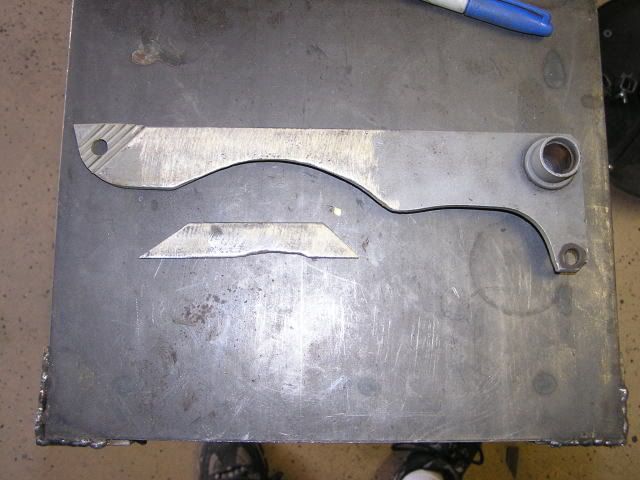

What about the notch in the arm for the brake pedal? Wouldn't I have to modify it quite a bit too.? Don't you have some pics of what you did on yours Jeff? I'll try to go back on your thread and find them.
 Post subject: Re: '59 DC Bus
PostPosted: Thu Dec 03, 2009 2:40 pm

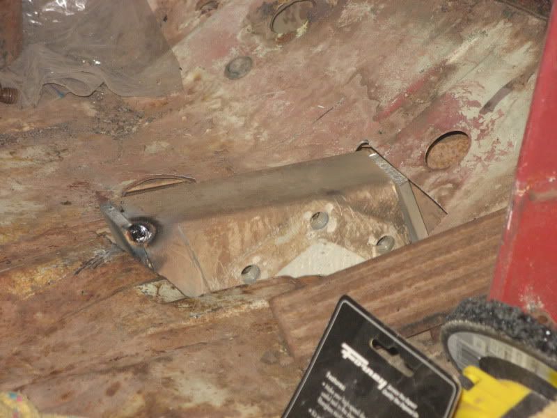

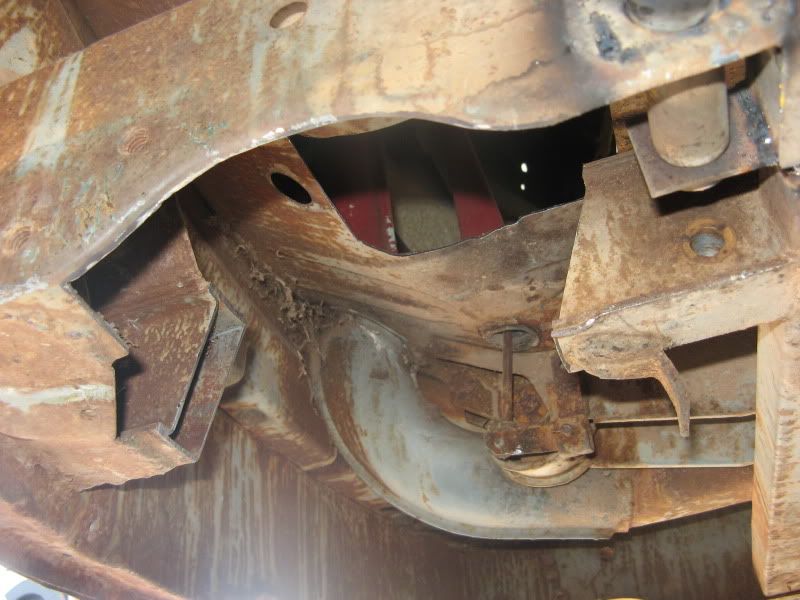

Yeah Eric, I cut mine at an angle too. Steering column lines up perfect where it meets the dash. Also to answer your question about the brake pedal. Yes it has to be notched, and the amound depends on how much of a raise you do. Jeff reinforced his on one side to compensate. Here is a pic from my bus to show that there is an angle to cut on the steering box raise. (I went up a full 3" on my raise that is why I had to cut the floor. If you go up too much you will have to bubble the floor for the pitman arm)
PostPosted: Thu Dec 03, 2009 2:44 pm
Oh and one other thing. Cut far enough back of the back bottom bolt on the frame. If you dont, you may not be able to get the bolt in there. You dont really need it since there are 4 other ones.... That is probably why the person in the pics of the one you posted went straight up with their cut. :thumbs:

Brake pedal
