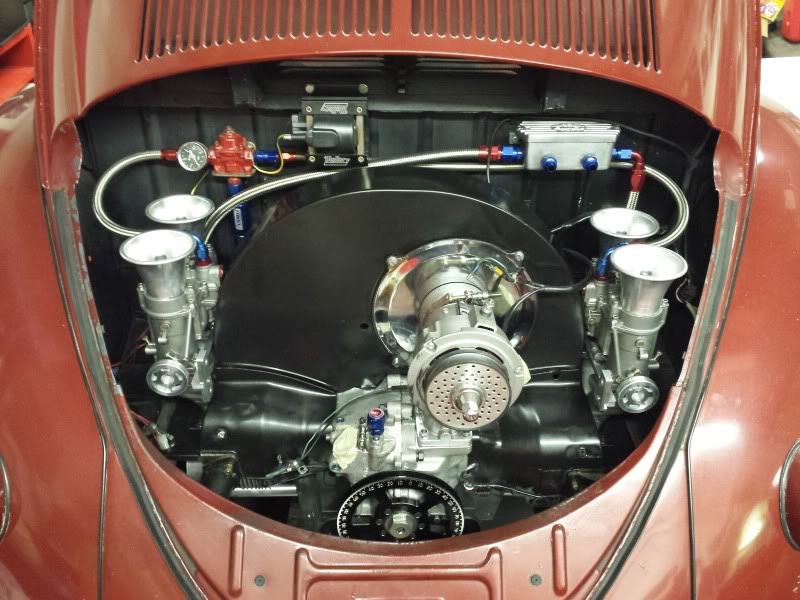

Drained the oil, adjusted the valves, torqued the heads, and pulled the last couple things off the long block, then stuffed it into the car. Got the header bolted on, still need to tighten it down. At this point its pretty much just a matter of bolting everything back on the engine. I also need to run the new throttle cable and housing for the Sync Link throttle linkage.

PostPosted: Thu Aug 01, 2013 12:25 am
Little by little, it's getting there. The carbs and manifolds are not bolted on, they're just sitting there. I wanted to start mocking up the Sync Link throttle linkage. Looks like its going to be pretty sweet. It should be easier to sync than any other type of linkage and stay synched regardless of engine temp. We'll see

Looks Great :thumbs:

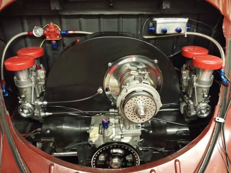

PostPosted: Tue Aug 20, 2013 12:36 am
Almost there! Manifolds and carbs are all bolted up, a major PITA on this car. Main things left now are the Sync Link and the distributor. I'm expecting the throttle cable to be a bit of a pain, but we'll see. I hope to fire her up this weekend and if all goes well take her for a spin!
