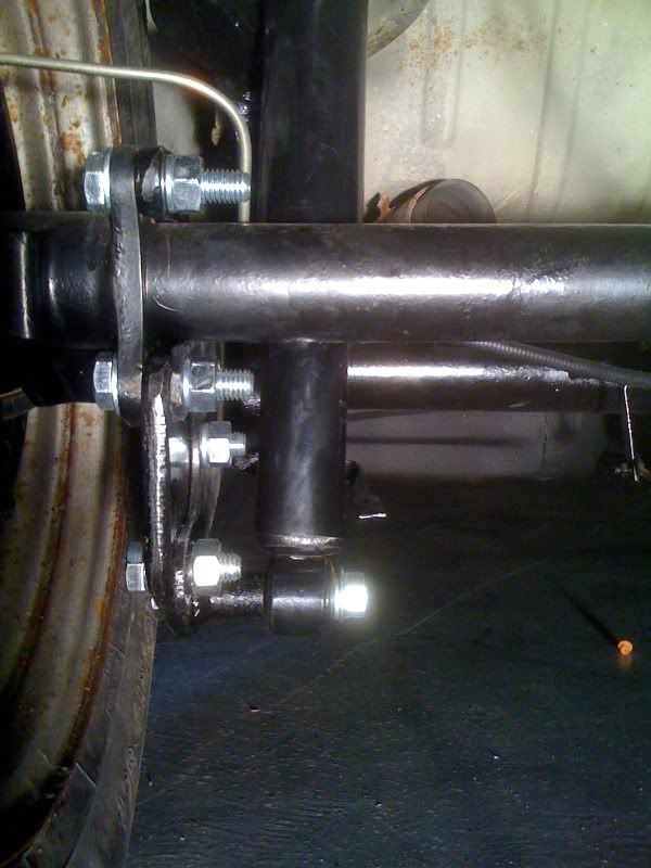

Here is a shot of the plate installed

Thanks for the picture Chris. Looks pretty cool!
Out of curiosity I measured the location of the bottom shock mount on my car in relation to the axle and compared it to measuring off Chris's picture. My shock is actually about 8% (+ or -) further from the axle than the picture Chris posted. So in reality the shock is basically in the same place in relation to the axle with that kit as with a stock shock mount. So there is no difference in shock travel as far as I can tell. :P
Edit: After looking at Chris's picture more, and after measuring my car, I believe the reason they have you cut off the stock shock mount is because the stock spring plate would be in it's way and you wouldn't be able to bolt the shock up. It looks like they tried to put the shock as close as they could to the stock position with respect to the axle. It's a pretty cool design! 8-)

Looks like it's more about spring plate angle than shock travel.
I dont think you get the picture at all. when you lower your car by the splines the shock gets compressed which leads to less travel which is why they sell lowered shocks. with the drop plates the distance from the upper and lower shock mounts are the same as stock there fore you have the same travel as if the car was at stock height. You should see the postion of the stock mount as compared to the dropped plate.the stock lower mount is about 1 and 1/2 inches to the right (before you cut it off)
