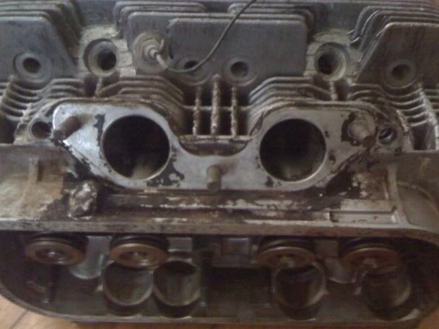

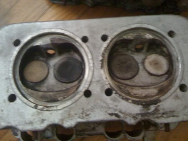

Here is why I have been a little stingy about my gas money, I scored a set of good Porsche 2L heads.
I wish I had these bad boys about 7 months ago so they could have gotten rebuilt instead of my lil 1.7L heads.
My 1.7 heads have 38x33.8mm valves, these 2L heads have 42x36mm valves. the combustion chamber is different and the spark plug is at a better angle(i'll have to hack up my engine tin to accomodate), also the intake ports are so friggin big the intake has a 3 bolt flange instead of a 4 bolt flange like on all the rest of the t4 heads. I don't think i'm going to run these heads on this motor, the next motor i build will be NASTY and will need these heads.

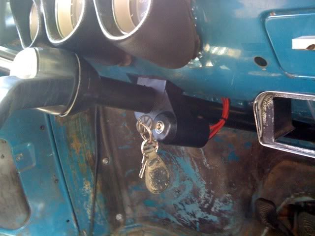

Thanks Boom for Dug Bug's turn signal switch :dance:

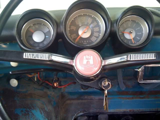

I still can't get over that horn button! :lol:
PostPosted: Fri Jul 15, 2011 10:14 am
that horn button is awesome!
So my notch is a one key car now, yay me! :dance: I added a couple of degree's of timing and that awoke a sleeping giant :thumbs: I talked to a local tuner, one of best in the country, and he made a few suggestions. I'm taking his advice and adding a large collector for all the vac lines, he said that will make it run super smooth...I'll find out today, had to wait for the jbweld to dry. :hillbilly:
