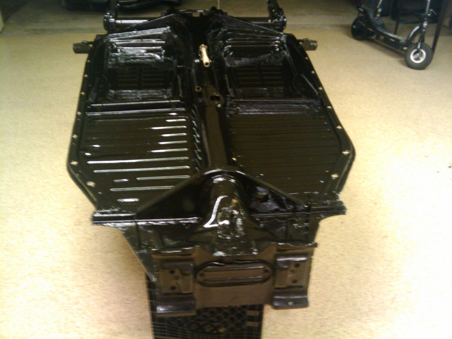

Although most everything on the pan is going to be covered with carpet ect.. I decided on doing one more coat of por-15

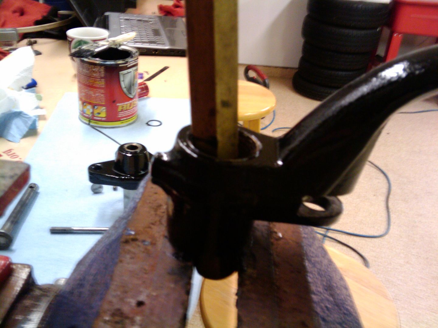

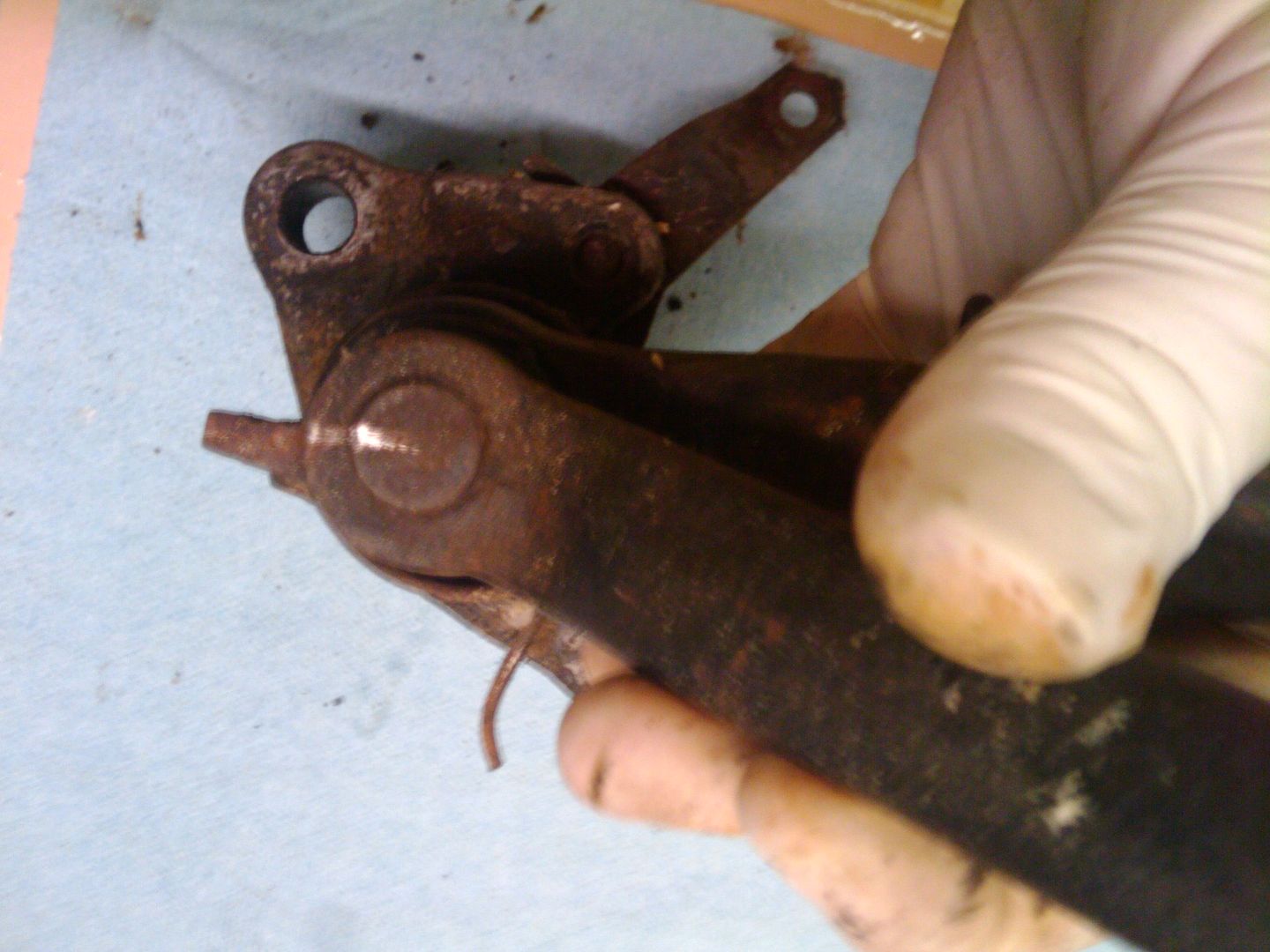

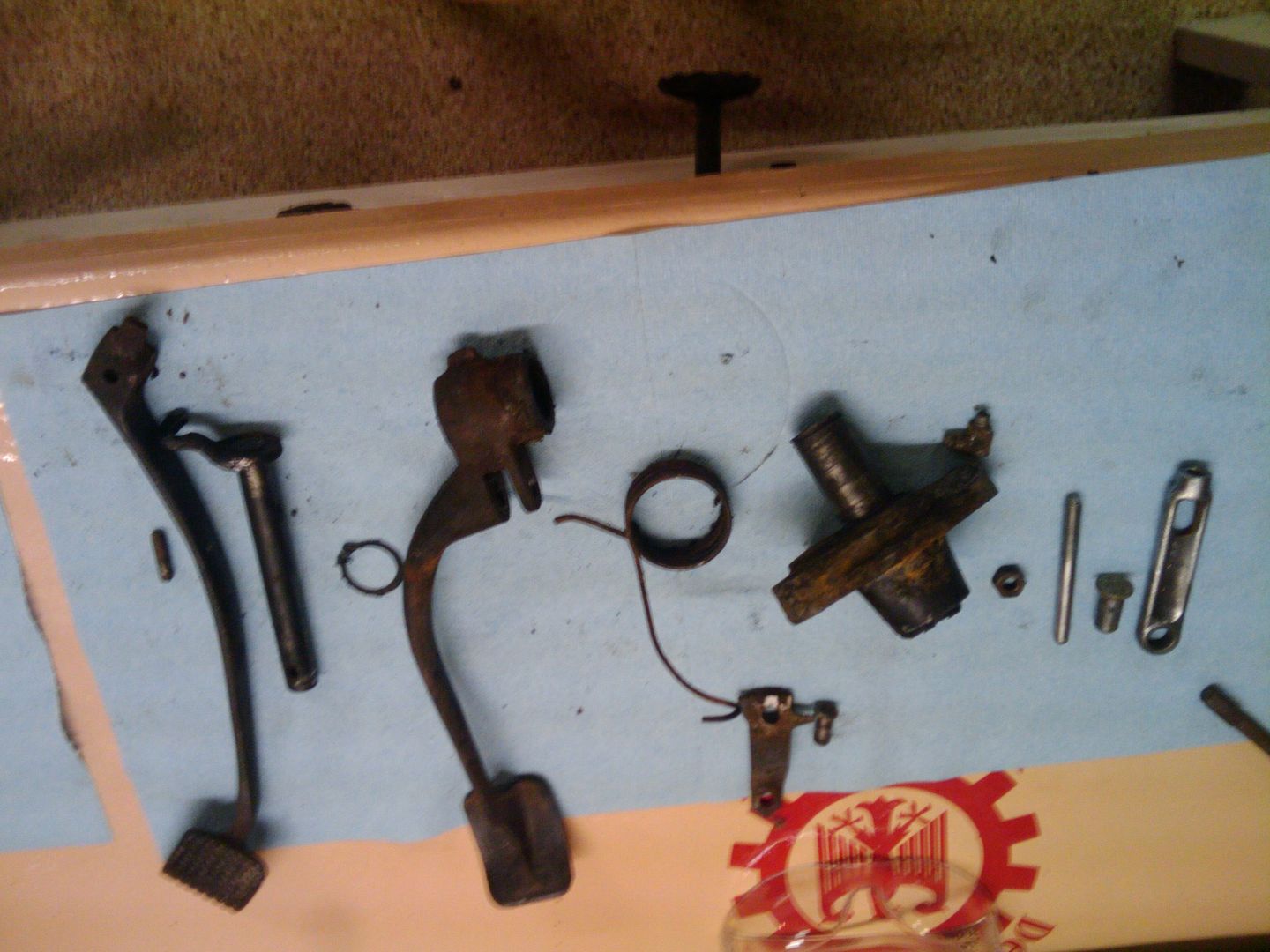

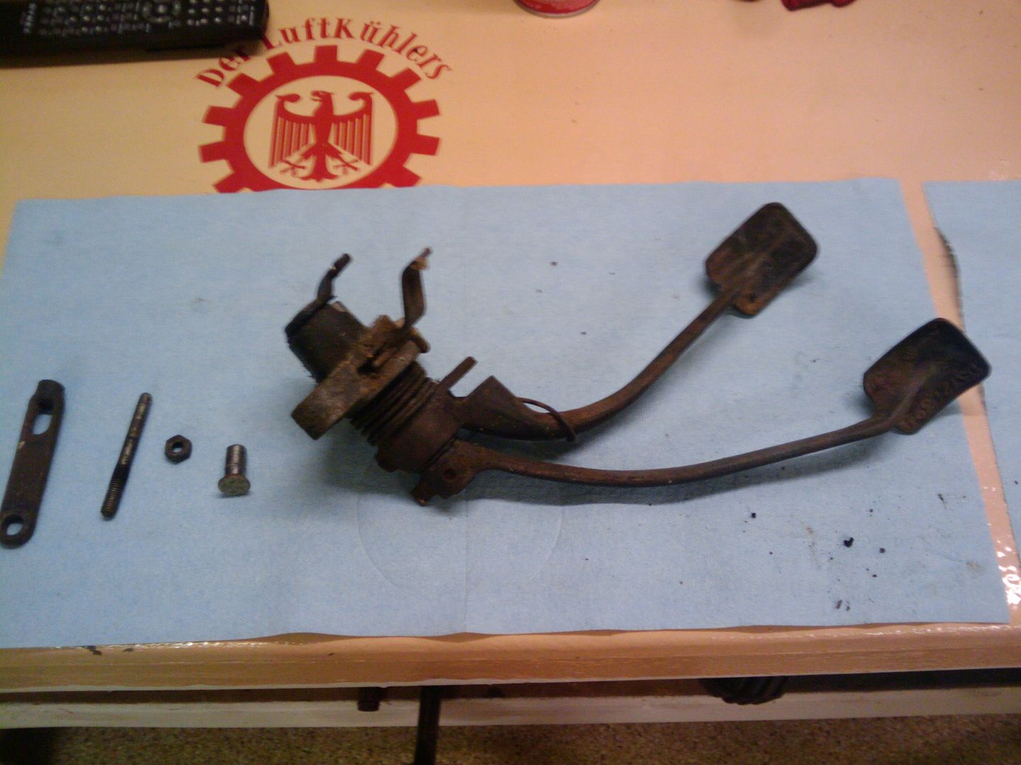

well to start out, due to the fact that I was not sure how the pedal assembly came apart I went ahead and notched it for aliment later on.
Only one pin holds the clutch pedal onto the shaft, but it was rather hard getting the clutch pedal off the shaft once the pin was removed, I ended up locking the end with the hook in my vice and was able to twist it off with a fair amount of force. I did bugger the hook up a little I should be able to straighten it out though. Once that was off there is a c clip that holds the brake pedal. That was hidden under a lot of grease.
This first picture is in order of how I took it apart.
and some close ups. this is more for me in case I forget

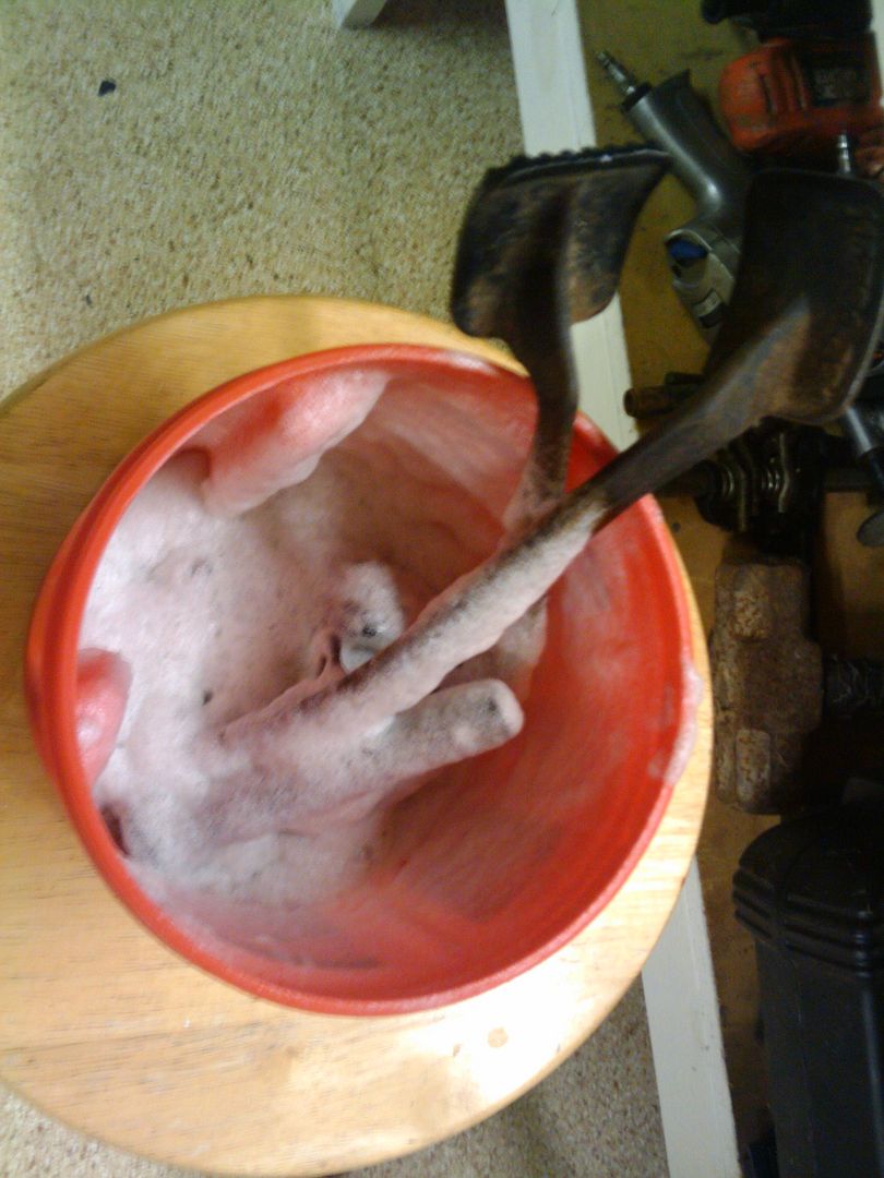

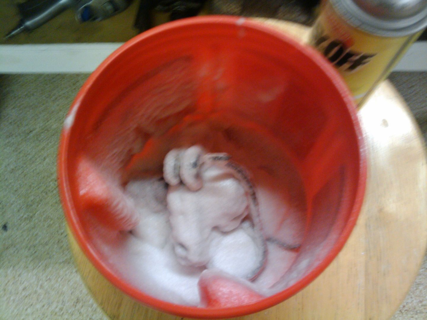

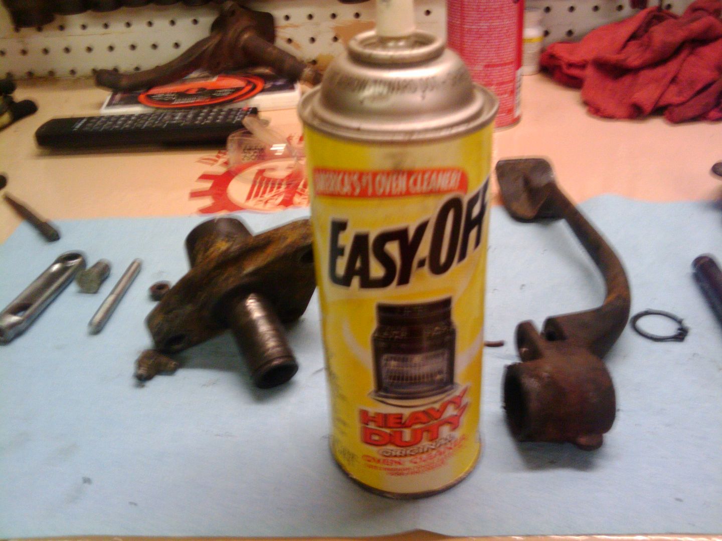

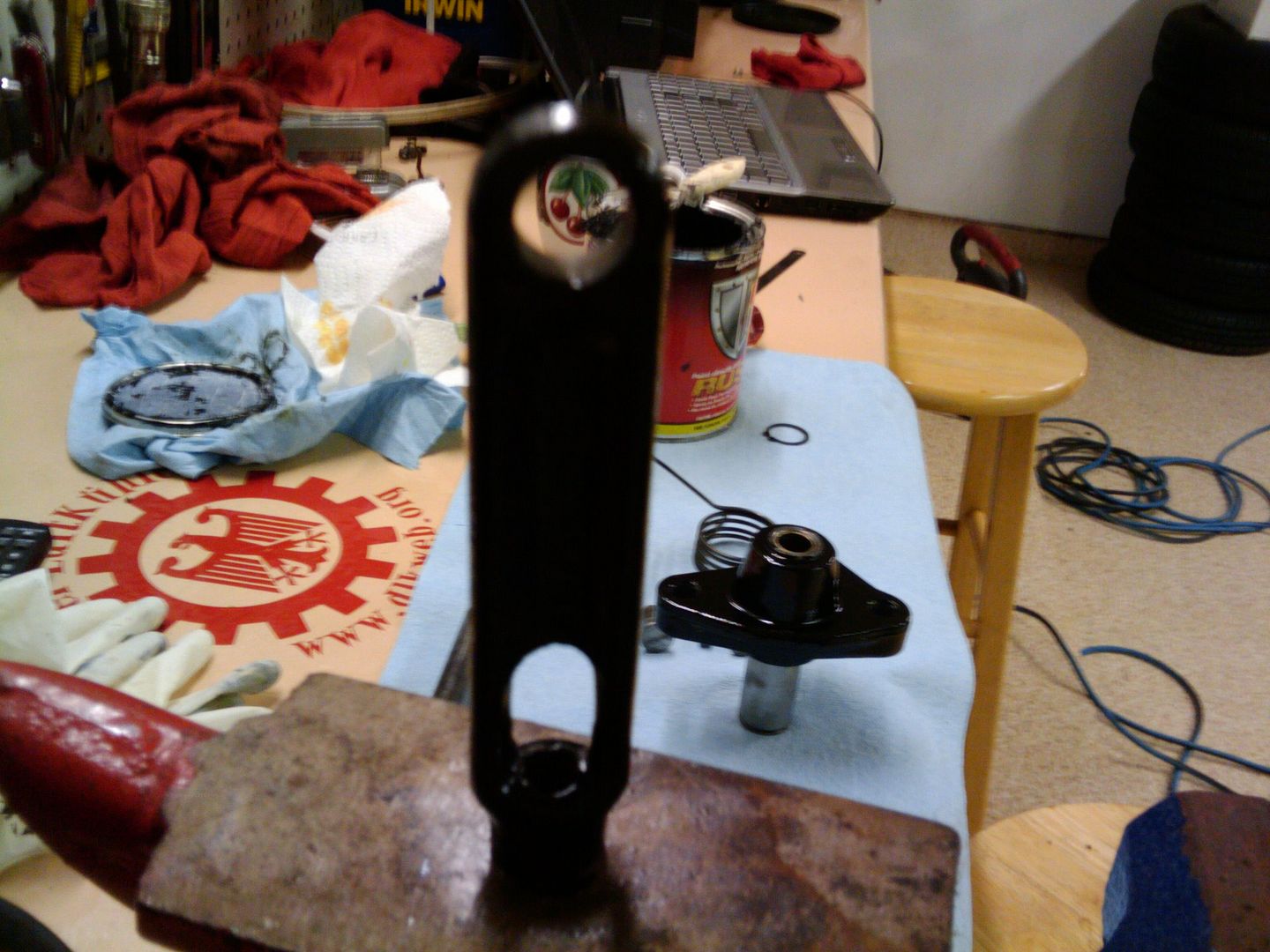

Now the clean up
In this picture you can see that I have already cleaned the plunger for the brake pedal
I just did that on my wire wheel. every thing else needs a little extra cleaning power so I pulled out the trusty
and I put everything in a coffee can and gave it a good coating

From this
To this
After seeing how the por-15 turned out on the control arms I decided to use it on the pedals as well
I have not decided what to do with the spring yet. it was pretty rusty and I would hate to put it all back together and have it rust again, and I am not sure how well the por-15 will hold up on a spring
