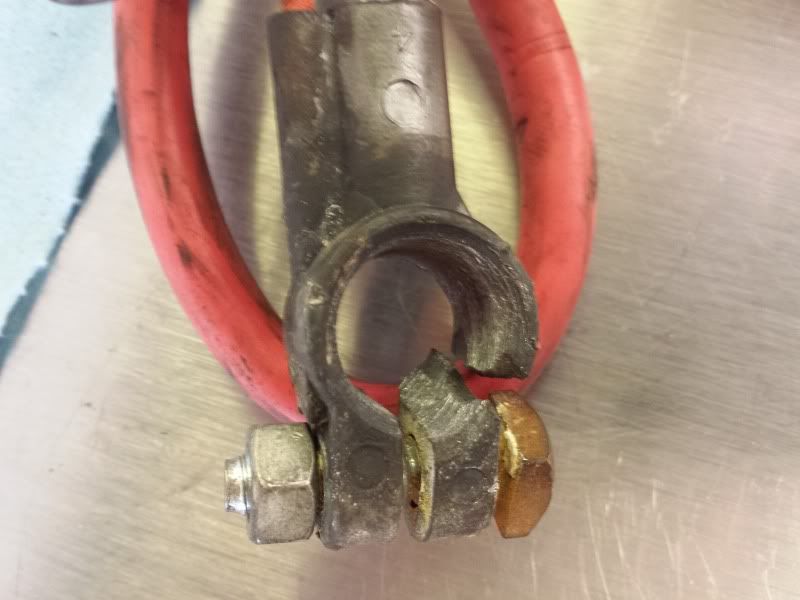

drove her around the neighborhood a little today. Running like crap on the idle circuit, I finally figured out one cylinder is not running on the idle circuit. It seems to resolve once you get on the main circuit. I checked the idle jets, they all look fine, so I guess I need to pull that carb and go through it.
I also found the terminal on the positive side of the battery was split. On top of that, the car has always been hard to start with all that compression, huge valve springs, etc, so I upgraded to an Optima red top. Its got about twice the cranking amps of my old battery, so it starts much better now. I replaced the positive cable too.
