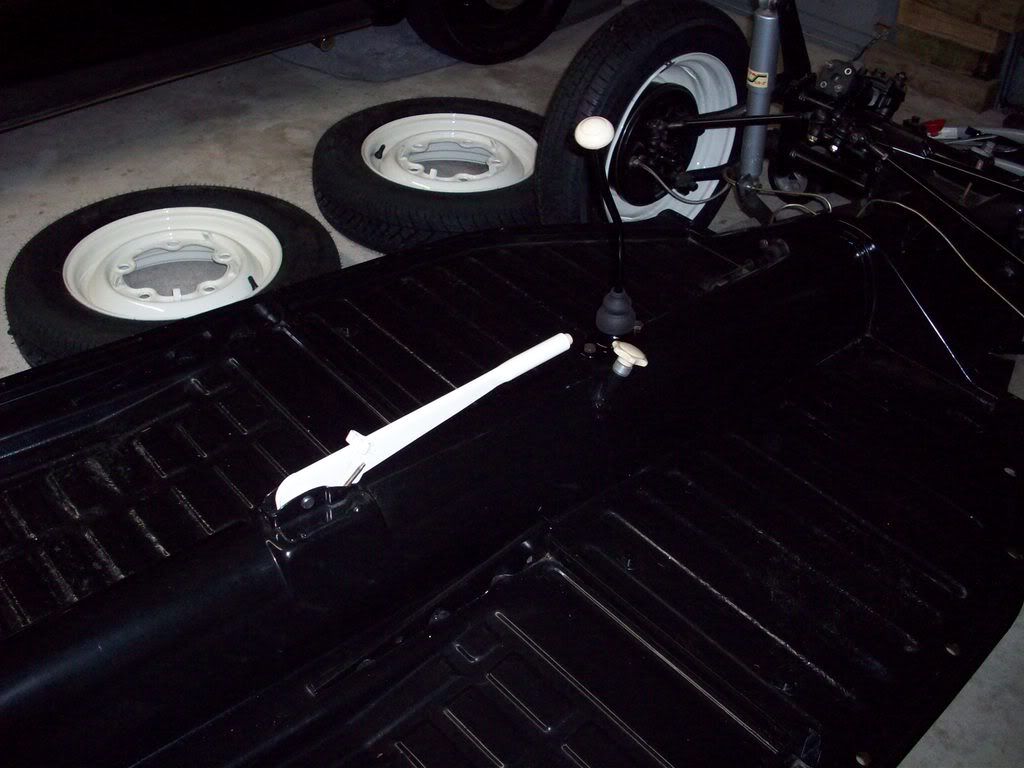

got the brake lever back today...was gonig to put it in but friends came over and after too may beers did not get a chance...will post pics of it in the car soon

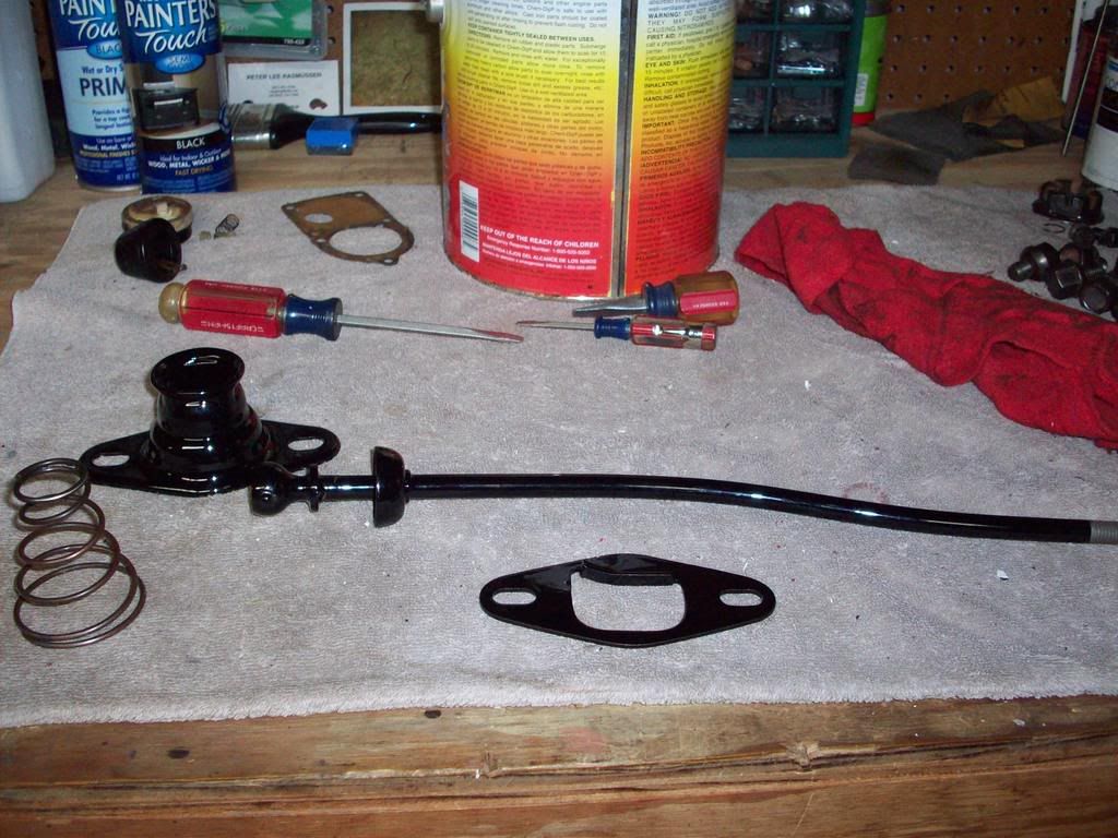

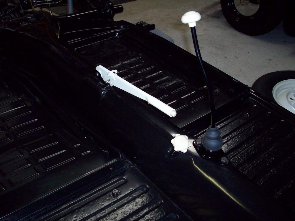

ethan came over today and he can attest there just is something screwed up...i was trying to put later shoes and cylenders to have wider brakes and i figured out a way to get it on with some fabrication but when i screwed the nuts on with the 200 plus pounds of torgue i could not spin the wheels so i think i need to go back to the mid year shoes and cylenders which ill pick up tommorrow...i called today and bap geon got them in for me...tony over there is the greatest...
other work i did after ethan left and after i spent two hours trying to get the b/s to work.. i did some easy assembly
theve all been powder coated...
