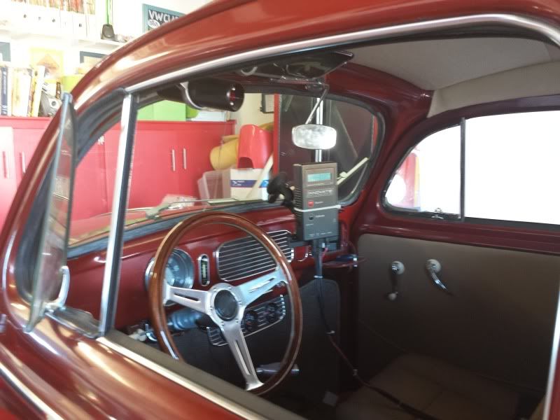

I drover her around about half an hour today. The lowspeed circuit still needs some work, but the drivability is good enough to start driving it to work. I mounted my LM1 on an old cell phone windshield mount so I can keep an eye on it when driving to help me sort the jetting out. So far it looks like its going rich in the upper part of the progression circuit, it may need a larger idle holder.
