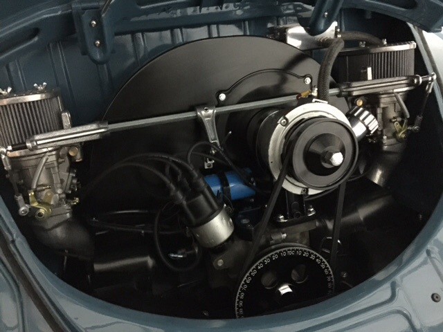

Lucky got home on time before the belt break off.. Going to change the Pulley and it won't get here until Monday cuz of stupid holiday.. :(

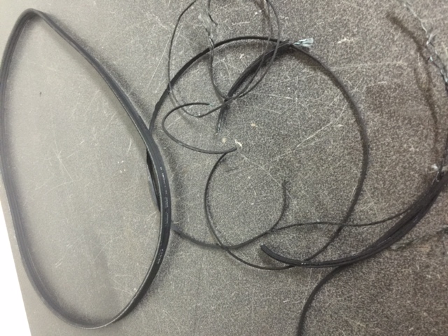

The MST pulley is going bye bye

Was it too tight?
 Post subject: Re: Ragtop 59
PostPosted: Tue Dec 30, 2014 1:19 pm
Chisel_86 wrote:
Was it too tight?
No, I can't lined it up right and it about 1/4" off. I already try everything to lined up and nothing work right.
PostPosted: Tue Dec 30, 2014 1:31 pm
I have heard that alignment is an issue with that type of system, Eliot had one on peachy that use to eat the belts.
PostPosted: Tue Dec 30, 2014 3:57 pm
Yes, alignment on serpentines is very crucial. They can't twist as much as a V-belt can.

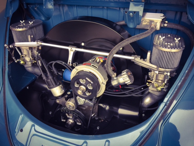

New pulley! :thumbs:
