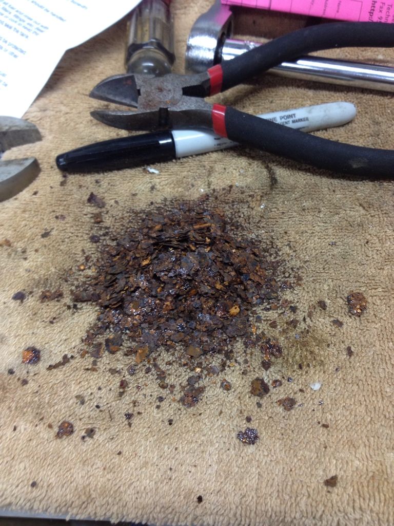

I've had trouble with rust in the fuel again so I've decided to pour 15 the tank.
Got started Tuesday
I put a filter so I could save the gas.
I poured the tank out after it dried and I was very surprised. Ethan and I just cleaned it out a few months ago.

If you would keep more than a gallon of gas in that tank it wouldn't rust as bad w:pw
PostPosted: Sun May 26, 2013 1:54 pm
x2
Follow the directions on that tank sealing kit and you will be GTG for a long time. I used it on the notch over 2 years ago and I have zero issues with rust in the tank...shitty gas that clogs my filter is another story :oops:
I would also do a muriatic acid treatment before you seal it up, the flash rust it creates helps the Metal Ready galvanize the inside of the tank.
PostPosted: Sun May 26, 2013 7:09 pm
Gas tank is finished just letting it dry now. Says 96 hours to cure. It's crazy how much they give you and how little you use.
PostPosted: Sun May 26, 2013 10:07 pm
Yeah, I think I may have used like a quarter of the can when I did mine. Remember though, our tanks are tiny compared to most cars ;)

PostPosted: Mon May 27, 2013 4:07 pm
I'd do it prior to paint. The kit will eat the paint off.
