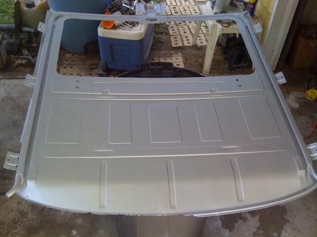

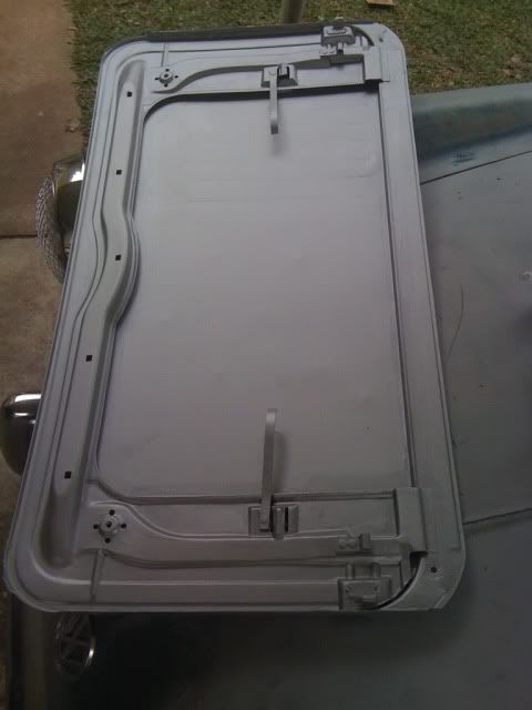

So I have been working on my sunroof clip. I should have scrapped it instead of wasting my time with it :oops:
So far I'm just on the first coat of masterseries primer.

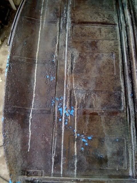

before, the blue is the tape on the backside. It's a holy sunroof :wow: lol
...and after one coat of primer

The stuff lays down a lot easier then POR. I used disposable 3" rollers and 1" sponge brushes, that combo worked good for all the wide open areas and the hard to get to places too :dance:

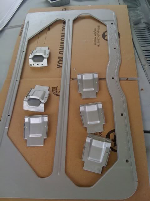

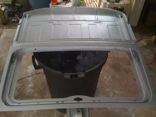

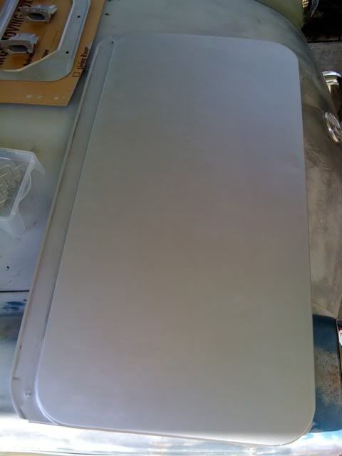

Here's some more pics for you Doug:

This may be a dumb new b question but did the primer seal the (small) holes that can be seen in the photograph with the blue tape?
PostPosted: Mon Nov 21, 2011 2:47 pm
Ya the masterseries sealed the small holes (did a great job at it), but I used JB weld on the big holes :hillbilly: . Not the recommended repair, ask Ethan about using jb weld to fill rust holes :nono: , but it's just a trip tray and the masterseries completely seals off the metal so the rust is stopped dead in it's tracks.
