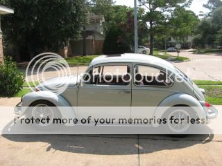

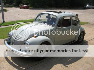

PostPosted: Sun Jun 10, 2012 9:45 am
Ok , I still need to get some smaller front tires .. but here are the before and after so far.
PostPosted: Sun Jun 10, 2012 10:49 am
Looks good man.
