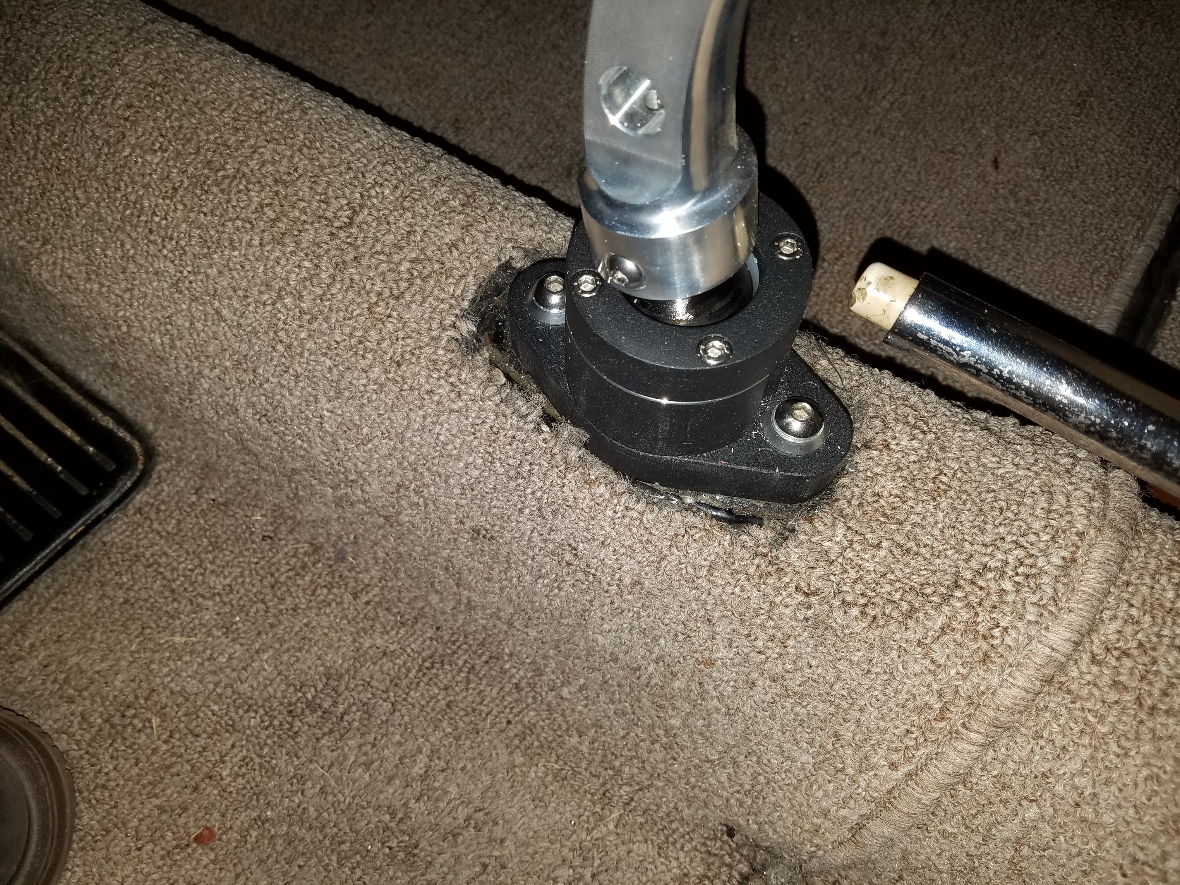

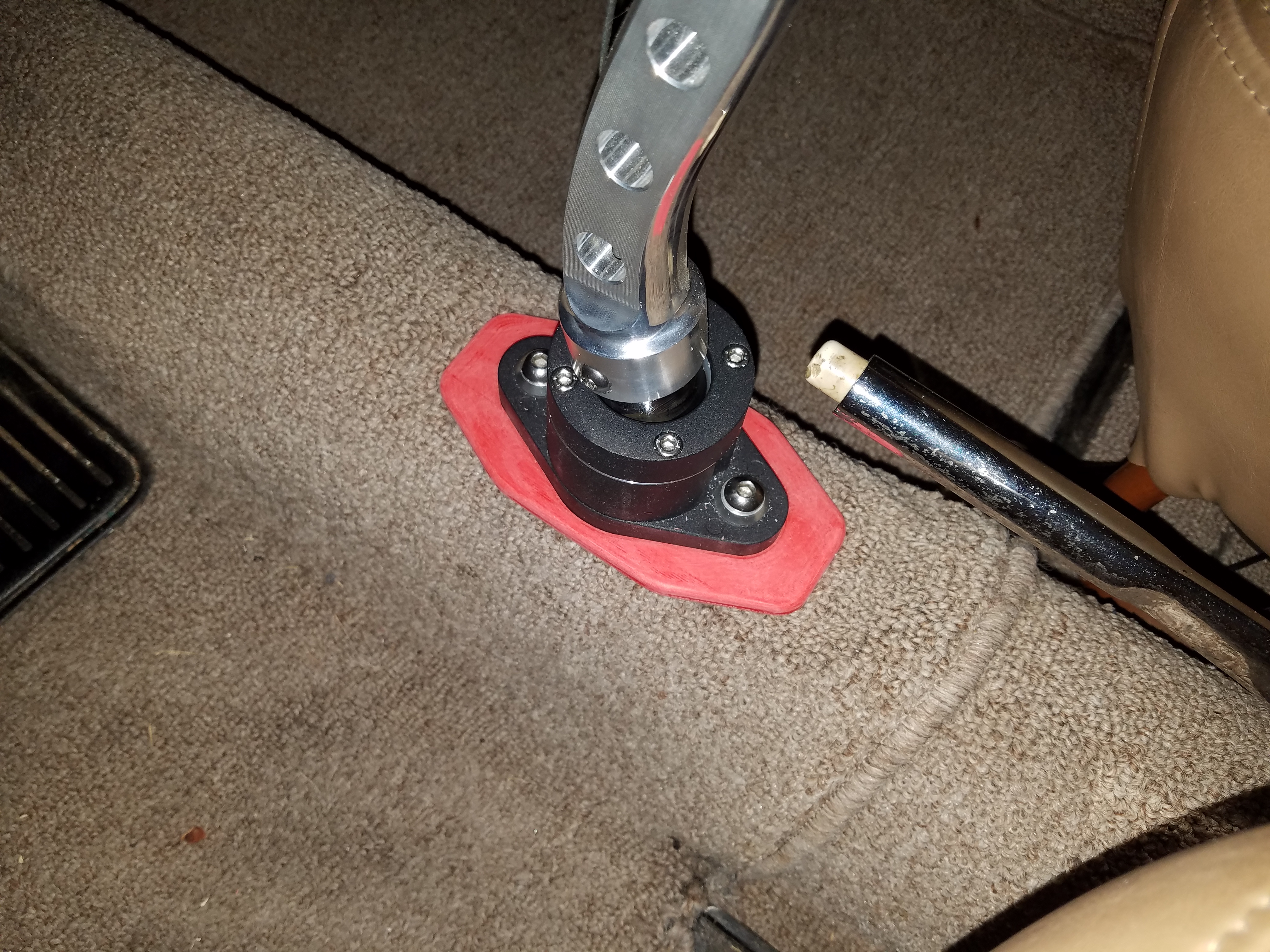

When I put on my Vintage Speed shifter, it exposed an area of carpet with ratty edges that was covered with my old shifter:

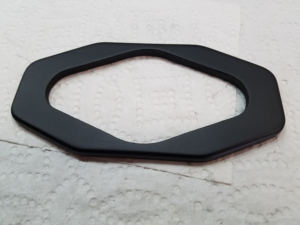

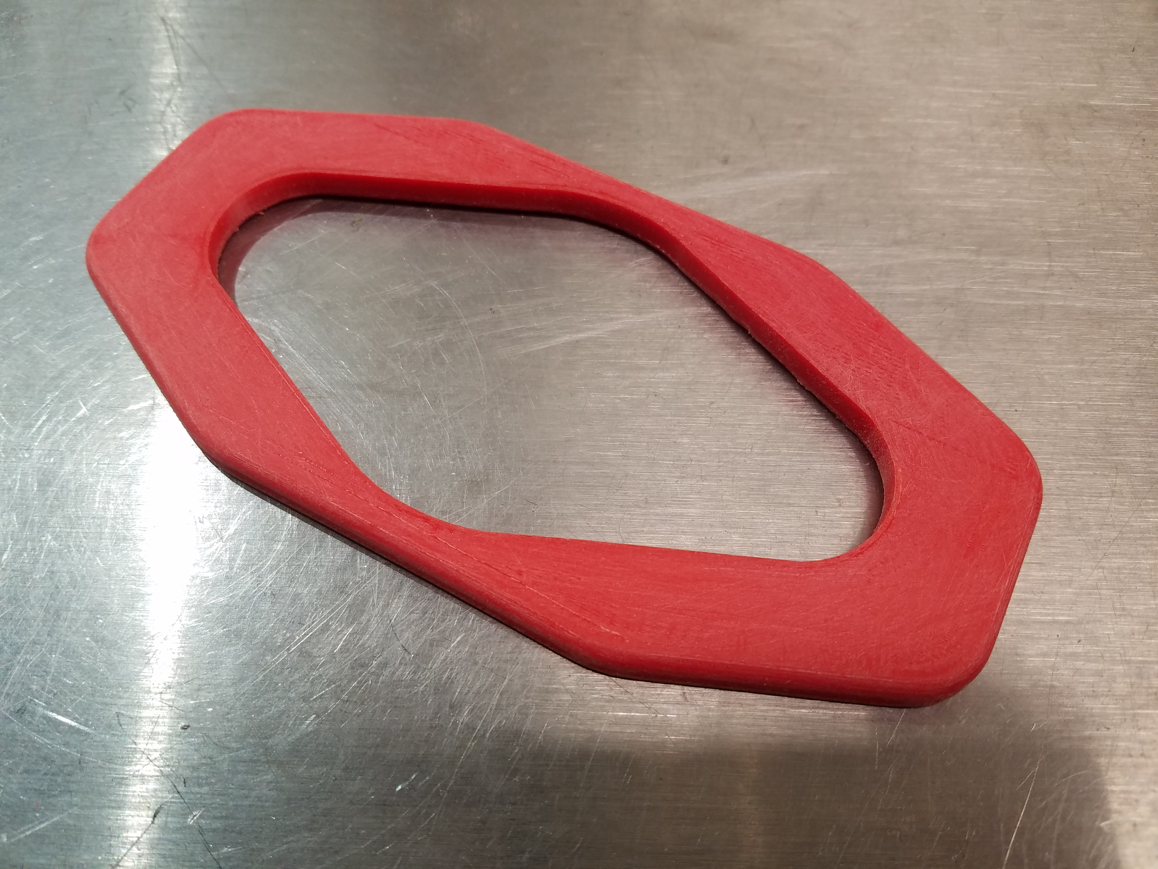

So I designed and printed this

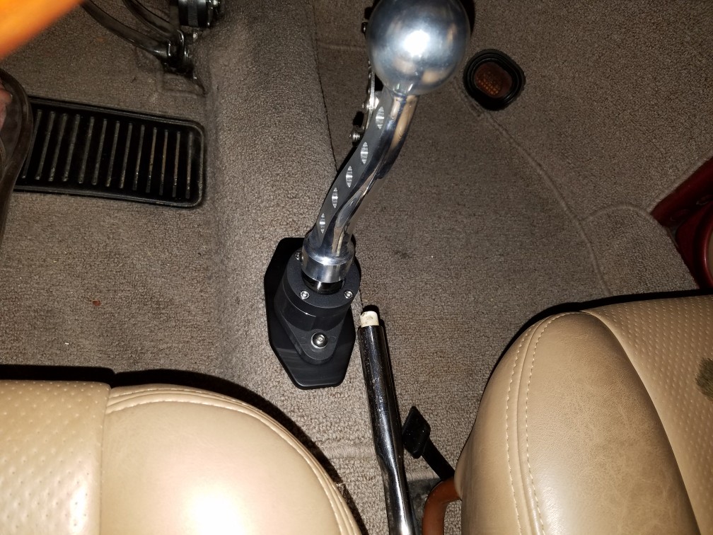

Test fitting in the car
Looks and fits good, and does what it's supposed to. I'll prime it and paint it flat black and then install it.

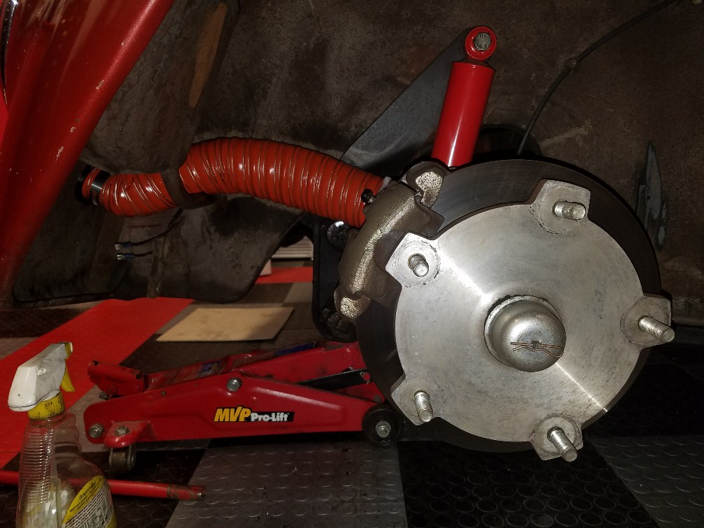

I ran the brake duct on the drivers side tonight. Took a while to figure out the routing, what with checking clearance lock to lock and all. There's not a hell of a lot of space in there, especially with 6" rims and wide tires
Anyway, I'm pretty happy with how it's coming out, and it should be functional too.

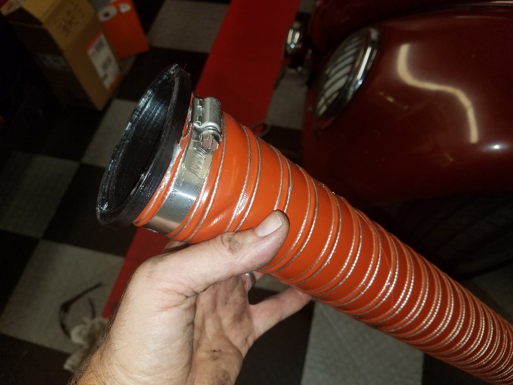

Putting the hose inlet on the flange

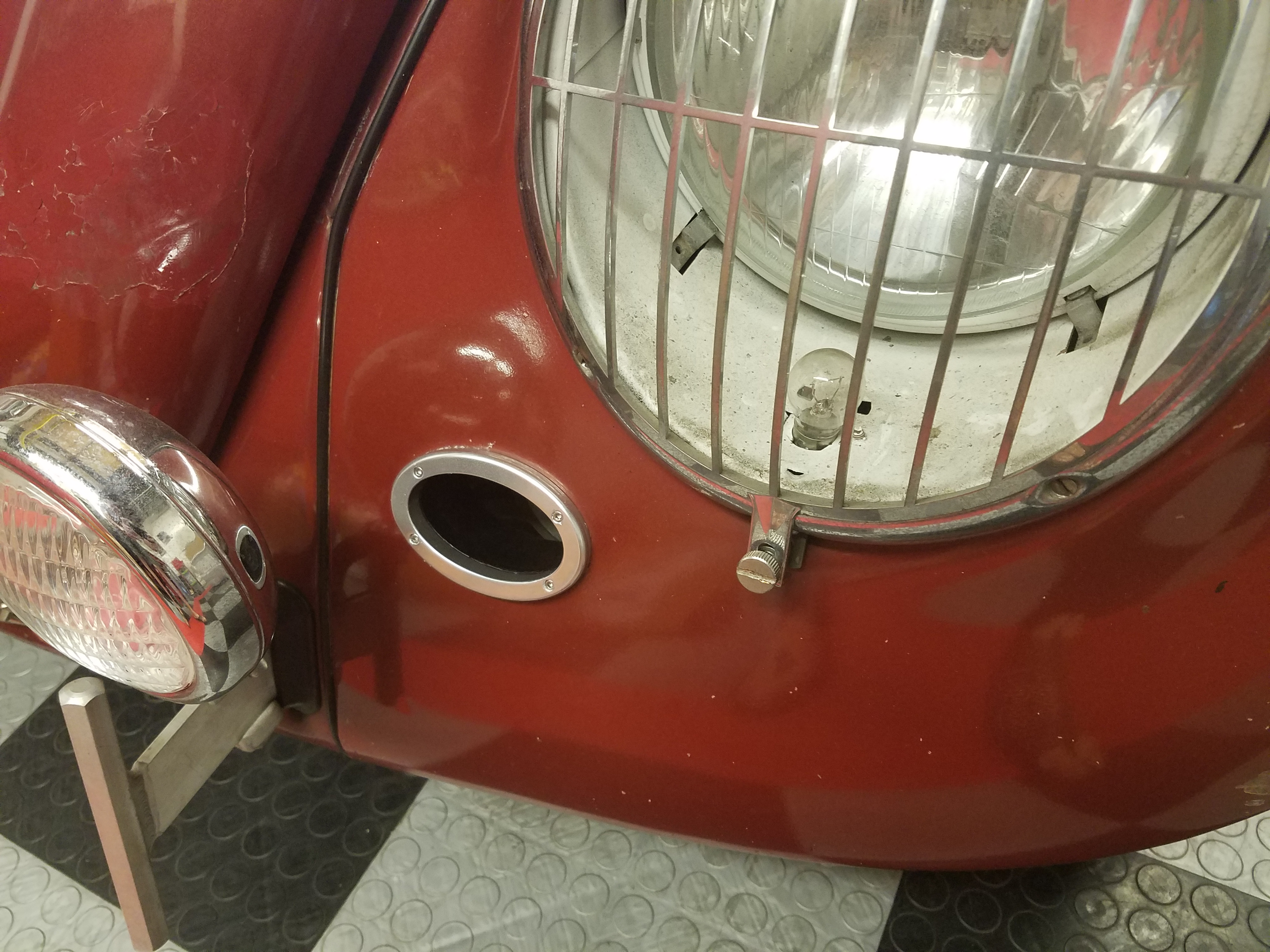

Routing under the fender

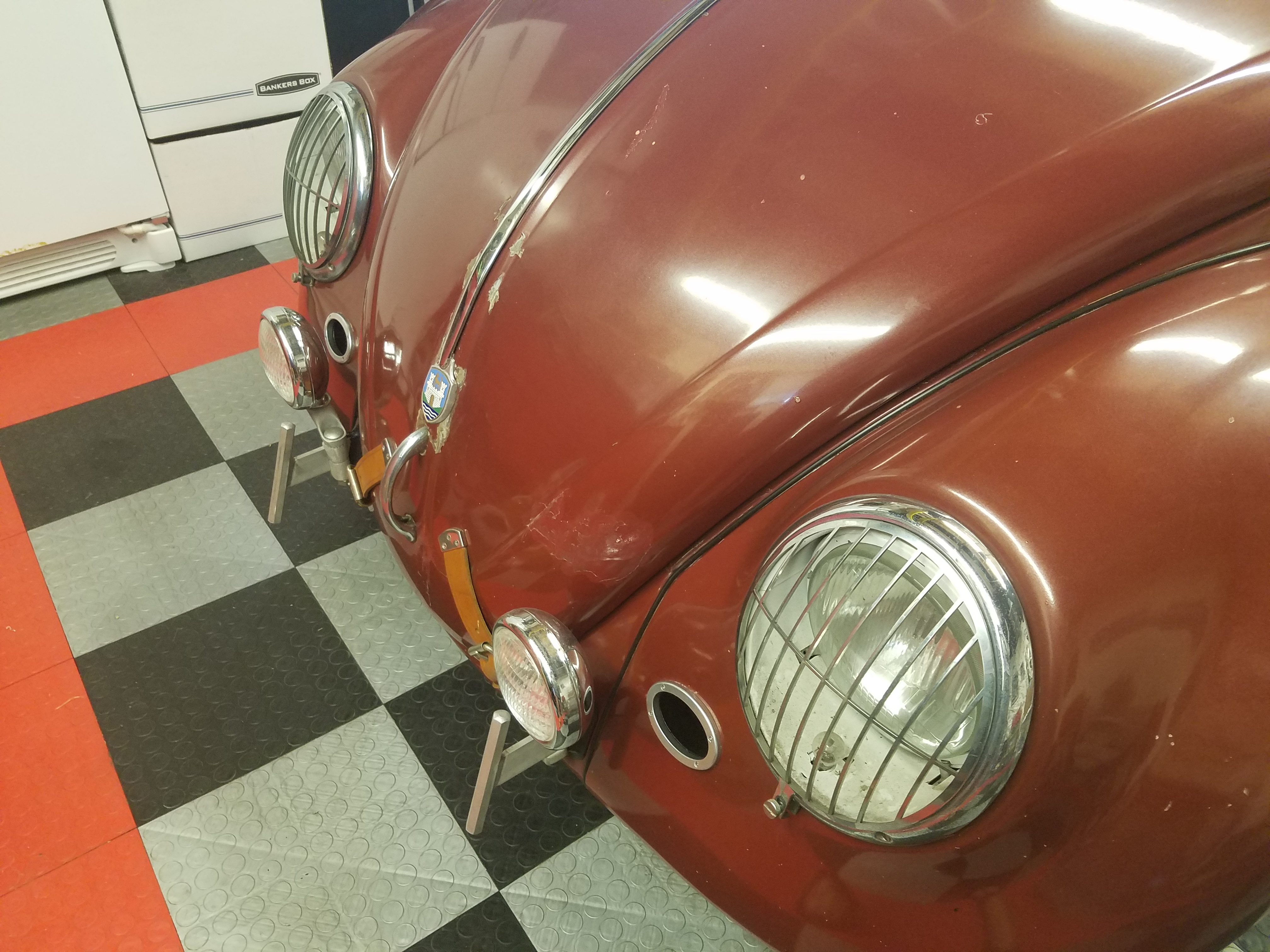

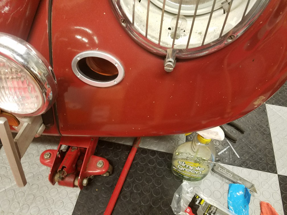

From the front of the car you can tell there's a duct hose connected

Done! I think it looks much better... much more finished.
I also ran the passenger side brake duct, went much faster than the first side.
